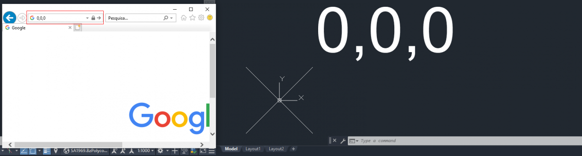

Hello everyone, it is possible to update a text in the showhtmlmodalwindow or browser
so that when the entity undergoes changes the value is updated. Something like a reactor.
Example: I insert a block, the coordinate of that block will be written to my browser. (picture 1)
If I move this block the text will be updated automatically.

Simple I would like to insert a marker in my drawing this marker will open google streetview. If I move my marker I would like the page to refresh and update to the correct location.

Roy_043
Try the code below.
Note 1:
I haven't fully tested the code. I cannot run utmgeo.VLX as I use BricsCAD instead of AutoCAD. Also I would probably need a sample dwg with the highlighter block inserted in a 'feasible' location. If you have the source of the VLX and such a dwg please post them.
Note 2:
The highlighter block has to already be inserted before calling the SvUpdate command.
