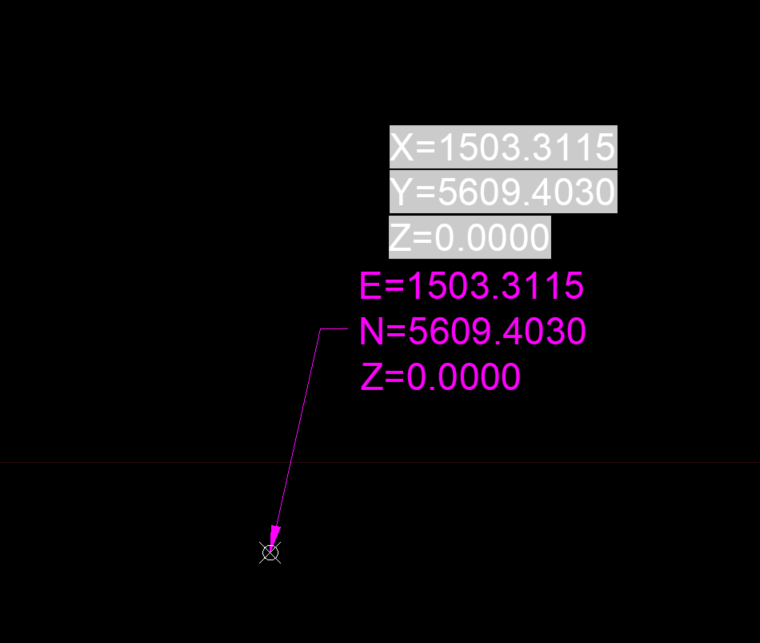

3 hours ago, Ish said:
 wonderful Sir,
now working perfectly.
Request To You just add code for layer,  create Layer Automatic And All value must come in Layer
layer Name "Coor Text"
Thanks a Lot.
Updated code in my last post.

thanks a lot all member who support
, now it fine,
finally complete enz lisp.

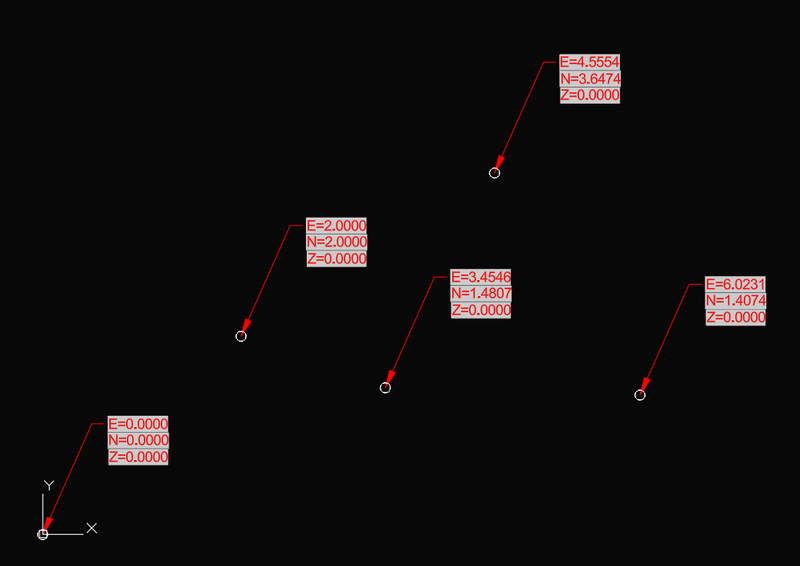

On 7/5/2019 at 5:30 AM, BIGAL said:
Please mention command keyword
; pick a point and make a leader
; by Alan H July 2019
(defun C:cxy ( / pt1 pt2 ans txtx txty txtz oldlay)
(command "-layer" "m" "Co-ordinates" "c" 1 "Co-ordinates" "")
(setq oldlay (getvar 'clayer))
(setvar 'clayer "Co-ordinates")
(if (not AH:Butts)(load "Multi Radio buttons.lsp"))
(if (= but nil)(setq but 1))
(setq ans (ah:butts but "V"  '("Please choose" "E-N" "E-N-Z" "Z")))
(setvar "cmdecho" 0)
(while (setq pt1 (getpoint "\nPick point for co-ordinate: "))
(setq pt2 (getpoint pt1 "\nPick point for text: "))
(if pt2
(setq txtx (strcat "E= " (rtos (car pt1) 2 3) ))
(setq txty (strcat "N= " (rtos (cadr pt1) 2 3) ))
(setq txtz (strcat "Z= " (rtos (caddr pt1) 2 3) ))
(princ "\n")
(cond
((= ans "E-N")(command "leader" pt1 pt2 "Annotation" txtx txty ""))
((= ans "E-N-Z")(command "leader" pt1 pt2 "Annotation" txtx txty txtz ""))
((= ans "Z")(command "leader" pt1 pt2 "Annotation" txtz ""))
(setvar 'clayer oldlay)
(c:cxy)
