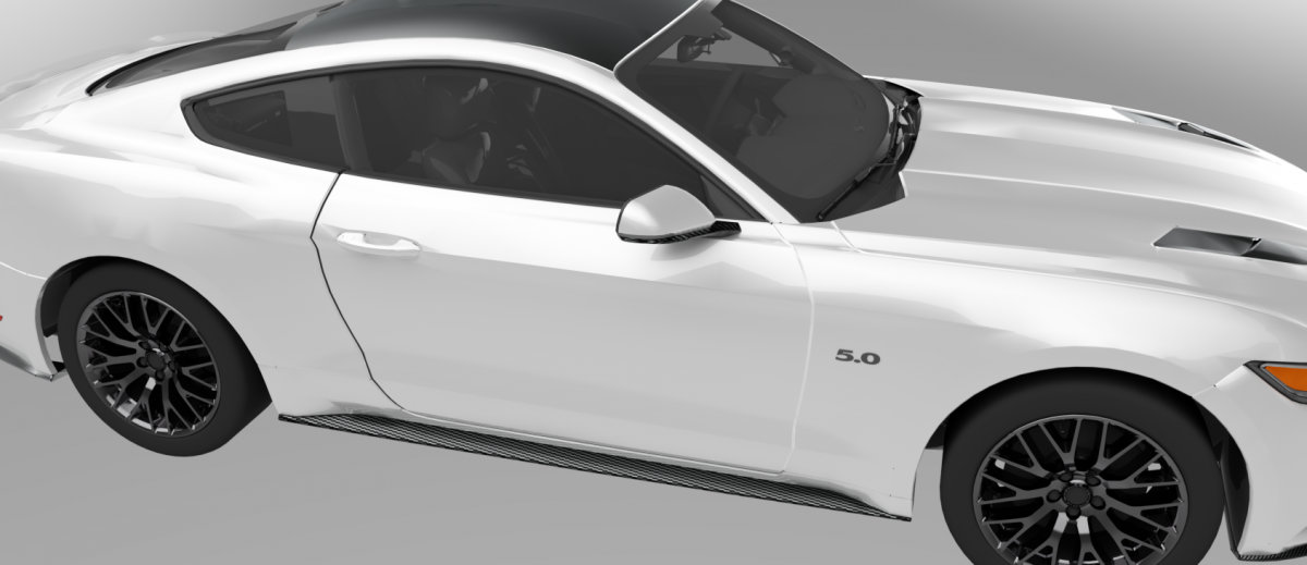

LOL, yeah I got the part about using dwg files 🤨 but you never said that you were using materials or textures in AutoCAD. I'd just try to use a glass material from SimLab and replace the one from AutoCAD. You'll probably need to download the extended material database for SimLab as well as the AutoCAD integration plugin if you haven't already.
It seems to do OK. A few artifacts here and there but I only let it run for 5 minutes. The glass looks ok to me ;)

Zox
Really, you got translucent glass? When I import dwg to SimLab and go to "Show Scene Materials" for every material in "Material Type" it is set to "Default" and then I have to change it to glass, metal...

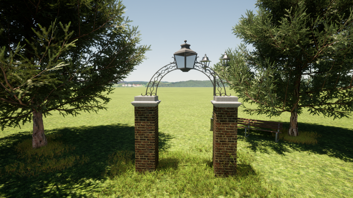

f700es
Yes, Twinmotion is very nice ;)
This took less than 5 minutes to set up and render. The arch was modeled and textured in SketchUp Pro.
