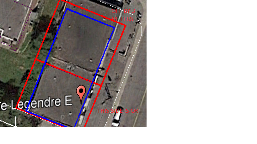

NoroZorro Posted September 20, 2019 Share Posted September 20, 2019 (edited) Hello forum! I got promoted now i'm with autocad 3d map 2020! I've asked already asked duplicate question on vanilla autocad. I read the reply, tried and it didn't help The problem is that my map is slightly off my georeferenced dwg. I've incorporated two dwg both are in nad 87 csrs mtm8 coordinates. When i assign coordinates nad 87 csrs mtm8 through a MAPCSASSIGN command, map and dwg doesn't match exactly.(see PIC attached) When i assign world mercator coordinatesto my dwg map is completely off and i'm in center of atlantic ocean. Merci beaucoup Edited September 20, 2019 by NoroZorro Quote Link to comment Share on other sites More sharing options...
rkmcswain Posted September 20, 2019 Share Posted September 20, 2019 Looks like perhaps your vector geometry is on surface coordinates and the imagery is on grid coordinates. A common issue. Quote Link to comment Share on other sites More sharing options...

eldon Posted September 21, 2019 Share Posted September 21, 2019 I would say that your map, which is aerial photography, is the one not exact. The image is not fully rectified. For example, do you want to match the top of the building (the roof) or the bottom of the building, where it goes into the ground? these points should have the same coordinates, but you can see the separation. I would always nudge the map to give a 'best fit' to your coordinated points. Quote Link to comment Share on other sites More sharing options...
NoroZorro Posted September 21, 2019 Author Share Posted September 21, 2019 Thank you for response If I match the roof buildings with map, it's fine When you say "nudge the map" how can I achieve it? If i Nudge the map, will latitude and longitude of my interest will be precise on map? Quote Link to comment Share on other sites More sharing options...

eldon Posted September 21, 2019 Share Posted September 21, 2019 To try and explain the apparent discrepancy between map and drawing, one should go and find out the process of creating the map. The aerial images are taken individually from a great height. But the images are not orthographic and there is distortion increasing from the centre of the image. The map is made up from many images, which are put together and the surpluses discarded. So the distortion is not constant throughout the mapping. I expect the positional accuracy at maximum distortion is a closely guarded commercial secret, but it would not surprise me if it were to be plus or minus several metres. So even if you could match one part of the mapping, then 500 meters away, the mapping would not match. There is nothing you can do except accept the imperfect world we live in. When I said 'nudge', I did not realise there was a command to do this, but I was thinking a moving the map a little bit. If you cannot select the map, there is nothing I can advise you to do. I would take a screen grab of the mapping so that you can manipulate it. Someone else may know different. 1 Quote Link to comment Share on other sites More sharing options...

SLW210 Posted September 23, 2019 Share Posted September 23, 2019 I was going to say exactly what Eldon mentioned. Those are not "flat" images as the world (believe it or not) is not flat. If you take a bunch of zoomed in screen grabs from Google, you will (at least I never could) get them to match as one large map, much less get a bunch of CAD line work to lineup. Not to sound rude, but, you need to study on how "accurate" (there will always be a distortion) flat maps and aerials are made. http://historymatters.gmu.edu/mse/maps/question2.html I have an extremely difficult job explaining these difficulties with aerials to my bosses at work. Some programs out there help with this, but, I have none to specifically recommend, maybe PlexEarth. Though if you need to be as accurate as possible, you should look into purchasing an appropriate aerial and not use Google Maps for this. I line everything up by the base of the buildings, that would be the closest to ground level. 1 Quote Link to comment Share on other sites More sharing options...

SLW210 Posted September 24, 2019 Share Posted September 24, 2019 Pretty much just like you show in your image, like eldon already mentioned, you just have to move the image to best align to your line work. You probably have more tools in Map 3D, sounds to me like you need some training with this aspect of CAD. It just isn't as complicated as you want to make it, there is just no way to have dead accurate aerials like you want AFAIK. You just have to use best fit and/or take actual field measurements to verify. The Earth is not flat, you just have to work with that aspect of things. Quote Link to comment Share on other sites More sharing options...

NoroZorro Posted September 28, 2019 Author Share Posted September 28, 2019 Hello 1.Image has different coordinates sytem 2.Image is off by 3 meters The part, that the earth is round I got. How do you reduce the error of 3 meters? Quote Link to comment Share on other sites More sharing options...
eldon Posted September 29, 2019 Share Posted September 29, 2019 11 hours ago, NoroZorro said: ......2.Image is off by 3 meters How do you reduce the error of 3 meters? By moving the image. When you consider that you have a drawing with lines to a known coordinate system, and you are overlaying an image, whose provenance is unknown and whose pixels only have a coordinate because someone matched a pixel or three with a known land mark at some place, you can only rely on the pictorial nature of the image. With today's technology that is available to the public, one cannot hope to have a pixel perfect map image. When an aerial image is taken, one knows the position of the camera lens, (after adjustment for perturbations in the GPS satellite). One cannot know the position of the image pixels, unless one is using LIDAR, and then one has a point cloud instead of an image. If you take a picture of a mountain in the distance, your camera can take its own position from GPS, but cannot take the position of the mountain. Finally, just to muddy the waters, the Prime Meridian at Greenwich is where all Longitude is meant to be measured from. Using Google Earth, this point is visible on the ground, but the point at zero longitude (GPS) is 103 metres from this point. I recommend further investigation into coordinate systems and map projections and photogrammetric mapping. Quote Link to comment Share on other sites More sharing options...
