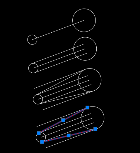

23 hours ago, BIGAL said:
Another bit simpler in the maths pick 2 circles use offsets to work out approx. tan points then as before code as above. Now need time to try it.
@BIGAL  beware - offset method not always tangent, try if circle2 radius greater 5x than circle1, the line may intersects with bigger circle.
should check secant.

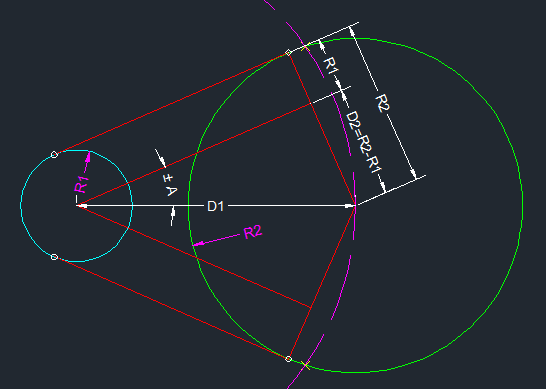

33 minutes ago, marko_ribar said:
Shouldn't a2 be, just : (setq a2 (atan d2 d1)); and (setq d2 (abs (- r1 r2)))
I just checked your code and it seems that you are right, although I don't quite know how you derived that formula and for what is worth it works as tangents and not what I initially thought as like shown on pictures...
I got it... I wrongly visualized pitagoras triangle... Distance of tangent line between 2 circles is one edge of triangle wich hipotenuse is d1... So tangent = (sqrt (- (* d1 d1) (* d2 d2)))... And angle for addition/subtraction is angle of that triangle (bigger angle and not like in my wrong formula smaller one - my bad a2=(atan d2 d1)...)
hanhphuc just using the end points as a approximate pick point for the TAN selection so in my original code 2 picks now rather than 4. Need time to redo, lots on at moment.
line tan pt1 tan pt2
A picture is worth a thousand words
D2 either R1-R2 or R2-R1 just concept to visualize
