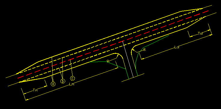

Hi to all. This is my first post and i'm new at LISP. I need help to make a LISP for AC/DC lane base on user input.
1. User will enter nos of lane
2. Width of the lane.
3. Values for Lm, Tm, Ld,Td dan R.
User need to pick the center line (red) and the existing lane (green) to get the R (radius). As you can see, LM@Ld starts at the end of the R and at the end of Lm@Ld will start the tapper ( Tm@Td).
Again, im new at LISP and the only thing i can make won my own is this this. But the width is fixed and not based on user input. Thank you for your time and replies.

For those here not civil engineers you want acceleration and deceleration lanes automated.
ok there are a few solutions where I come from the lanes have radius also rather than just a angle line.
Its  not to hard a question to answer. But there are some issues if the road is within a curve then it becomes way more complicated.
Before starting any code really need the Highway code for the task its no good doing something then changing it multiple times.
Most of the rules are speed dependant.

Thank you for your reply. Actually Lm, Tm, Ld,Td dan R are from the Highway code and design. Yes, i do know curved alligment will become too much to code, that's why i leave it aside. Most of the AC/DC in the project are not curvy so a quick editing after it was automated can save plenty of time.

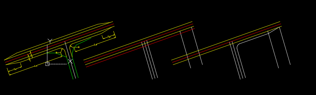

Thank you for your fast reply. Looking at your work here, you have helped many users and i'm glad you help me.
Going back to your reply on manual steps, i normally do this:
1. Offset the red line [2] accordingly to the width and nos of lane on both sides.
2. Fillet@Circle ( TTR ) to get the Rad.
3. Get the length of Lm@Ld
4. Construct the tapper [Tm@Td]
By using a dialogbox would be great idea. For a,b and c must be in their own layer and linetype and scale (refer to new picture). A.b and c must have min thickness (global width) of 0.3 and max 0.5. I'm sorry for not mentioning about layers and stuff.
Again,thank you for your time.

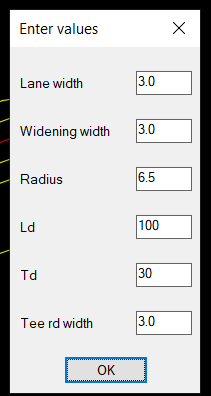

The dialogue input is in the downloads section here at cadtutor but I would suggest start with (getreal "enter distance" etc

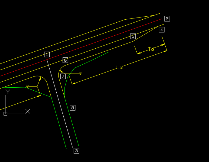

Look at my image and PT4 it is calculated from the distance  (+ ld off2 radius)
Your almost there for one side.
(setq wide (getreal "Enter the widening width"))
(setq dist1 (+ .............))
(Setq pt4 (polar pt1 ang1 dist1))
(setq pt4 (polar pt4 (- ang1 (/ pi 2.0)) (+ lanewid wide)))
(setq dist1 (- dist1 td))
(setq pt5 (polar pt1 ang1 dist1))
(setq pt5 (polar pt5 (- ang1 (/ pi 2.0)) (+ lanewid wide)))
(command "Line" pt4 pt5 "")
(setq dist1 (+ off2 rad))
(setq pt6 (polar pt1 ang1 dist1))
(setq pt6 (polar pt6 (- ang1 (/ pi 2.0)) off1))
(command "Line" pt6 pt5 "")
(setq l1 (entlast)) ; to be used later with fillet adn radius
(setq pt7 (polar pt1 ang2 .....))
(setq pt7 (polar pt7 ..............))

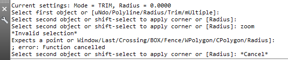

You could make the radius but its much easier to use the fillet command and let autocad do the work.
When you draw the line pt5-pt6 you do this (setq ent1 (entlast)) this remembers the new line entity.
Then draw line pt7-pt8 and again (setq ent2 (entlast))
Easy now (command "fillet" "R" rad ent1 ent2) and radius is drawn.

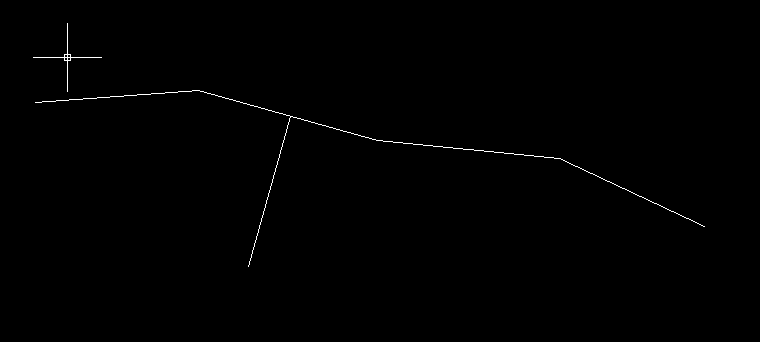

Sheep
How can i pick the points and use it to make lines?
(defun c:loop2 ()
	(setq ptlist nil)
	(while
		(setq pt (getpoint "\nEnter Point or RETURN when done: "))
		(setq ptlist (append ptlist (list pt)))
Tried using the code from AfraLISP to extract 'car' and 'cadr' from 'ptlist. Thank you.

Hi BIGAL. Tested your LISP routine and i need some clear instruction. Loaded all files ( 3 of them) and entered "SLIP-LANE".
Can you please explain these items please:
1. Pick Main road cl near new Tp (what is TP?)
2. Pick C/l's intersection point (what is C/l?)
3. Pick side away from main road edge
4. Pick side rd cl  just below offsets
What should i pick and where?
What do you mean by "Main road width" from the dialogbox? Is it the total width of the new main road excluding the new lane? Or is it the new main road plus the new lane width? I also can't give the nos of lane to be make (let say the main road is 1 lane per side and i want to add another 2 new lane next to the existing main road) and got an error ( refer image). Maybe our "civil engineering" language a little bit different. Below is the actual Malaysian Code for road design.
As per law of our company, i can't upload acad dwg without their approval. That's why i can only upload a small portion of the dwg.
AC_DC_LANE.pdf
