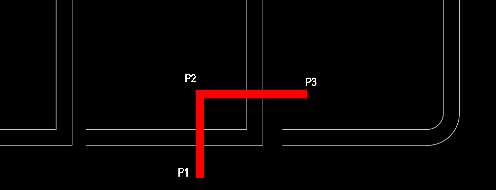

BIGAL
Unless the cmdecho annoys you leave it on, the other time to turn off is when doing lots of commands and it would be nicer if not displayed.
I would look at your fillet method if its 4 lines then I would use a ssget and fence option just drag a L over the lines and use the entities found. I have this will see if I can find its buried in a code. This method has been used on multiple fillets with a inside seed radius auto working out the width of each segment.
Found something but need to amend it. Seed radius is zero.

BIGAL
I tried to find this post a couple of days ago, the description was why I could not find, please try this. See image above for the 3 point pick. Auto works out second radius.
(defun c:RADx2 ()
  (setq pt1 (getpoint "Pick outside"))
  (setq pt2 (getpoint pt1 "Pick inside"))
  (setq pt3 (getpoint pt2 "Pick outside"))
  (setq rad (Getreal "enter Radius"))
  (setq lst (list pt1 pt2))
  (setq ss (ssget "F" lst (list (cons 0 "*line"))))
  (setq lst (list pt2 pt3))
  (setq ss2 (ssget "F" lst (list (cons 0 "*line"))))
  (setq obj (vlax-ename->vla-object (ssname ss 0)))
  (setq pt3 (vlax-curve-getclosestpointto obj pt2))
  (setq dist1 (distance pt2 pt3))
  (setq obj (vlax-ename->vla-object (ssname ss 1)))
  (setq pt4 (vlax-curve-getclosestpointto obj pt2))
  (setq dist2 (distance pt2 pt4))
  (setq distx (abs (- dist1 dist2)))
  (if (> dist1 dist2)
      (setq temp pt3)
      (setq pt3 pt4)
      (setq pt4 temp)
  (setq obj (vlax-ename->vla-object (ssname ss2 0)))
  (setq pt5 (vlax-curve-getclosestpointto obj pt2))
  (setq dist1 (distance pt2 pt5))
  (setq obj (vlax-ename->vla-object (ssname ss2 1)))
  (setq pt6 (vlax-curve-getclosestpointto obj pt2))
  (setq dist2 (distance pt2 pt6))
  (if (> dist1 dist2)
      (setq temp pt5)
      (setq pt5 pt6)
      (setq pt6 temp)
  (setvar 'filletrad rad)
  (command "fillet" pt3 pt5)
  (setq rad (+ rad distx))
  (command "fillet" pt4 pt6)
(vl-load-com)
(c:test)
Edited by BIGAL
Share this post
Link to post
Manila Wolf
Bigal,
Thanks for posting the code "RADx". I like the selection method. I hope to learn from it and if possible manipulate it, or follow some of it, to allow the user to key in wall thickness rather than inside radius. (This may take me some time 🙂).
The lisp I am trying to compile at the outset needs to accommodate the fact that the user does not know any radius values, only sheet thickness.

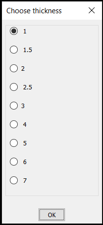

And one more thing - try to avoid (getstring) that has single input - I'd rather use more appropriate (getkword) with adequate (initget 1 "Imperial Metric") call - 1 means that empty choice (ENTER) is not allowed in following (getkword) - look for examples with (getkword) - it should be something like "\n Type appropriate units [Imperial/Metric] : " - this thingy with [ ] brackets and capital letters and separator / allows user to make decision with either keyboard or mouse click - check it and you'll see what I mean...
I can see how much better this would be than the getstring approach. I tried to apply it but get this message: - "; error: bad argument type: numberp: nil" when I run the code.

You may need to make a "How to" Document for your lisps showing how lisps work the image took a couple of minutes to make just copy and paste to word etc images. We had one it had around 75 lisps in it. plus a stack of other how do I do that docs for when you forgot "how to do that".

Very impressive your ""How to" Document". I believe I can easily create something similar. Thank you for the inspiration.
So now I am going to try and implement your fence "L" shape selection in my code.
Here is my attempt. The problem I have is that I can't make it loop. By that I mean if there is more than one bend I would like to apply the lisp to one bend then move on to the next if there is one, the right click or enter to exit the lisp. I guess I have to place a "(while" in the code somewhere.

BIGAL
Look at the while at enter thickness (setq ITEM Also if say all metric once chosen wrap it in a (if (not item2) so it skips asking again.
If you have known thickness say like 10 off them look at my Multi radio buttons.lsp this will let you use a dcl for size or use a library LISTBOX dcl there out there as well pick from a list.
(setq ans (atof  (ah:butts but "V"   '("Choose thickness " "  1" "  1.5" " 2" "  2.5" " 3" "  4" "  5" "  6" "  7"))))

BIGAL
ronjonp I did refer to using a listbox as it displays all options. The one I use was thanks to Alanjt. There are many ways to choose as you suggest.
(setq lst (list "1.0" "1.5" "2.0" "2.5" "3.0" "4.0" "5.0"))
(if (not AT:ListSelect)(Load "listselect"))
(setq thick (atof (nth 0 (AT:ListSelect "Please choose " "Thickness"   10 10   "false" lst ))))
The multi radio buton saves 1 mouse click as when you pick a button the dcl closes it also saves the last answer as the default button for next use so can just pick OK.
The Multi radio buttons has a spacer in it to actually make the dcl longer it has a setting of <12 you could remove the (if  or add a lower number. Images from Briscad slightly different in Autocad a bit larger.

This looks like it may be very useful.  I will try and understand that later.
Also the radio buttons look very good. Again I will look later and try to implement.
Thanks for your help and suggestions.

(if (not AH:Butts)(load "Multi Radio buttons.lsp"))
(if (not but)(setq but 1))
(while  (setq pt1 (getpoint " Pick outside, Enter to exit "))
  (setq pt2 (getpoint pt1 " Pick inside, "))
  (setq pt3 (getpoint pt2 " Pick outside, "))
(setq item (atof (ah:butts but "V"   '("Choose thickness " "  1" "  1.5" " 2" "  2.5" " 3" "  4" "  5" "  6" ))))
(if (not item2)
(setq item2 (ah:butts 1 "V"   '("Choose Inch mm " "INCH" "MM" )))
  (cond
  ((and (= 1 ITEM)(= item2 "MM"))(setq IRD 0.5 IRO 1.5))
  ((and (= 1.5 ITEM)(= item2 "MM"))(setq IRD 1.2 IRO 2.7))
  (if (> dist1 dist2)
      (setq temp pt3)
      (setq pt3 pt4)
      (setq pt4 temp)
  (if (> dist1 dist2)
      (setq temp pt5)
      (setq pt5 pt6)
      (setq pt6 temp)
  (setvar 'filletrad IRD)
  (setvar 'filletrad IRO)
  ) ; while
