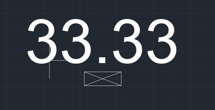

I need a lisp to make a point with z value read from text:
  1. pick the text (33.33)
  2. convert this in millimetres 33330
  3. snap to the centre of the cross (this could be manual)
  4. make a point with 33.33 (in mm) as zvalue.
Two
I need a similar lisp that:
  2. convert in millimetres 33330
  3. move only in z value by 33330 all the objects selected (33.33 text + rectangle + everything selected)
Many thanks

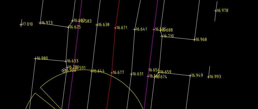

Quick answer having done this numerous times, if the insertion point of the text is at the X point then use the lisp attached.
If all the text is the same offset from the X point move all the text this amount so its now all on the X, run the lisp. You can move it back if you want.
To move the X or a block to Z its more complicated and needs a custom routine as it must use the text and then look for the corresponding X and other objects. The same applies if the text is random around the desirable point.
