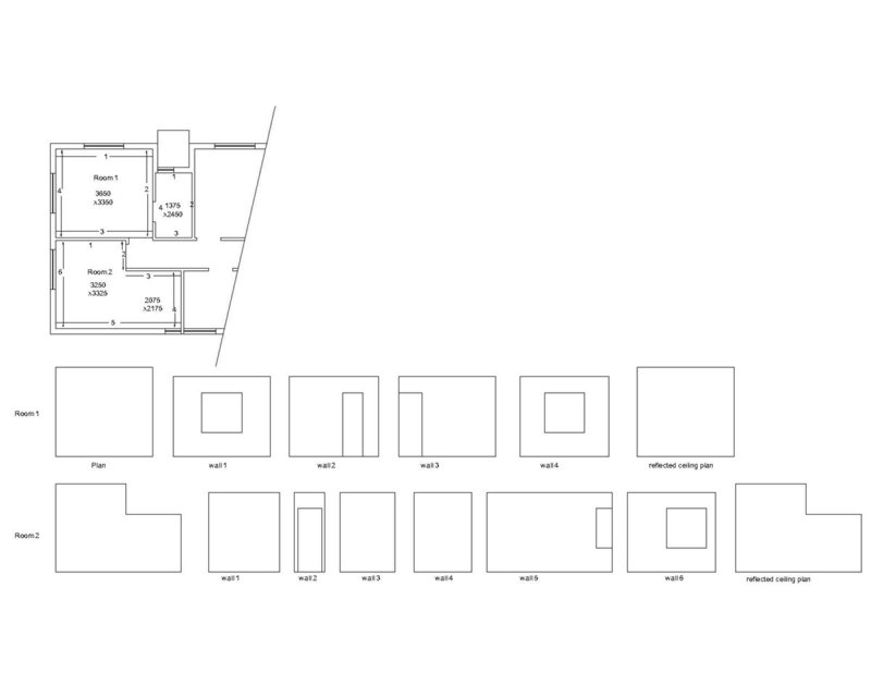

Hsanon Posted February 8, 2020 Share Posted February 8, 2020 Hi, Was wondering if there is a routene available where a 2D room is traced out from a floor plan, and (at another point) we have (in a sequence ) the room floor plan replicated, and the wall elevations and the room reflected ceiling plan placed side by side (once we input the floor height). All in 2D Could we also point out openings in the original floor plan (like windows and door openings with dimension inputs) which could be cut out in the respective wall elevations drawn ? This would really facilitate the drawing of elec points / service points at different heights in the room Quote Link to comment Share on other sites More sharing options...

asos2000 Posted February 9, 2020 Share Posted February 9, 2020 I think the OP want - Run the routine - The routine asks for floor plan corners - The routine asks for room height - The routine draws the plan, reflected plan, each wall in separate. Is not it? Quote Link to comment Share on other sites More sharing options...
marko_ribar Posted February 9, 2020 Share Posted February 9, 2020 (edited) Based on @asos2000 comment, try this minimally tested : (defun c:room-unfold ( / osm p1 p2 wall ans done openings doors windows walls doorh windp windh roomh p room ll ur v dx d ) (setq osm (getvar 'osmode)) (setvar 'osmode 33) (while (not done) (setq p1 (getpoint "\nPick or specify first wall corner <ENTER - NO WALLS> : ")) (if (null p1) (setq done t) (progn (initget 1) (setq p2 (getpoint p1 "\nPick or specify second wall corner : ")) (setq wall (cons (list p1 p2) wall)) (while (not openings) (initget "Yes No") (setq ans (getkword "\nWall has openings [Yes/No] <Yes> : ")) (if (null ans) (setq ans "Yes") ) (if (= ans "Yes") (progn (while (not doors) (setq p1 (getpoint "\nPick or specify first door anchor point <ENTER - NO DOORS> : ")) (if (null p1) (setq doors t) (progn (initget 1) (setq p2 (getpoint p1 "\nPick or specify second door anchor point : ")) (setq wall (append wall (list (list "D" p1 p2)))) ) ) ) (while (not windows) (setq p1 (getpoint "\nPick or specify first window anchor point <ENTER - NO WINDOWS> : ")) (if (null p1) (setq windows t) (progn (initget 1) (setq p2 (getpoint p1 "\nPick or specify second window anchor point : ")) (setq wall (append wall (list (list "W" p1 p2)))) ) ) ) (setq openings t doors nil windows nil) ) (setq openings t) ) ) (setq walls (cons wall walls) openings nil wall nil) ) ) ) (initget 7) (setq doorh (getdist "\nPick or specify doors height : ")) (initget 7) (setq windp (getdist "\nPick or specify windows parapet : ")) (initget 7) (setq windh (getdist "\nPick or specify windows height : ")) (setq roomh 0.0) (while (<= roomh (apply 'max (list doorh (+ windp windh)))) (initget 7) (setq roomh (getdist "\nPick or specify room height : ")) ) (initget 1) (setq p (getpoint "\nPick or specify insertion point : ")) (setq room (mapcar 'car walls)) (setq ll (list (apply 'min (mapcar 'car (apply 'append room))) (apply 'min (mapcar 'cadr (apply 'append room))))) (setq ur (list (apply 'max (mapcar 'car (apply 'append room))) (apply 'max (mapcar 'cadr (apply 'append room))))) (setq v (mapcar '- p ll)) (vl-cmdf "_.PLINE") (foreach pp (mapcar 'car room) (vl-cmdf "_non" (mapcar '+ pp v)) ) (vl-cmdf "_C") (setq dx (/ (- (car ur) (car ll)) 10.0)) (setq p (mapcar '+ v (list (+ (car ur) dx) (cadr ll)))) (foreach wall (reverse walls) (setq d (apply 'distance (car wall))) (vl-cmdf "_.RECTANGLE" "_non" p "_non" (mapcar '+ p (list d roomh))) (foreach opening (cdr wall) (if (= (car opening) "D") (vl-cmdf "_.RECTANGLE" "_non" (mapcar '+ p (list (distance (caar wall) (cadr opening)) 0.0)) "_non" (mapcar '+ p (list (distance (caar wall) (caddr opening)) doorh))) (vl-cmdf "_.RECTANGLE" "_non" (mapcar '+ p (list (distance (caar wall) (cadr opening)) windp)) "_non" (mapcar '+ p (list (distance (caar wall) (caddr opening)) (+ windp windh)))) ) ) (setq p (mapcar '+ p (list (+ d dx) 0.0))) ) (setq v (mapcar '- p ll)) (vl-cmdf "_.PLINE") (foreach pp (mapcar 'car room) (vl-cmdf "_non" (mapcar '+ pp v)) ) (vl-cmdf "_C") (setvar 'osmode osm) (princ) ) HTH., M.R. Edited February 10, 2020 by marko_ribar 1 Quote Link to comment Share on other sites More sharing options...

Hsanon Posted February 10, 2020 Author Share Posted February 10, 2020 Apologies for not responding. ..... Thanks for your efforts, I will only be able to try out marko ribar's program tomorrow. Just a first look at the code, is it possible to draw out the entire room walls in one pline, and then mark out the openings ???? Instead of going wall to wall.... Which would take more time... ??? Or would that be difficult to relate in the code ??? it would just be quicker..... Bigal, did you mean that no additional software / program would be required for adding thickness to the walls ???? But I feel you would still need to create many sectional views to get the output as is desired (in the sample attached by me) thanks Quote Link to comment Share on other sites More sharing options...
marko_ribar Posted February 10, 2020 Share Posted February 10, 2020 (edited) I don't know how would you accomplish to mark openings without going wall to wall... Beside that openings may differ with dimensions, so I decided to mod. my code... I think this is more suitable, and yes I waited to see if someone will respond with better approach, but it seems that it would be difficult to do it automatically in few steps without wall to wall... If you find some alternative way to do it, we'll all be grateful to you if you show us how... You could go in 3D as BIGAL showed, but still it is difficult for me to imagine how would you automate it and then again firstly you'd have to model it in 3D... I haven't tried other software, but this is BIM task, don't know maybe BricsCAD or Revit could do it, but I don't know... So long from me, bye... (defun c:room-unfold ( / osm pt1 pt2 p1 p2 wall ans done openings ch walls doorh windp windh roomh p room ll ur v dx d ptl k ) (setq osm (getvar 'osmode)) (setvar 'osmode 33) (while (not done) (if (null pt1) (progn (initget 1) (setq pt1 (getpoint "\nPick or specify first wall corner : ")) ) ) (initget 1) (setq pt2 (getpoint pt1 "\nPick or specify second wall corner : ")) (while (equal pt1 pt2 1e-6) (initget 1) (setq pt2 (getpoint pt1 "\nPick or specify second wall corner : ")) ) (if (equal pt2 (caar (last walls)) 1e-6) (setq done t) ) (setq wall (cons (list pt1 pt2) wall)) (initget "Yes No") (setq ans (getkword "\nWall has openings [Yes/No] <Yes> : ")) (if (null ans) (setq ans "Yes") ) (if (= ans "Yes") (progn (setq openings nil) (while (not openings) (while (and (setq p1 (getpoint "\nPick or specify first opening anchor point <ENTER - NO MORE OPENINGS> : ")) (not (equal (distance pt1 pt2) (+ (distance pt1 p1) (distance p1 pt2)) 1e-6)))) (if (null p1) (setq openings t) (progn (initget 1) (setq p2 (getpoint p1 "\nPick or specify second opening anchor point : ")) (while (not (equal (distance pt1 pt2) (+ (distance pt1 p2) (distance p2 pt2)) 1e-6)) (initget 1) (setq p2 (getpoint p1 "\nPick or specify second opening anchor point : ")) ) (initget "D W") (setq ch (getkword "\nDoor or Window [D/W] <D> : ")) (if (null ch) (setq ch "D") ) (if (= ch "D") (progn (if doorh (progn (initget 6) (setq doorh (cond ((getdist (strcat "\nPick or specify door height <" (rtos doorh 2 8) "> : "))) (doorh))) ) (progn (initget 7) (setq doorh (getdist (strcat "\nPick or specify door height : "))) ) ) (setq wall (append wall (list (list p1 p2 doorh)))) ) (progn (if windp (progn (initget 6) (setq windp (cond ((getdist (strcat "\nPick or specify window parapet <" (rtos windp 2 8) "> : "))) (windp))) ) (progn (initget 7) (setq windp (getdist (strcat "\nPick or specify window parapet : "))) ) ) (if windh (progn (initget 6) (setq windh (cond ((getdist (strcat "\nPick or specify window height <" (rtos windh 2 8) "> : "))) (windh))) ) (progn (initget 7) (setq windh (getdist (strcat "\nPick or specify window height : "))) ) ) (setq wall (append wall (list (list p1 p2 windp windh)))) ) ) ) ) ) ) ) (setq walls (cons wall walls) openings nil wall nil ptl nil pt1 pt2) (setq ptl (apply 'append (mapcar '(lambda ( x ) (list (car x) (cadr x))) (cdr (car walls))))) (setq ptl (append (list (caar (car walls))) ptl (list (cadar (car walls))))) (setq ptl (vl-sort ptl '(lambda ( a b ) (< (distance (car ptl) a) (distance (car ptl) b))))) (setq ptl (mapcar '(lambda ( a b ) (list a b)) ptl (cdr ptl))) (setq k 0) (foreach pair ptl (if (= (rem (setq k (1+ k)) 2) 1) (grdraw (car pair) (cadr pair) 1 1) (progn (grdraw (car pair) (cadr pair) 3 1) (setq walls (subst (subst (append (list (car pair) (cadr pair)) (cddr (nth (/ k 2) (car walls)))) (nth (/ k 2) (car walls)) (car walls)) (car walls) walls)) ) ) ) ) (setq roomh 0.0) (while (<= roomh (apply 'max (mapcar '(lambda ( x ) (if (= (length x) 3) (caddr x) (+ (caddr x) (cadddr x)))) (apply 'append (mapcar 'cdr walls))))) (initget 7) (setq roomh (getdist "\nPick or specify room height : ")) ) (initget 1) (setq p (getpoint "\nPick or specify insertion point : ")) (setq room (mapcar 'car walls)) (setq ll (list (apply 'min (mapcar 'car (apply 'append room))) (apply 'min (mapcar 'cadr (apply 'append room))))) (setq ur (list (apply 'max (mapcar 'car (apply 'append room))) (apply 'max (mapcar 'cadr (apply 'append room))))) (setq v (mapcar '- p ll)) (vl-cmdf "_.PLINE") (foreach pp (mapcar 'car room) (vl-cmdf "_non" (mapcar '+ pp v)) ) (vl-cmdf "_C") (setq dx (/ (- (car ur) (car ll)) 10.0)) (setq p (mapcar '+ v (list (+ (car ur) dx) (cadr ll)))) (foreach wall (reverse walls) (setq d (apply 'distance (car wall))) (vl-cmdf "_.RECTANGLE" "_non" p "_non" (mapcar '+ p (list d roomh))) (foreach opening (cdr wall) (if (= (length opening) 3) (vl-cmdf "_.RECTANGLE" "_non" (mapcar '+ p (list (distance (caar wall) (car opening)) 0.0)) "_non" (mapcar '+ p (list (distance (caar wall) (cadr opening)) (caddr opening)))) (vl-cmdf "_.RECTANGLE" "_non" (mapcar '+ p (list (distance (caar wall) (car opening)) (caddr opening))) "_non" (mapcar '+ p (list (distance (caar wall) (cadr opening)) (+ (caddr opening) (cadddr opening))))) ) ) (setq p (mapcar '+ p (list (+ d dx) 0.0))) ) (setq v (mapcar '- p ll)) (vl-cmdf "_.PLINE") (foreach pp (mapcar 'car room) (vl-cmdf "_non" (mapcar '+ pp v)) ) (vl-cmdf "_C") (setvar 'osmode osm) (princ) ) Edited February 20, 2020 by marko_ribar Quote Link to comment Share on other sites More sharing options...

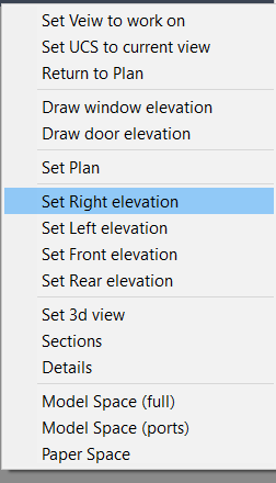

BIGAL Posted February 11, 2020 Share Posted February 11, 2020 I have Briscad so have been testing Cadarc with it, like Marko_ribar it is a package its just not 1 program. You draw outside walls add internals, then add windows and doors by the time you write some form of data file you would have drawn it and see any errors so could undo. As its 3d your elevations are generated. Quote Link to comment Share on other sites More sharing options...

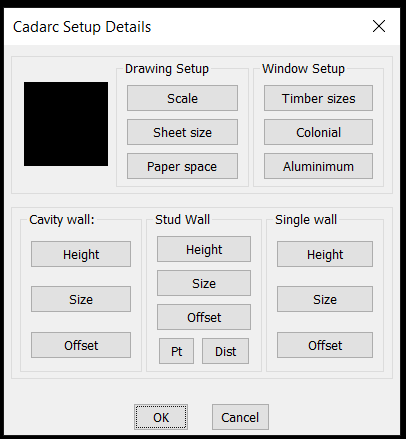

BIGAL Posted February 12, 2020 Share Posted February 12, 2020 (edited) For any one Cadarc was written around 1990+ prior to Autocad Architectural to fill a hole in simple housing & commercial, it was a product by Cad Technology Australia. I have rights to it so Private mail me and I can provide further details, it is not free but is very cheap. Obviously Revit is the way to go now. But at the smaller unique drafting its a useful tool with to many options to list here. CADARC 300+ files, 120 lisp files, 117 dwg sample and program blocks, multiple dcl and so on it was not a couple of days works. For Hanson select corner distance from corner enter window details multi pane etc and it punches hole in wall ie at correct elev in wall, note elev can be multi storey as well. Edited February 12, 2020 by BIGAL Quote Link to comment Share on other sites More sharing options...
Hsanon Posted February 12, 2020 Author Share Posted February 12, 2020 devitg, attaching the sample file sample file.dwg Quote Link to comment Share on other sites More sharing options...

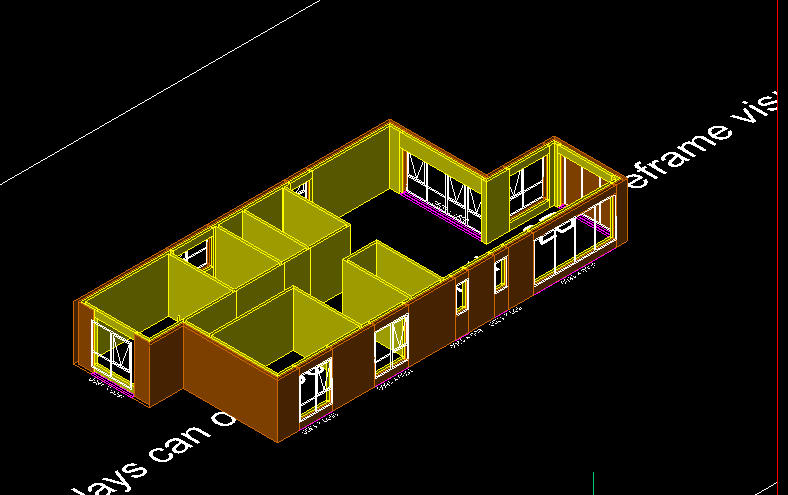

BIGAL Posted February 12, 2020 Share Posted February 12, 2020 hanson save you hours of work some hints use Mline with thickness, use copy then rotate3d, this will stand up your walls and you maintain your original 3d structure. Cadarc just uses the fact that as its 3d just change view direction so elevations are auto made at scale in a layout. Roofs are 3d widows are transparent so can see inside if wanted. Quote Link to comment Share on other sites More sharing options...
marko_ribar Posted February 13, 2020 Share Posted February 13, 2020 BIGAL, Just a remark for your attached pic., There are cases when there are more than 4 walls : walls could spread at any angle until they form closed room area. The fact is that openings in them are aligned with them and therefore elevations are perpendicular views of them all... So your example is just simple ordinary case of rectangular room, and in reality this is not always true, even OP's example shows that although all walls orthogonal that there can be more than 4 walls - look at lower room (it's kind of like "L" shaped)... I don't know if soft. you are presenting can achieve this sort of presentation, but like I said there can be more than 4 elevations and with walls spreading at any angle (you have to Set angled elevation instead of shown Right/Left/Front/Rear)... Quote Link to comment Share on other sites More sharing options...

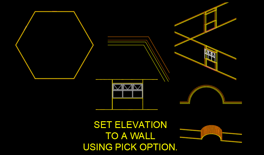

BIGAL Posted February 15, 2020 Share Posted February 15, 2020 (edited) Marko the walls can be any angle and you could draw a pentagon if you want, the default elevations you are correct are the 4 views for simplicity. But as its 2d+ so view from any angle. Its an option. Image very simple example. What about a curved wall ? Before you ask windows would have to be done as facets on the curve. You can punch the window through the wall or not depends on the situation required if no 3d renders required etc The user manual is 84 pages and yes I have added more options so needs updating. Will try to find the 3d animations includes the walk from ground up the 3d spiral staircase to 1st floor. Edited February 15, 2020 by BIGAL Quote Link to comment Share on other sites More sharing options...
