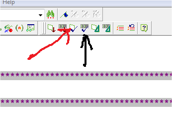

devitg Posted March 6, 2020 Share Posted March 6, 2020 YES, no DOUBT. Meanwhile you can set the variable to nil at the start. and after it work as need you can use the VLIDE Check Selection or or Check Edit Window, it will give you all globals variables names 1 Quote Link to comment Share on other sites More sharing options...
