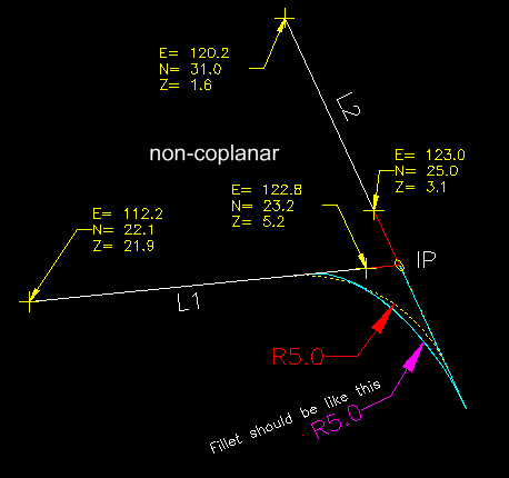

Hey guys, I'm wondering does anyone have written such routine already -
• Dealing with a LWPOLYLINE
1. Pick 1st segment
2. Pick 2nd segment
3. Specify inverse-fillet radius
4. Extend the 1st or 2nd segment, then apply inverse fillet

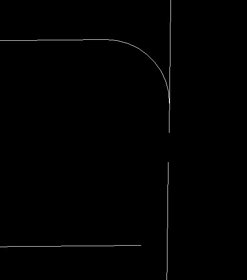

BIGAL
Hi Grr
Try this I think only works with anti clockwise plines will add that later. Need to add make closed if want to do another corner on same pline.
; add an arc fillet  to outside of pline rather than inside.
; By Alan H March 2020
; more details info@alanh.com.au

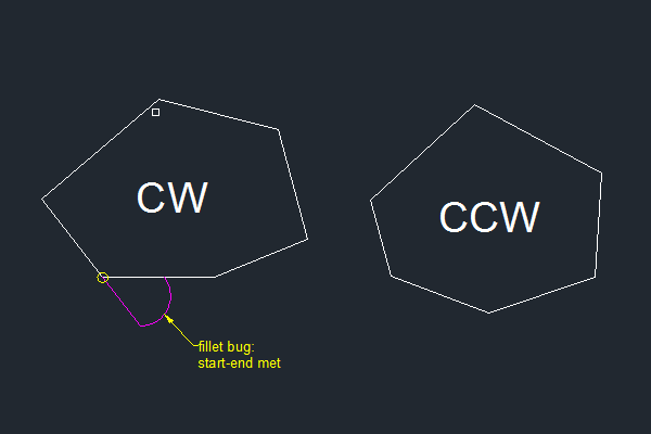

hanhphuc
1. Pick 1st segment
2. Pick 2nd segment
Two scenarios CW (clock wise) CCW (counter CW)
which direction?
1.polygon (CW) Pick seg1 & seg2  (CW)
2.polygon (CCW) Pick seg2 & seg1  (CCW)

BIGAL
hanphuc error in code (setq rad (getvar 'filletrad)) should be  (setq rad (getvar 'filletrad) we all make typo's.
It does not clean up the rectang was it meant to ?  Makes fillet on opposite corner ? Started with plain RECTANG.
Where as mine adds arc to pline. Not saying its perfect but seemed to work from the limited testing The CCW and CW is a pain to work around.

hanhphuc
Thanks for pointing out the typos, another was an extra 'x'
2e	(not
		  (apply
		    'equal
		    (append x (mapcar '(lambda (x) (abs (cos x))) aa) '(1e-6))
i've edited :  (append  (mapcar << .... snippet >>

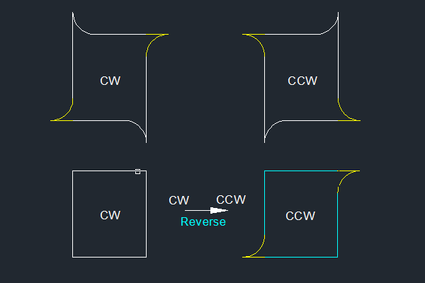

my previous code was just a test which user pick  must follow the direction CW or CCW of the polyline.
agree a bit hiccups need to check if user wanna pick a CW polyline in CCW manner then it needs to be 'reverse',
either use some exsting routine or simply command: REVERSE (AC2012 later?)
Actually if there's only single polyline picked without trim then it is possible (my previous can pick 2 entities)
Here's my workaround filter selection for CW polylines, REVERSE all selected to CCW directions,
then easier all have common directions , modify some codes
lastly restore previous CW selection.
Testing both CCW & CW
some considerations :
1.make sure closed polyline without bulge
2.purge duplicates vertices
3.need to check if fillet tangent larger than segment length
4.common fillet/chamfer restriction, can not fillet at start-end point of polygon
5.support ocs or normal
6.what happen picked segments not adjacent apart?
5.draworder - newly 'filleted' segment put to last?

p/s: i have a better way easier than this without checking CCW CW, supports bulge & end-point bugs.

hanhphuc
On 4/12/2020 at 7:42 AM, BIGAL said:
Its a hard task thats why did pick which leg, Bulges not a problem in mine provide the pline is set to closed else trim cuts pline in to 2 so crashes. Obviously can not fillet a bulge.
hi @BIGAL Have you tried trim command vs non planar condition (2 lines L1 & L2)?
Example: Radius=5, fillet L1 & L2
The difference, yellow dotted normal UCS (0 0 1) where L1 & L2, z=elevations are all same
see the 'filleted' cyan Arc is planar to both L1 & L2  (i.e: end points different z elevations)
i check Bricscad fillet command solves non-planar,
whereas AutoCAD 2007 fillet L1 L2 skips due to non-planar
my $0.02 solution is with bulge conversion,
further topic discussions --> Here
p/s: @Grrr  isn't "Extend Fillet" is more appropriate?
my $0.02 inverse definition is either 'trimmed' fillet inside or 'mirrored' out side :)

BIGAL
As you say once you introduce a 3rd dimension it all changes what is the correct arc plane ?
If you look at a staircase handrail a good example of drawing in correct plane as it turns say 90 .
My version will probably not work, but it was based around Grrr original request.
Hey Grrr did you try both codes, which one did you like  or did it fail ?

hanhphuc
 @BIGAL
no worries Alan, as long as we are healthy, many ways to skin the cat :)
stay safe always, lockdown gets over soon 😷
@Jonathan Handojo
sample DWG
non-coplanar.dwg
Share this post
