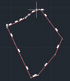

hosneyalaa
IDEA TO determinatING Location LENGTHS FOR POLYLINE
hosneyalaa
Hello all.....
Sorry for my language
Is there a
I try depending on the starting and ending coordinates
And then from the center POLYLINE
If possible, someone has an idea
To share the work
Photo attachment + working file
Thank you very much, everyone

BIGAL
dlanorh a simple closed pline but it has arcs and wants line lengths based on angle in a quadrant
Maybe start with lee-mac's pline details lisp, will have to have a think. Note pline will have to be checked for clockwise etc.

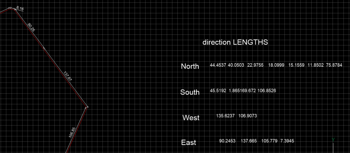

hosneyalaa
I want  determine location for all lengths
If it is located in the north with respect to the center of the area
Or some of them are in the East, West or South
Is it possible if we create a square around the area and drop the lengths on it to determine its position relative to the area
It is an idea, not a solution
I would like everyone to share his beautiful ideas if you find enough time
Edited by CADTutor
Reduced text size
Share this post
Link to post
dlanorh
You can determine North, South, East and West from the azimuth (not the angle) of the line segment, you just have to define what constitutes North South East and West. I would suggest anything lying between
45 degrees and 135 degrees would be East
135 degrees and 225 degrees would be South
225 degrees and 315 degrees would be West
anything else would be North
You'll need to get your >=, >, <= and < correct though

BIGAL
hosneyalaa asks for example code in 1st post ? Some ideas 4 text strings depending on quad use strcat lengths then write a simple mtext 4 lines. I need some time.
Something wrong where angles are exact like 0.0 not sure what I have done wrong.
(defun c:nsew ( / t1 t2 t3 t4 ss plent co-ord x pt1 pt2)
(setq t1 "Northing ")
(setq t2 "Easting ")
(setq t3 "Southing ")
(setq t4 "Westing ")
(setq ss (ssget "+.:E:S" '((0 . "LWPOLYLINE"))))
(setq plent (ssname ss 0))
(setq co-ord (mapcar 'cdr (vl-remove-if-not '(lambda (x) (= (car x) 10)) (entget plent))))
(setq co-ord (cons (nth (- (length co-ord) 1) co-ord)co-ord))
(setq x 0)
(setq pt1 (nth x co-ord))
(repeat (- (length co-ord) 1)
(setq pt2 (nth (setq x (+ x 1)) co-ord))
(setq ang (angle pt1 pt2))
(setq dist (strcat (rtos (distance pt1 pt2) 2 3) "  "))
(cond
((equal ang 0.0 1e-05 )(setq t1 (strcat t1 dist " " (rtos ang 2 3))))
((and (>= ang 0.00000001 )(<= ang (/ pi 2.0)))(setq t1 (strcat t1 dist " " (rtos ang 2 3))))
((and (> ang (+ (/ pi 2.0) 0.00000001))(<= ang pi))(setq t2 (strcat t2 dist " " (rtos ang 2 3))))
((and (> ang (+ pi 0.00000001))(<= ang (* 1.5 pi)))(setq t3 (strcat t3 dist " " (rtos ang 2 3))))
((and (> ang (+ (* 1.5 pi) 0.00000001))(<= ang (* 2.0 pi)))(setq t4 (strcat t4 dist " " (rtos ang 2 3))))
((alert (strcat "missed " (rtos ang 2 6))))
(setq pt1 pt2)
(setq pt1 (getpoint "\nPick Top left for text"))
(setq pt2 (getpoint pt1 "\nPick Bottom right"))
(command "mtext" pt1 pt2 t1 t2 t3 t4 "")
(c:nsew)

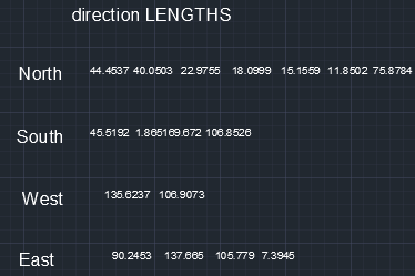

hosneyalaa
thank you
dlanorh   BIGAL
To respond and interact with me
And already by the idea of the corners before  dlanorh
And the wonderful code before  BIGAL
This is what I was asking
Thank you very much
Always be well and
good health

dlanorh
2 hours ago, sanju2323 said:
@dlanorh I have tested this lisp on another drawing but it mixes some length in different directions.
I am aware that there are many shapes where it will be deemed wrong, but it is subjective. See attached drawing. If you rotate the left most shape so that "West" is vertical it will give the correct answer.
There is no correct answer when a segment is visible from multiple quadrants. This is a just a simple algorithm  that sorts segments according to the azimuth of that segment (or the chord if the segment is arc'd). I'm sure there is a better algorithm, but Rome wasn't built in a day. I'll cogitate on a minimum enclosing boundingbox.

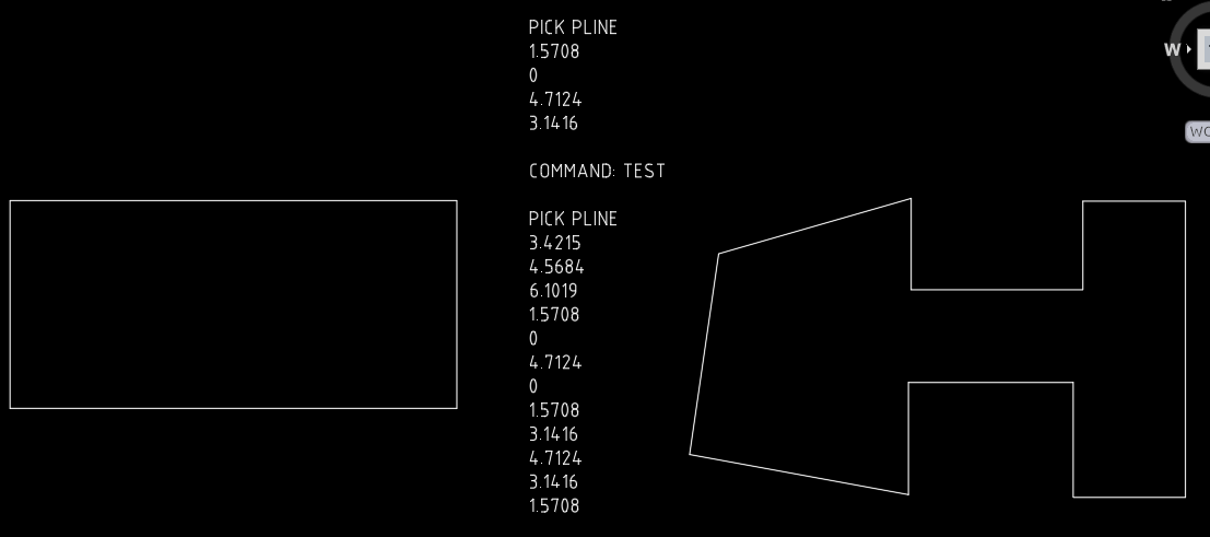

BIGAL
Don't understand this "There is no correct answer when a segment is visible from multiple quadrants." if you walk around any pline shape say clockwise the angle forward will change between the two vertices making that segment so it can only exist in one quadrant. It can fall on 0.0 90 etc.
(defun c:test ( / plent co-ord x ang)
(setq plent (entsel "\nPick pline"))
(setq co-ord (mapcar 'cdr (vl-remove-if-not '(lambda (x) (= (car x) 10)) (entget (car plent)))))
(setq co-ord (cons (nth (- (length co-ord) 1) co-ord) co-ord))
(setq x 0)
(setq ang (angle (nth x co-ord)(nth (setq x (+ x 1)) co-ord)))
(princ (strcat "\n" (rtos ang 2 4)))
(c:test)
