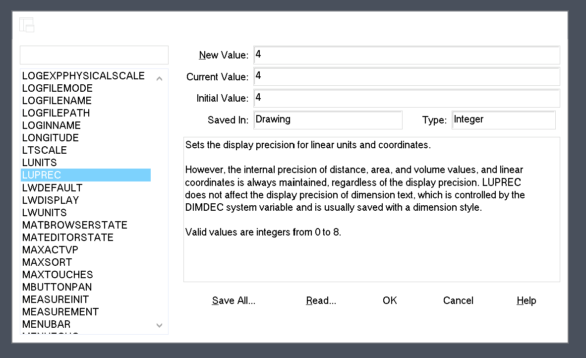

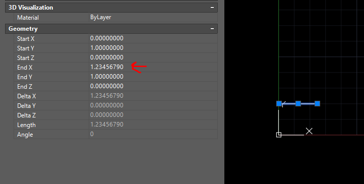

Whatever precision is displayed, AutoCAD should be working to maximum precision internally.
To see the precision on the screen, have you tried setting the system variables LUPREC for length unit precision and AUPREC for angle unit precision?
You should be able to set the precision from the units dialogue as you are doing, so I cannot image what gremlins are about!

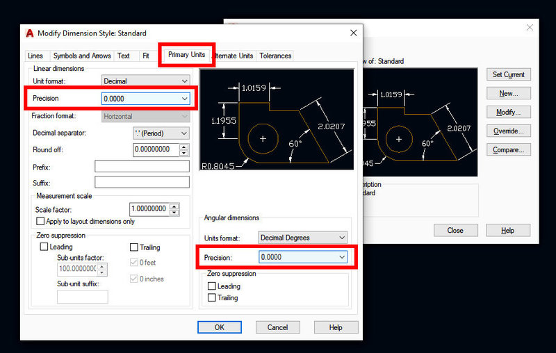

Are you talking about while dimensioning?
If so those can be fixed by modifying your dimstyle.

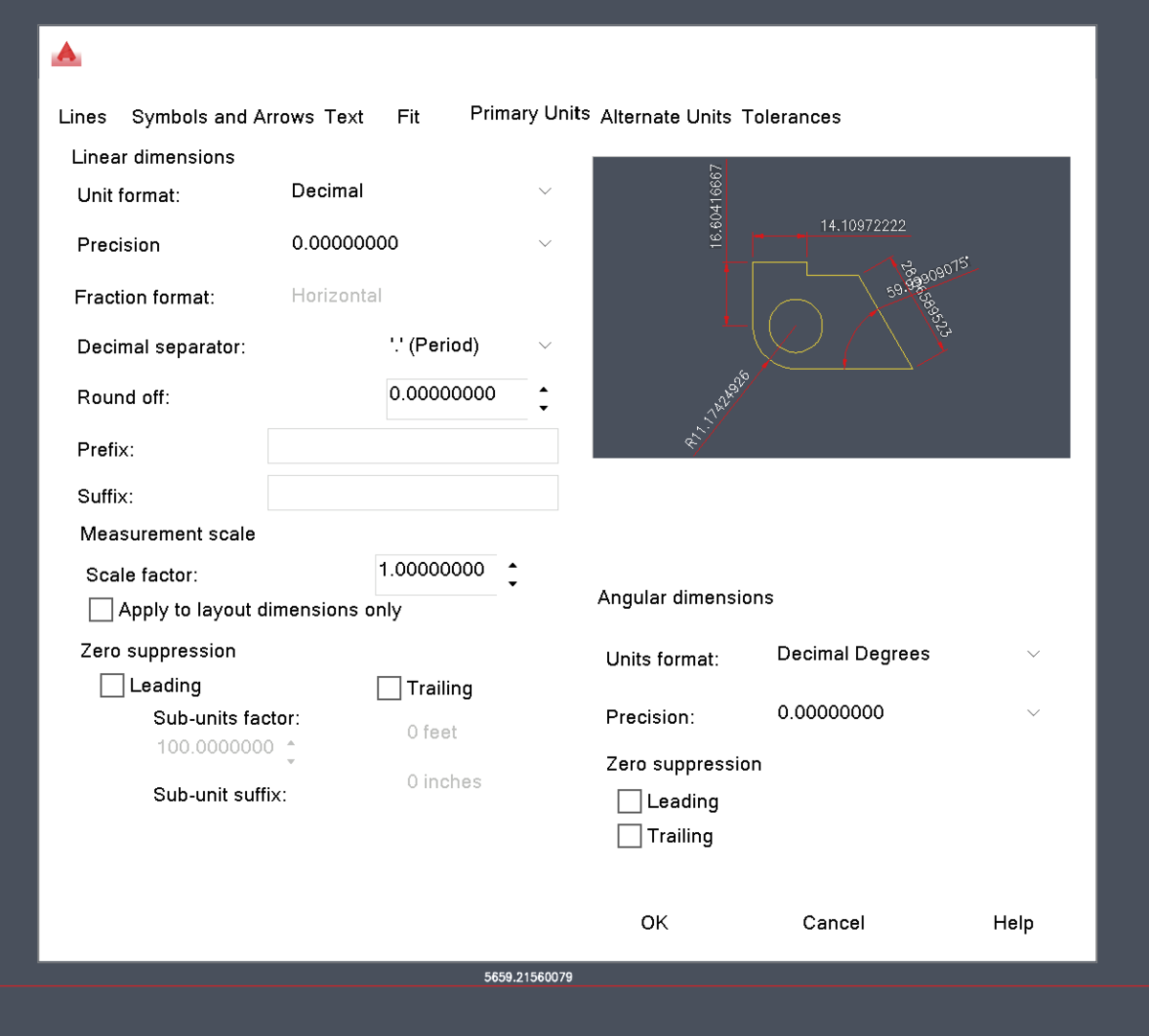

Set your Linear Dimension Display to <8>.
For angular precision see the screenshot.
Dor a Dimension style do it on the Primary Units tab of OPTIONS.

silverfox LUPREC is a system variable which sets the DISPLAY (only) precision.
If you look at the DIMSTYLE modification screenshot in my earlier post you will see that all of the dimensions shown are to  8 decimal places, including angles.

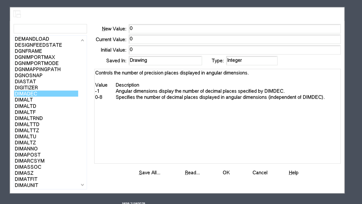

In my earlier post you will see what the DIMADEC system variable controls...specifically the ANGLE DIMENSION DECIMAL display.

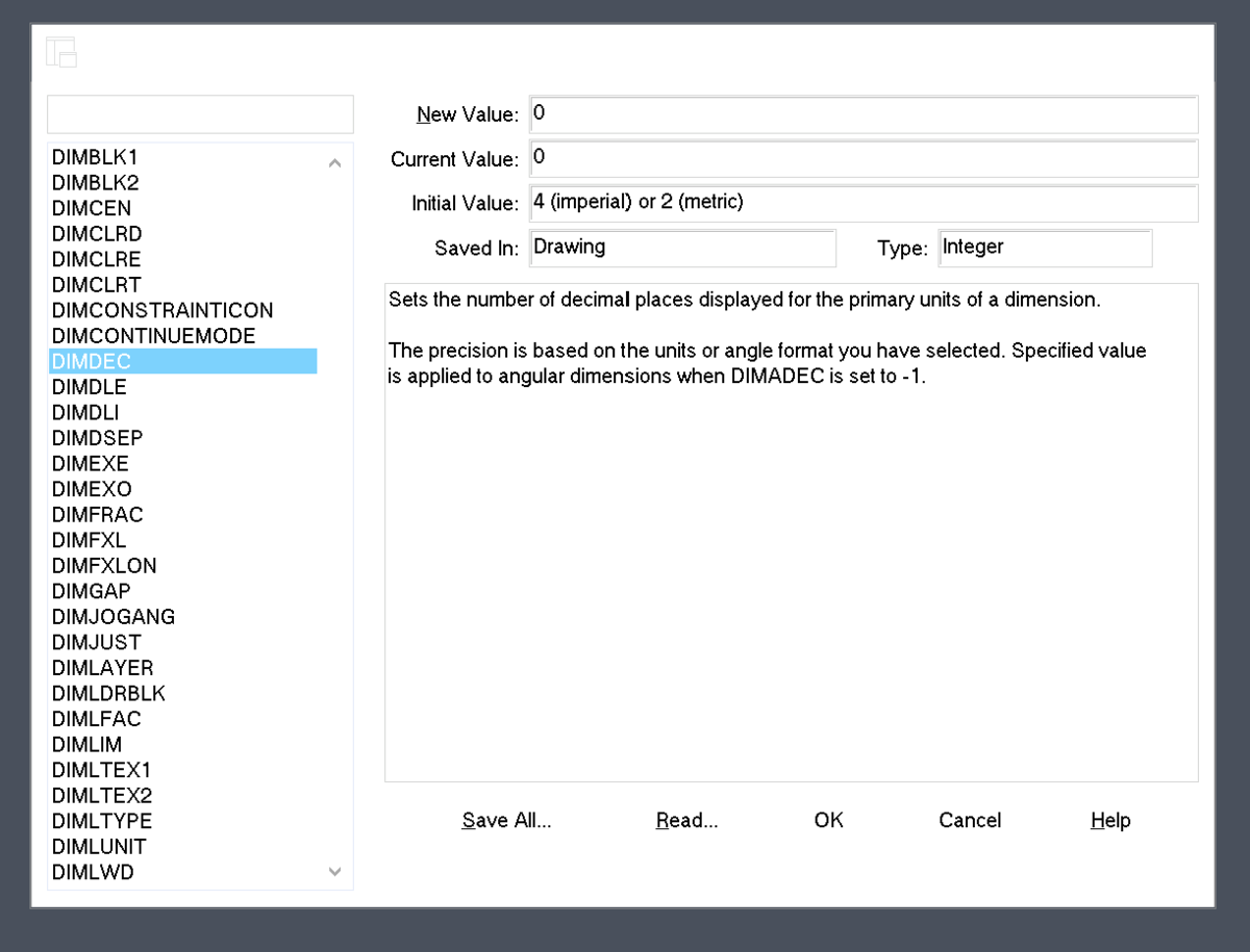

The DIMDEC system variable controls the number of decimal places displayed with a non-angular dimension.  If you want to, you can have all your dimensions display to 8 decimal places.
by using the OPTIONS command you can go to the PRIMARY UNITS tab, and set those values.
OR you can just enter the system variable name at the commandline and enter the value which you want to use.

I have also amended to parameter of dimsec for tha angle to 4 . but it still shows whole degreess.

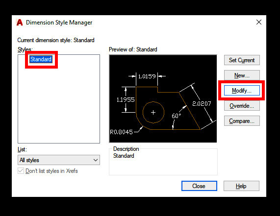

If you want your dimensions to show 4 decimal places, like they do in the drawing you attached to your last post, then you need to set the precision in your dimension style.
Type DIMSTYLE at the command prompt.
If you have more than one dimension style in your drawing, click on the one you're using for your drawing and then click the "Modify" button.
Switch to the "Primary Units" tab and set the "Precision" for Linear Dimensions to 0.0000.
Also, on the "Primary Units" tab, you will need to set the precision for "Angular Dimensions" too.
Hope that helps.

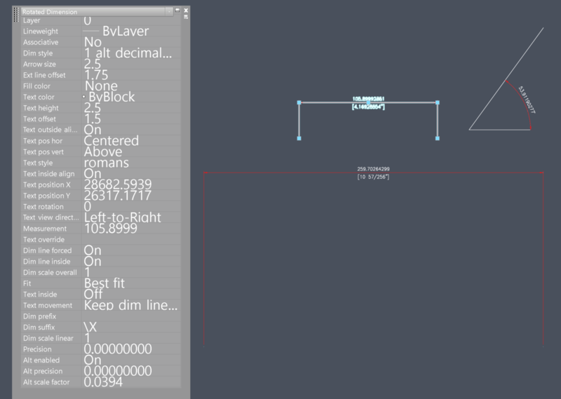

HELLO silverfox.

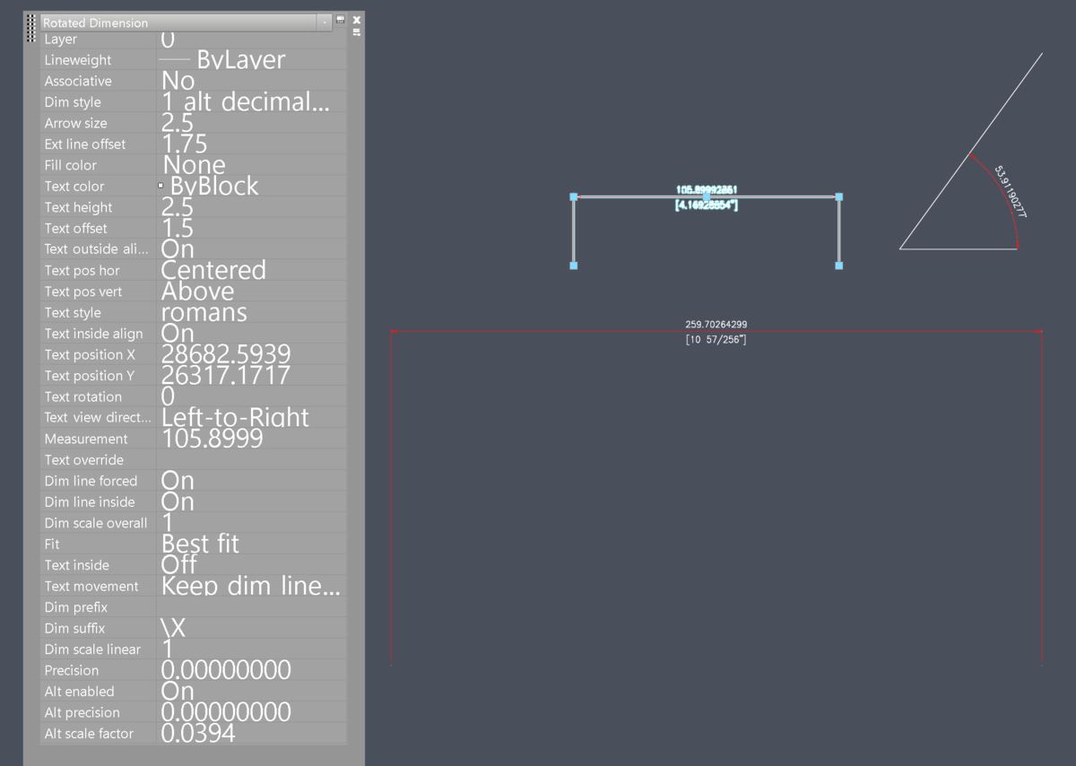

You may have missed that I attached a .DWG wherein you will find DIMSTYLES showing 8 decimal places.
I used all 8 decimal places so you don't need to worry about automatic rounding.  All dimensions are displayed to the full precision of the software, to do with as you choose.
With Alternate Dimension turned on in OPTIONS, they will display both Imperial and Metric dimensions, both to 8 decimal places.
Should you not care to see the Imperial dimension below the line, set whichever DIMSTYLE suits you to SET CURRENT in the DIMSTYLE dialog box.
Then click on MODIFY.
Click on the ALTERNATE UNITS tab.
UNCLICK DISPLAY ALTERNATE UNITS top left.
CLICK OK.
Click CLOSE on the DIMSTYLE dialog box and get back to work.   :beer:
The SYSTEM VARIABLE which controls Linear Dimension rounding is named   DIMRND, and can also be accessed as shown in Cad64s screenshot, right above Fraction Format.
The precision setting for Angular Dimensions can be set as shown on that screenshot, lower right in Angular dimensions dialog.
That system variable is    DIMADEC   (Dimension Angular Decimal)
Should one or more of those DIMSTYLES be one you'd like to take onboard, you can copy and paste them into a mm based drawing.
Or you can SAVE AS the drawing which I posted as a   .DWT (drawing template file).

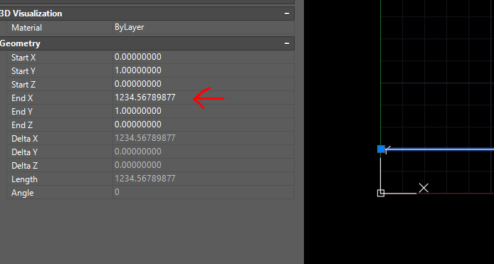

Just a note AutoCAD is a lot more precise than the 8 digits you can ask it to show, and you cannot reduce or increase that precision. As a test set your 'display precision' to just 1 decimal place and then draw a circle with a diameter of one unit. Select the circle and look in the properties for the circumference (3.1) I think everyone knows that Pi (3.142) goes on for ever, there are web sites showing Pi to a million** decimal places (has anyone read that many, why does anyone care 😇). Anyway now scale up your circle by 100,000,000 and compare the properties of the circumference to the value of Pi. Keep scaling to the point where numbers in properties are reduced down to exponential values and turn up the display precision to 8 places and AutoCAD accurately shows Pi to 314159265.3589793
