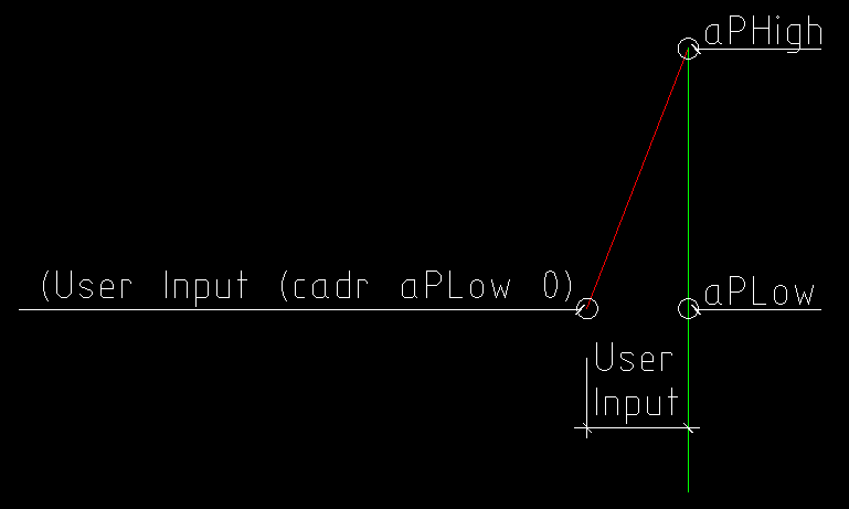

Hi all,
Just hit another roadblock with autolisp. How to i convert those numbers into a coordinate (list?) X,Y,z(0).
Example:
123 (- UserInput aPLow)
456 (i make a CADR from a GETPOINT)
0 (z value stay at 0)
I want to get (123 456 0) so i can create a line at that point.
Tried
(setq xyzCombo (list Text1 (cadr aPLow) 0 ))
Whenever i run the lisp, my Acad will stop running.
Edited by Sheep
Added an image.

BIGAL
I think your trying to hard just use my multi getvals get X Y Z much simpler.
(setq lst (list x y z))
Or just use X,Y,Z this is already done Lee-mac  => ( X Y Z)
Edited by BIGAL
