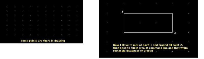

Hi All..
I need lisp routine by Clicking Two Diagonal corners like Rectangle, After finished picking need to display that rectangle area result at Command line. and disappear the drawn rectangle.
Procedure for executing lisp is 1. Pick point 1
2.Pick at Final corner point 2
3. And Displays the Rectangle area result at Command line & Disappear drawn the rectangle.
Kindly help me. i have to check the areas between different points.

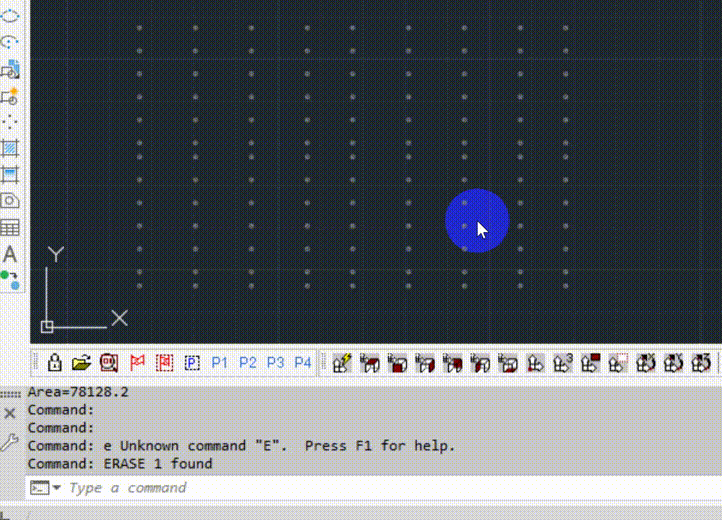

(defun c:tt (/ p1 p2 en obj )
(and
  (setq p1 (getpoint "Specify point "))
  (setq p2 (getcorner p1 "opposite corner "))
  (setq en (entmakex (list '(0 . "LINE") (cons 10 p1) (cons 11 p2))))
  (setq obj (vlax-ename->vla-object en))
  (princ
    (strcat
           "\nArea="
                 (rtos
                   (apply '*
                         (mapcar
                          '(lambda (a b) (+ a (abs b)))
                          '(0 0) (vlax-get obj 'delta)
                     2
                     3
            " M\U+00B2"
  (entdel en)
WCS
  • Like 3
