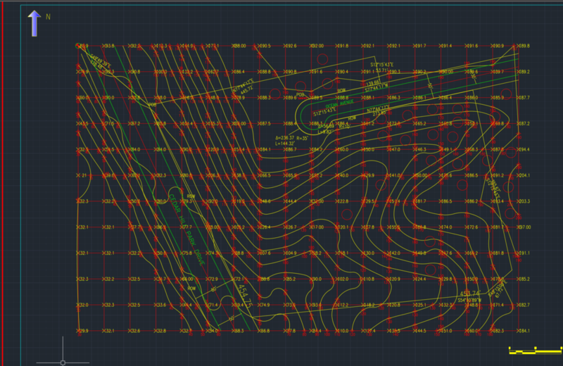

Rave

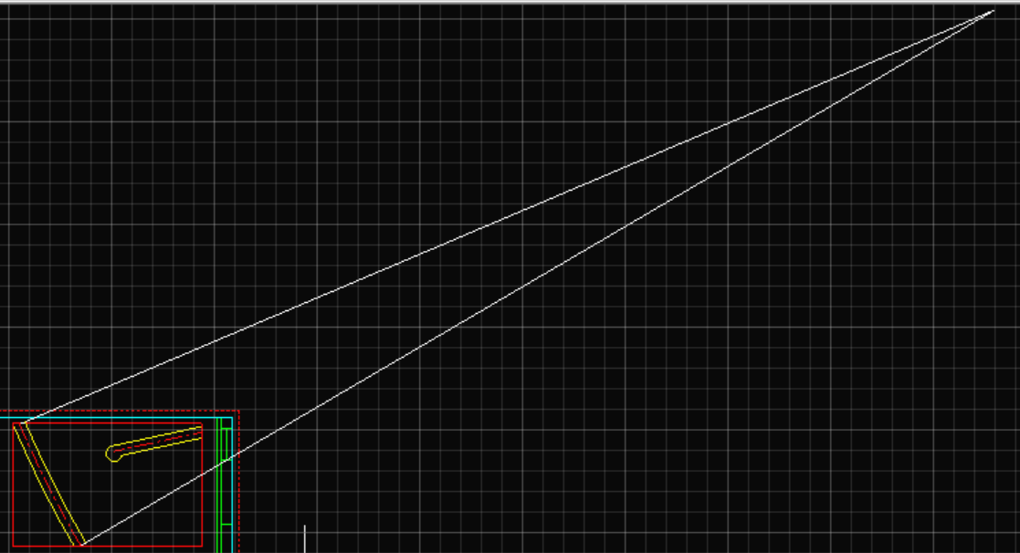

I drew the polylines. The next part ofdrawing cedar park drive is confusing. Is it an arc with a radius and a centre point? If so, when i try drawing an arc , the centre point positions the arc very far outside the grid. I used the center point coordinates from the following bullet point in pdf (Also after i enter the center point, it asks me where the starting point of arc is, i dont know what to enter there, and it has not asked me to enter radius yet. So I am stuck at this point.
"It’s at the bottom of a hillside. The centerline radius of Cedar Park Drive is 7115.37′, and the center point is at located at 528257.05,47668.89. The distance from the centerline to the curb on each side is 25′, and the distance from the centerline to the right-of-way on each side is 40′."

ReMark
OK..I found the instructions you quoted above.  Yes, the centerpoint of Cedar Park Drive (a curve with a very large radius) is far outside the limits of the drawing (up and to the right) which is not all that unusual.  Cedar Park Drive will cut across the left side of your drawing from top to bottom.  Locate the coordinates given in your instructions and use them as the centerpoint for a CIRCLE with a radius of 7115.37.  Where the circle crosses the top and bottom grid lines use the TRIM command to remove the part of the circle that is outside of the grid lines then OFFSET the portion of the circle that remains a distance of 40 units to both sides of the centerline.  That will define the right-of-way.  Done.
This is what it looks like before the Circle trimmed.
Edited by ReMark

Rave
Thanks a lot. That helped. I am now where I am drawing the line from the start of the cul desac- in the counterclockwise . I am asked me to mark delta. I calculated it using the formula:
L = (3.14 x R x delta) / (180)
144.32" = (3.14 x 35 x delta) / 180
delta = (144.32 x 180)/(3.14 x 35) = 236.37
Is this correct?
For reference I am on this step in pdf:
"4. From where you left off, draw a 144.32′ segment in a counterclockwise direction around the cul-desac. Show the delta angle, the length, and the radius of this curve. You would usually show this information on the inside of the curve, but, in this case, show it on the outside."
