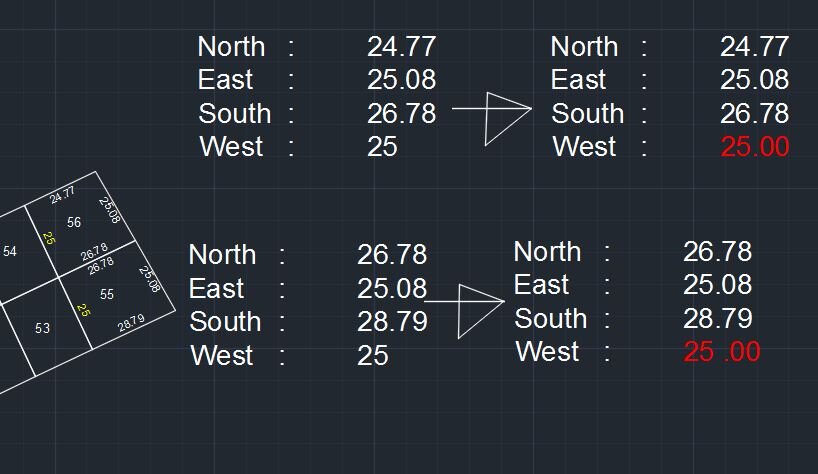

hosneyalaa Posted September 6, 2020 Share Posted September 6, 2020 Hello all Please If I have the list (SETQ LL '( 20 21.3665 22.3265 22 24.5)) If possible TO inserting two numbers after the comma Let the result look like this (SETQ LL '( 20.00 21.36 22.32 22.00 24.50)) Thank you in advance Quote Link to comment Share on other sites More sharing options...

hosneyalaa Posted September 7, 2020 Author Share Posted September 7, 2020 HI devitg BIGAL Thank you for answering The reason is that I need to make all values two numbers after the comma like the photo ;;;https://www.cadtutor.net/forum/topic/70120-idea-to-determinating-location-lengths-for-polyline/page/2/#comments ;;dlanorh (defun gc:clockwise-p ( p1 p2 p3 ) (< (sin (- (angle p1 p3) (angle p1 p2))) -1e-14)) ;; https://www.cadtutor.net/forum/topic/70120-idea-to-determinating-location-lengths-for-polyline/page/2/?tab=comments#comment-570761 (vl-load-com) (defun rh:polycw-p (obj / tmp rtn) (if (= (type obj) 'ENAME) (setq obj (vlax-ename->vla-object obj))) (setq tmp (car (vlax-invoke obj 'offset -0.05))) (setq rtn (if (> (vlax-get tmp 'area) (vlax-get obj 'area)) T nil)) (vla-delete tmp) rtn );end_defun (defun rh:midpoint ( pt1 pt2 / pt3 ) (setq pt3 (mapcar '(lambda (x y) (/ (+ x y) 2)) pt1 pt2))) (defun rh:2azimuth ( ang / a_azi) (if (>= ang (* pi 2.0)) (setq ang (- ang (* pi 2.0)))) (cond ( (and (>= ang 0.0) (< ang (* pi 0.5))) (setq a_azi (- (* pi 0.5) ang))) ( (and (>= ang (* pi 0.5)) (< ang pi)) (setq a_azi (- (* pi 2.0) (- ang (* pi 0.5))))) ( (and (>= ang pi) (< ang (* pi 1.5))) (setq a_azi (- (* pi 1.5) (- ang pi)))) ( (and (>= ang (* pi 1.5)) (<= ang (* pi 2.0))) (setq a_azi (- (* pi 0.5) (- ang (* pi 2.0))))) );end_cond a_azi );_end_defun (defun rh:em_txt ( pt txt lyr ang d72 d73) (entmakex (list '(0 . "TEXT") '(100 . "AcDbEntity") '(100 . "AcDbText") (cons 8 lyr) (cons 50 ang) (cons 7 (getvar 'textstyle)) (cons 1 txt) (cons 10 pt) (cons 40 (getvar 'textsize)) (cons 72 d72) (cons 11 pt) (cons 73 d73) );end_list );end_entmakex );end_defun (defun rh:em_mtxt (pt txt lyr) (entmakex (list '(0 . "MTEXT") '(100 . "AcDbEntity") '(100 . "AcDbMText") (cons 8 lyr) '(50 . 0.0) (cons 7 (getvar 'textstyle)) (cons 1 txt)(cons 10 pt) (cons 40 (* 2.5 (getvar 'textsize))) );end_list );end_entmakex );end_defun ;;BEGIN MAIN ROUTINE (defun C:BADP ( / *error* tht spcr sel ent obj ep cw cnt nstr sstr estr wstr b vpt ang dst m_pt a_txt l_txt azi i_ang d_pt i_pt) (setvar 'luprec 2) (defun *error* ( msg ) (if (not (wcmatch (strcase msg) "*BREAK*,*CANCEL*,*EXIT*")) (princ (strcat "\nOops an Error : " msg " occurred."))) (princ) );_end_*error*_defun (setq tht (getvar 'textsize) spcr "\U+0009" );end_setq (while (setq sel (entsel "\rSelect Polyline Entity to Label : ")) (setq ent (car sel) obj (vlax-ename->vla-object ent) ep (vlax-curve-getendparam ent) cw (rh:polycw-p obj) cnt 0 nstr "North\U+0009 : " sstr "South\U+0009 : " estr "East\U+0009 : " wstr "West\U+0009 : " );end_setq (while (< cnt ep) (setq b (vla-getbulge obj cnt) vpt (vlax-curve-getpointatparam ent cnt) );end_setq (cond ( (zerop b) (setq ang (angle '(0.0 0.0 0.0) (vlax-curve-getfirstderiv ent (+ cnt 0.5))) dst (- (vlax-curve-getdistatparam ent (1+ cnt)) (vlax-curve-getdistatparam ent cnt)) m_pt (vlax-curve-getpointatparam ent (+ cnt 0.5)) );end_setq ) (t (setq ang (angle vpt (vlax-curve-getpointatparam ent (1+ cnt))) dst (- (vlax-curve-getdistatparam ent (1+ cnt)) (vlax-curve-getdistatparam ent cnt)) m_pt (rh:midpoint vpt (vlax-curve-getpointatparam ent (1+ cnt))) );end_setq ) );end_cond (setq l_txt (strcat (rtos dst (getvar 'lunits) 2)) azi (rh:2azimuth ang) );_end_setq (cond ( (and (> azi (* pi 0.5)) (<= azi pi)) (if cw (setq estr (strcat estr spcr " " l_txt " ")) (setq wstr (strcat wstr spcr " " l_txt " ")))) ( (and (> azi pi) (<= azi (* pi 1.5))) (if cw (setq sstr (strcat sstr spcr " " l_txt " ")) (setq nstr (strcat nstr spcr " " l_txt " ")))) ( (and (> azi (* pi 1.5)) (<= azi (* pi 2.0))) (if cw (setq wstr (strcat wstr spcr " " l_txt " ")) (setq estr (strcat estr spcr " " l_txt " ")))) ( (and (> azi 0.0) (<= azi (* pi 0.5))) (if cw (setq nstr (strcat nstr spcr " " l_txt " ")) (setq sstr (strcat sstr spcr " " l_txt " ")))) );end_cond (setq i_ang ang cnt (1+ cnt)) (if (and (>= ang (* pi 0.5)) (< ang (* pi 1.5))) (setq i_ang (- ang pi))) (setq d_pt (polar m_pt (- i_ang (* pi 0.5)) (* tht 0.3))) (cond ( (not cw) (cond ( (gc:clockwise-p vpt m_pt d_pt) (setq d_pt (polar m_pt (+ i_ang (* pi 0.5)) (* tht 0.3))) (rh:em_txt d_pt l_txt (getvar 'clayer) i_ang 1 1) ) (t (rh:em_txt d_pt l_txt (getvar 'clayer) i_ang 1 3)) ) ) (t (cond ( (not (gc:clockwise-p vpt m_pt d_pt)) (setq d_pt (polar m_pt (+ i_ang (* pi 0.5)) (* tht 0.3))) (rh:em_txt d_pt l_txt (getvar 'clayer) i_ang 1 1) ) (t (rh:em_txt d_pt l_txt (getvar 'clayer) i_ang 1 3)) ) ) );end_cond );_end_while (initget 1) (setq i_pt (getpoint "\nSelect Text Insertion Point : ")) (setq a_txt (strcat nstr "\\P" estr "\\P" sstr "\\P" wstr)) (rh:em_mtxt i_pt a_txt (getvar 'clayer)) );end_while (princ) );_end_defun (princ) frame 11-99.dwg Quote Link to comment Share on other sites More sharing options...

eldon Posted September 7, 2020 Share Posted September 7, 2020 It looks like trailing zeroes are being suppressed. Perhaps examination of the system variable DIMZIN would have avoided your troubles in the first place. Quote Link to comment Share on other sites More sharing options...

hosneyalaa Posted September 7, 2020 Author Share Posted September 7, 2020 10 hours ago, dlanorh said: Attached is updated lisp to handle cases up to 2 decimal places. Bearing_and_DistancePolyH.lsp 5.42 kB · 4 downloads Thank you dlanorh you are a great person Thank you (setq l_txt (strcat (rtos dst (getvar 'lunits) 2)) azi (rh:2azimuth ang) slst (vl-string->list l_txt) );_end_setq (cond ( (not (vl-position 46 slst)) (setq l_txt (strcat l_txt ".00"))) ( (= (vl-position 46 slst) (1- (strlen l_txt))) (setq l_txt (strcat l_txt "00"))) ( (= (vl-position 46 slst) (- (strlen l_txt) 2)) (setq l_txt (strcat l_txt "0"))) );end_cond Quote Link to comment Share on other sites More sharing options...
BIGAL Posted September 7, 2020 Share Posted September 7, 2020 Eldon solution maybe easiest (setq x 20.1) 20.1 : DIMZIN New current value for DIMZIN (0 to 15) <8>:0 : (rtos x 2 2) "20.10" : (setq x 20) 20 : (rtos x 2 2) "20.00" 1 Quote Link to comment Share on other sites More sharing options...
