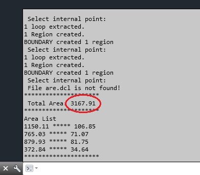

I found this area lisp tool that will give you an area based on an internal point, it will show a hatched area and then report individual areas in the command bar. I wonder if someone out there knows how to modify it so that it will also label the area in acreage. I'm currently faced with the task of pulling the drainage areas over an entire highway project and the ability to do this efficiently would be extremely helpful. I've been out of the autocad game for about 6 years so if there is a way to get Civil 3D to do this on it's own that would helpful as well. So far google has been unhelpful. Thanks in advan ce for any help.
are.lsp
Try changing to this expects sq feet.
area (/ (vla-get-area v-obj-new) 43560.0)

look at the autolisp cvunit function.
and make the changes here
(defun ARE_DCL (area / strArea list_textset); REFERENCE ONLY
(setq strArea (strcat "\n Total Area: "
(rtos area 2 2)
"\n"
; (rtos (* 1 area) 2 2)
You'll need to replace (rtos area 2 2) with (cvunit area "From units" "acre")

i want area in sqft plz tell me which part of this lisp should be modified.
What are your current units?

3 hours ago, xpr0 said:
meter
replace area in (rtos area 2 2) with (cvunit area "sq m" "sq ft")  (rtos (cvunit area "sq m" "sq ft") 2 2)
or
(rtos (* area 10.7639) 2 2)

sorry for the late reply.
i replaced (rtos area 2 2) with (cvunit area "sq m" "sq ft")  (rtos (cvunit area "sq m" "sq ft") 2 2)
its giving me the answer but with this error
local error:bad argument type: stringp
and then the answer.
also it dose not work if the original are.lisp is also loaded in the drawing.
i want to run both the lisps in the drawing plz help.

Sorry, my answer was confusing, it should have read
replaced (rtos area 2 2) with (rtos (cvunit area "sq m" "sq ft") 2 2)
As for running both, copy the original lisp, make the changes to one copy and then rename the functions to c:arem (metres the unchanged one) and c:aref (feet). You will find this a the top of the file in the first function call i.e. (defun c:are ()...  (change the red bit)

thanx for your reply.
i've edited the lisp as per your post, now its giving me the area in both units sqm & sqft at the same time thats great but its also gives the total area of all the selected areas. now its only calculating the total area in sqft, i want total area in sqm as well plz tell me which part to edit.

I'll take a look at the lisp later today. You want both sqm and sqft displayed in the same lisp correct?
yes, and this lisp does that, but the only thing that is missing is the total area in sqm.
Do you have the dcl file that this lisp is supposed to use? If not a large part of the lisp is superfluous and can be removed leaving the attached lisp, which I have renamed to arec. The lisp, as per the original, is set to auto-run when loaded. If you need to run it later it is now "arec"
If you have the dcl file, please attach it so i can test the complete package with the changes.

thanks a lot for helping me with this lisp. now its working perfectly.
i guess this lisp wont work if the dwg units are in inch or feet, right ??
and i don't have the dcl file. i downloaded this lisp from 1st post of this thread. there's no dcl file in there,
if the op or someone else has it plz upload it.
No, it will not work properly if the drawing is in feet or inches, as it assumes metres. The same applies to a drawing in millimetres as everything will be out by a factor of 1.0e6 (million). It can be altered to ask for the base units or assume the base units from system variables. The latter however assumes the drawing was initially set up correctly. The lisp can be adjusted  to account for these possibilities as it is just converting areas. The loss of the dcl is not important as I think it was used to put the area (as text) in the center of polyline.
