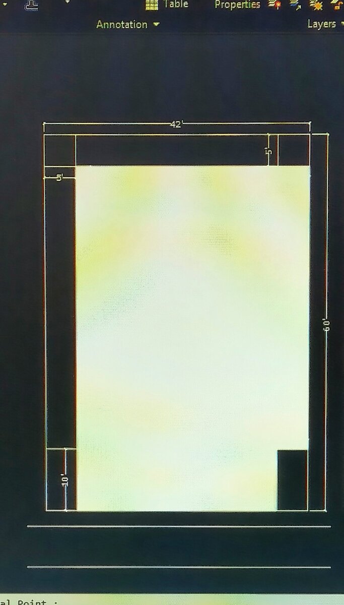

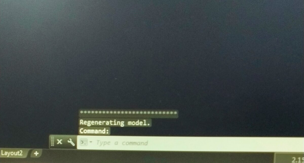

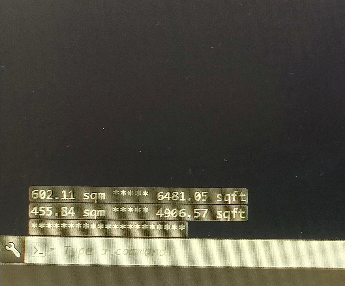

xpr0 Posted March 26, 2021 Share Posted March 26, 2021 On 11/23/2020 at 11:00 PM, dlanorh said: OK. Attached is correct lisp. Entirely my fault. arec(1).lsp 4.19 kB · 5 downloads hello everyone , i just want some small changes in this lisp, when it displays the results, its adds 2 extra line in the end. 1st is "Regenerating model. " & 2nd is "Command:" i want these removed bcz it pushes the results two rows up & i've to hit F2 every time i want to see the result. it should look like this. Quote Link to comment Share on other sites More sharing options...
tombu Posted March 26, 2021 Share Posted March 26, 2021 Putting a semicolon (;) in front of the line (vla-regen c_doc acactiveviewport) may give you the result you want. Untested as I'm not sure a regen is needed there. 1 Quote Link to comment Share on other sites More sharing options...
xpr0 Posted March 27, 2021 Share Posted March 27, 2021 17 hours ago, tombu said: Putting a semicolon (;) in front of the line (vla-regen c_doc acactiveviewport) may give you the result you want. Untested as I'm not sure a regen is needed there. thanx, it worked. Quote Link to comment Share on other sites More sharing options...

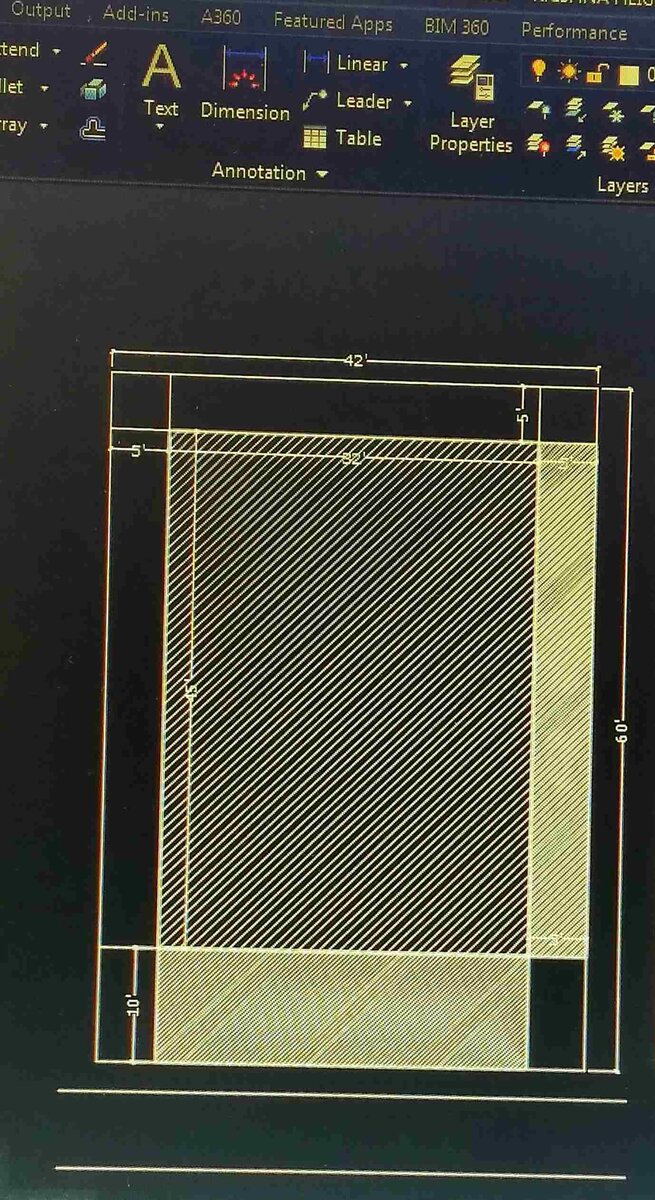

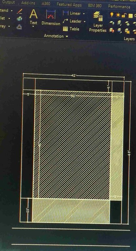

xpr0 Posted March 27, 2021 Share Posted March 27, 2021 (edited) On 11/23/2020 at 11:00 PM, dlanorh said: OK. Attached is correct lisp. Entirely my fault. arec(1).lsp 4.19 kB · 9 downloads i want to ask one more thing, when i click inside the object to get its area it gets filled with solid hatch pattern see image below. **** how to change it to ANSI31 or ANSI32 hatch pattern like this Edited March 27, 2021 by xpr0 Quote Link to comment Share on other sites More sharing options...
