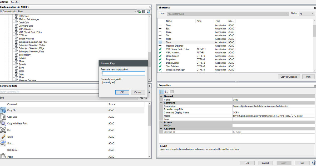

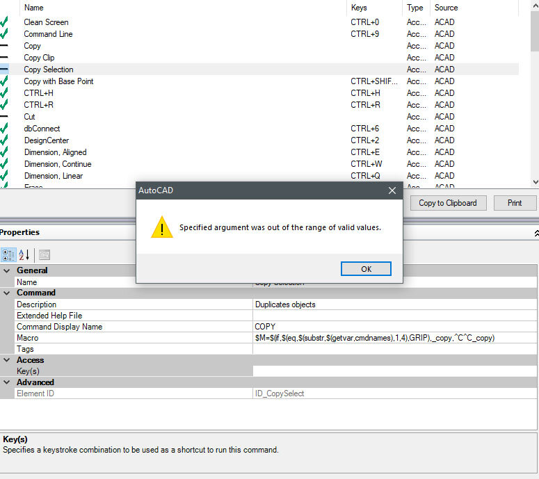

Hi!
I get this strange error when defining CTRL+C for copy selection command.
I never had any problem defining keyboard shortcuts and now this happens.
Every other key combination that I hit seems to be ok, but this one just pops u the message.
Ive checked of maybe someother command is already on this key, but none.
Please help
I typed manualy CRTL+C (letter by letter) and assigned it to "copy" command.....I couldnt find "copyselection"
Saved everything but it doesnt work.
The CRTL+C is on the alias list but doesnt work
Ctrl+C is normally copy clip (copy to clipboard and is a well known Windows shortcut).
It isn't enough to remove that from the keyboard shortcut list you actually have to reassign a new shortcut to the copy clip command and then you are free to use Ctrl+C for something new

I moved the copy selection command to keyboard shortcuts window and tried to assign new shortcut CRTL+C....everytime I get the same message as in post#1
What am I doing wrong?
Please help

Butch are you trying to setup a keyboard shortcut to copy and paste from one drawing to the other? The reason I'm asking is there are two different "copies" in Autocad at least from what I can tell. When I hover over my "copy" in the Standard toolbar it already says: "Copy CTRL+C". So isn't it already setup that way?
The other "Copy" is in the Modify toolbar and it's: $M=$(if,$(eq,$(substr,$(getvar,cmdnames),1,4),GRIP),_copy,^C^C_copy)
In Standard toolbar: ^C^C_copyclip

27 minutes ago, Butch said:
No, Im tring to asign an keyboard shortcut to the "copy selected objects command" from the MODIFY tab.
Then I would think steven-g is right. The "Copy" (COPY CTRL+C) command is already being used by the copy from drawing to drawing by the ^C^C_copyclip command in the standard toolbar. Your trying to assign two different "Copy" commands to the same key/keys.
CTRL+C....^C^C_copyclip is to copy from window to window just like in windows (X)
$M=$(if,$(eq,$(substr,$(getvar,cmdnames),1,4),GRIP),_copy,^C^C_copy) is only in that window in AutoCad.
Now you can set it up anyway you like but you will need CTRL+C....^C^C_copyclip to move things from one drawing to another sooner or later and now this might not work.
