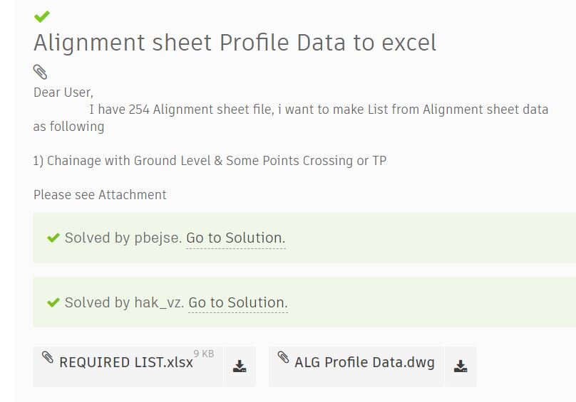

Alignment sheet Profile Data to excel
bittu
