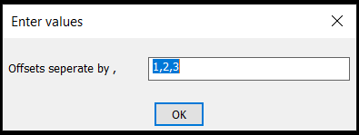

BIGAL

Re a dcl for input go to downloads here and have  a look at multi getvals.lsp, multi radio buttons.lspMulti GETVALS.lsp

(defun C:MULOFF ( / obj s off)
(vl-load-com)
(setq obj (entsel "\nSelectObject"))
(setq s (getpoint "\nPick Offset side"))
(if (not AH:getvalsm)(load "Multi Getvals.lsp"))
(setq offs (nth 0 (AH:getvalsm (list "Enter values" "Offsets seperate by , " 30 29 "1,2,3" ))))
(setq lst (csv->lst offs))
(foreach off lst
(command "_.offset" off obj s "")
(c:muloff)
Edited by BIGAL
Please What is the shortcut for run the multi getvals.lsp ?!

BIGAL
I have updated the code posted, and added the csv->lst yes that was a mistake  by me.
Inside the multi getval and radio buttons lisps are various examples on how to use if you look.
In the code posted there is 2 lines (if (not AH:getvalsm)(load "Multi Getvals.lsp")) this loads the Multi getvals.lsp code if not already loaded, it just needs to be in a support path or you can add the correct location "c:\\mydirectory\\oflisps\\Muti getvals.lsp" on your computer, note the \\ for directory names.
2nd line (setq offs (nth 0 (AH:getvalsm (list "Enter values" "Offsets seperated by , " 30 29 "1,2,3" )))) this is the code for the entry it is only 1 line in size, the box is set to a limit of 30 characters can be made more if required a list is returned of the string entered.
