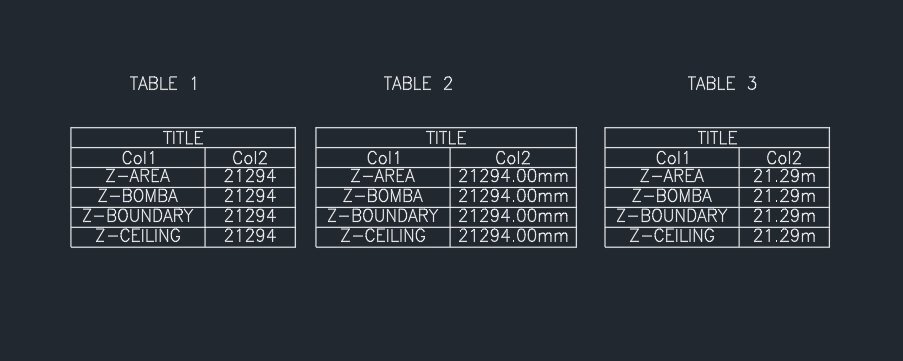

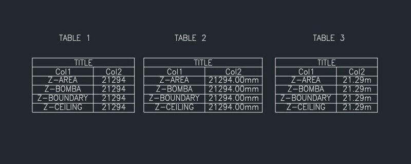

hi @BIGALfrom the lisp may i know how to make a change the current unit mm or m with surfix. i already fieldformat "%lu6%ps[,m]%ct8[0.001]" . but i dont which part i have to put it. hope you can help me
51 minutes ago, BIGAL said:
Not sure what you want post a dwg or image at least. Code above is by mhupp not me.
from the code above above result it show like table 1(attach image) . but if you dont mind . or if you can help. how to add on code to make it like table 2(attach image) or table 3(attach image)... thanks
Try these changes. I think 2nd one is more appropriate.
(vla-SetText tab row col (if (numberp c) (strcat (rtos c 2 2) "mm") (strcat (vl-princ-to-string c) "mm")))
(vla-SetText tab row col (if (numberp c) (strcat (rtos (/ c 1000.0) 2 3) "m") (strcat (vl-princ-to-string (/ c 1000.0)) "m")))

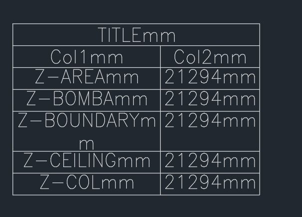

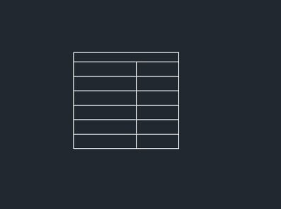

hi @BIGALi already try and i attached the code with picture the result from the code you giving. from laylenght rev1.lsp all text change mm and from laylenght rev2 no text on the table.
LAYLENGHT rev2.lsp LAYLENGHT rev1.lsp
