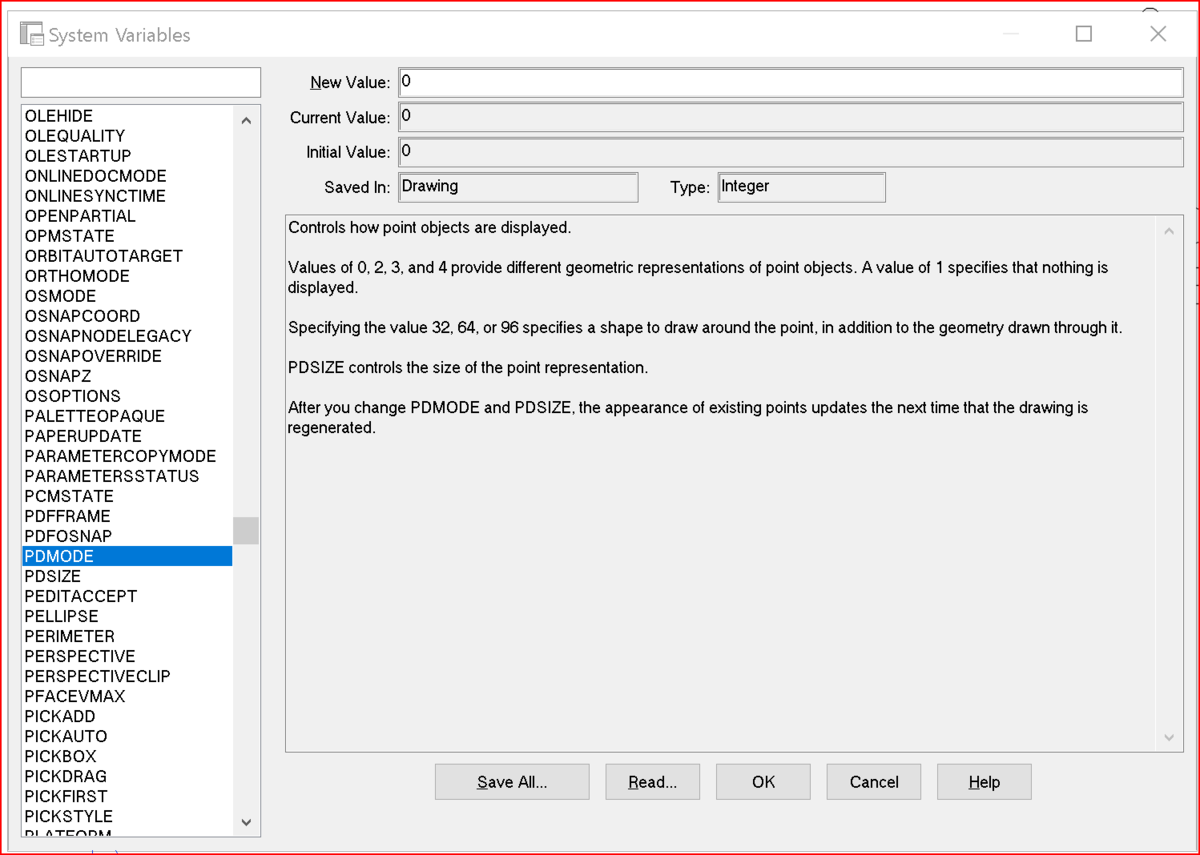

The system variables for which you are looking are PDMODE and PDSIZE, as shown in the SYSVDLG
screenshot.  Both of those variables can be accessed at the commandline,
I misstated earlier that they are midcommand options, which they are not.
To define your point style as an "X" set your PDMODE system variable to 3.image.thumb.png.c6d69be913f5facc7e993d4843cb478d.png

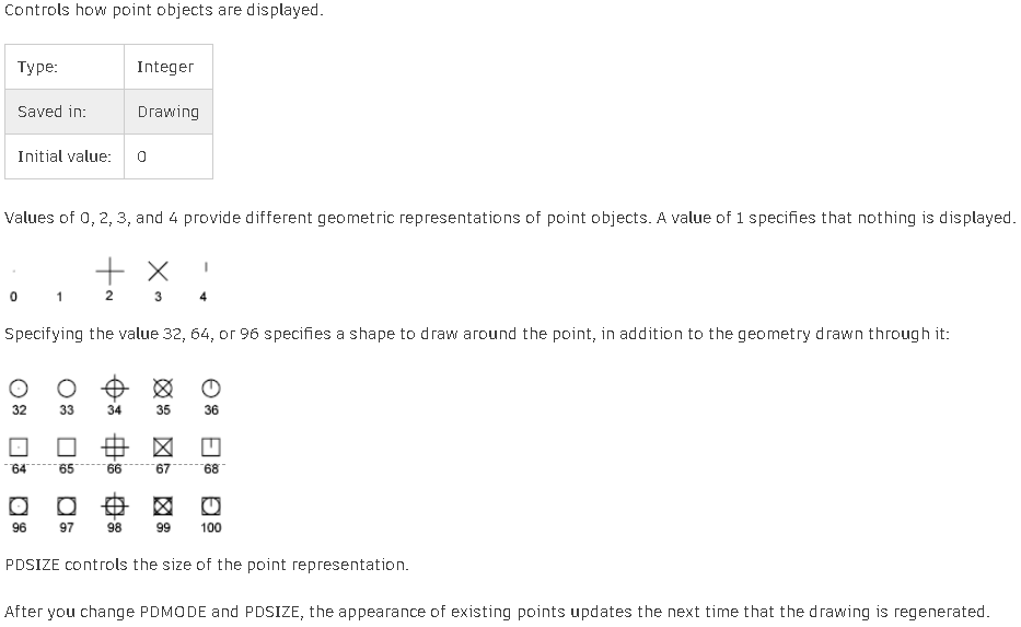

Just to add to @Dadgad's answer this is a screenshot taken straight from the Autocad help files showing the various options for showing a point in pointmode.
And as a note just to highlight that pdmode affects all points existing or new, you can only have one type of point in a drawing file

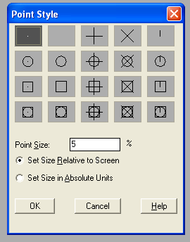

I don't know whether the command still exists, but I can type DDPTYPE and a dialogue box opens up to set the Point Style.
Old school, I LIKE it!  A picture is worth a thousand words.  :beer::beer:
DEFINE DEFAULT POINT TYPE, now I will remember it.   :beard:

You can also simply click the format button on the AutoCad window menu.  About 3/4 the way down you will find a Point Style to click on.
Keep in mind that a point (style) does not automatically resize with zooming.  Regen to get them to match your screen zoom level.
If you set the point size to Absolute Units, it zooms very nicely. It is only when the size is set to Relative to Screen that you need to Regen after zooming.
