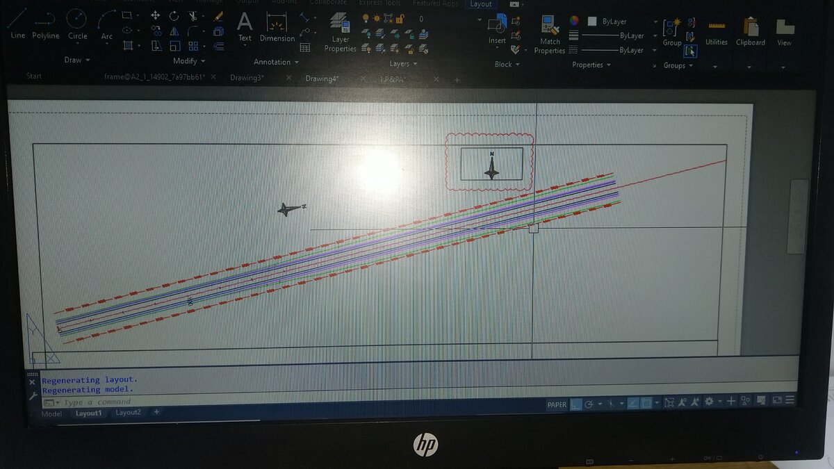

Ish

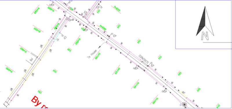

Actually Sir, I have around 200 layout of road plan, in every layout view port Angle is different,
So, engineer told me show North arrow at every road plan viewport,
Don't copy North symbol in model space at every km.
Just one North symbol in model space, and make separate viewport for north at near road plan viewport corner.
In image inside red colour cloud is viewport of North, on layout.
Other north is in model space, that one engineer don't want.
Hope you understand my situation.
I need a trick or lisp that can draw/make automatically viewport with north symbol with same rotation angle of road plan viewport.
Thanks

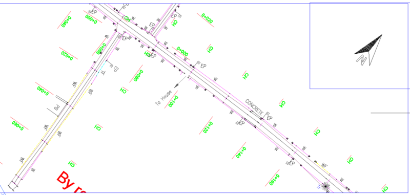

Kajanthan
Hi @BIGAL
Your Lisp working well.
According @Ish requirement is here
(defun c:dd (/ sss obj ang ss vpo)
	(command "._PSPACE")
	(prompt "\nSelect source Viewport")
	(setq sss (ssget "_+.:E:S" (list (cons 0 "Viewport")) ))
	(setq obj (vlax-ename->vla-object (ssname sss 0)))
	(if (= (vla-get-objectname obj)  "AcDbViewport")
		(setq ang (vlax-get obj 'TwistAngle))
	(prompt "\nSelect North symbol Vewport")
	(setq ss (ssget "_+.:E:S" (list (cons 0 "Viewport"))))
	(setq vpo (vlax-ename->vla-object (ssname ss 0)))
	(vlax-put-property vpo 'TwistAngle ang)
Original
Original
Result
TwistAngle on Viewport.lsp
  • Like 2

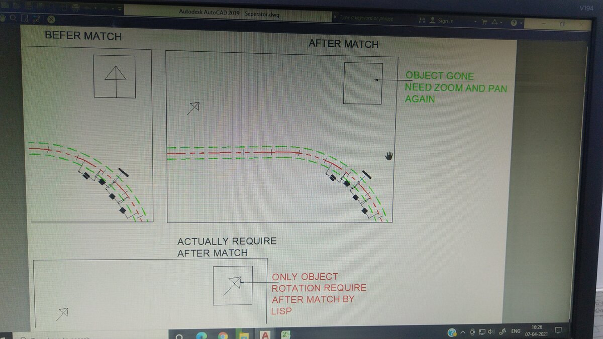

Ish
Thanks for your good reply sir,
I used twistable on viewport.lsp,
Working nicely but when I match viewport to north , object gone again I need to zoom and pan inside VP.
Sir I don't want zoom and pan inside VP.
Hope you understand

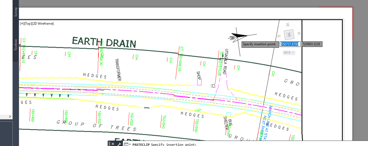

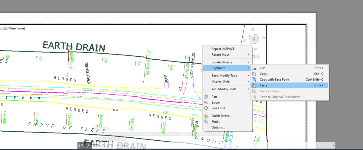

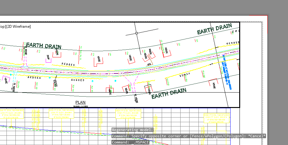

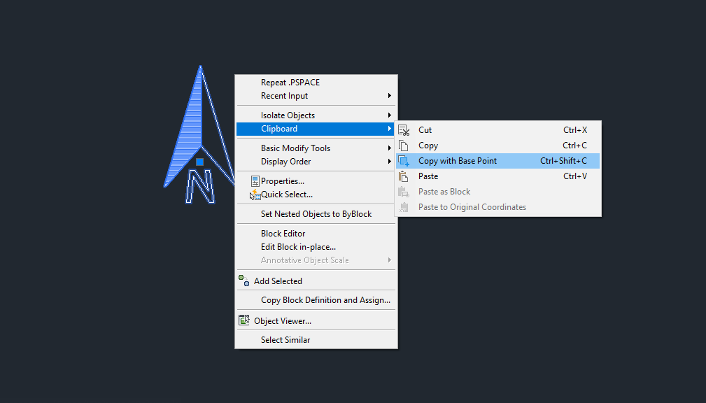

Simple way..
Copy with Base point your North Symbol
Double click in the viewport
Paste
Click Your clear location
Share this post
Link to post
ronjonp
7 hours ago, Kajanthan said:
Simple way..
Paste
Exactly :)
