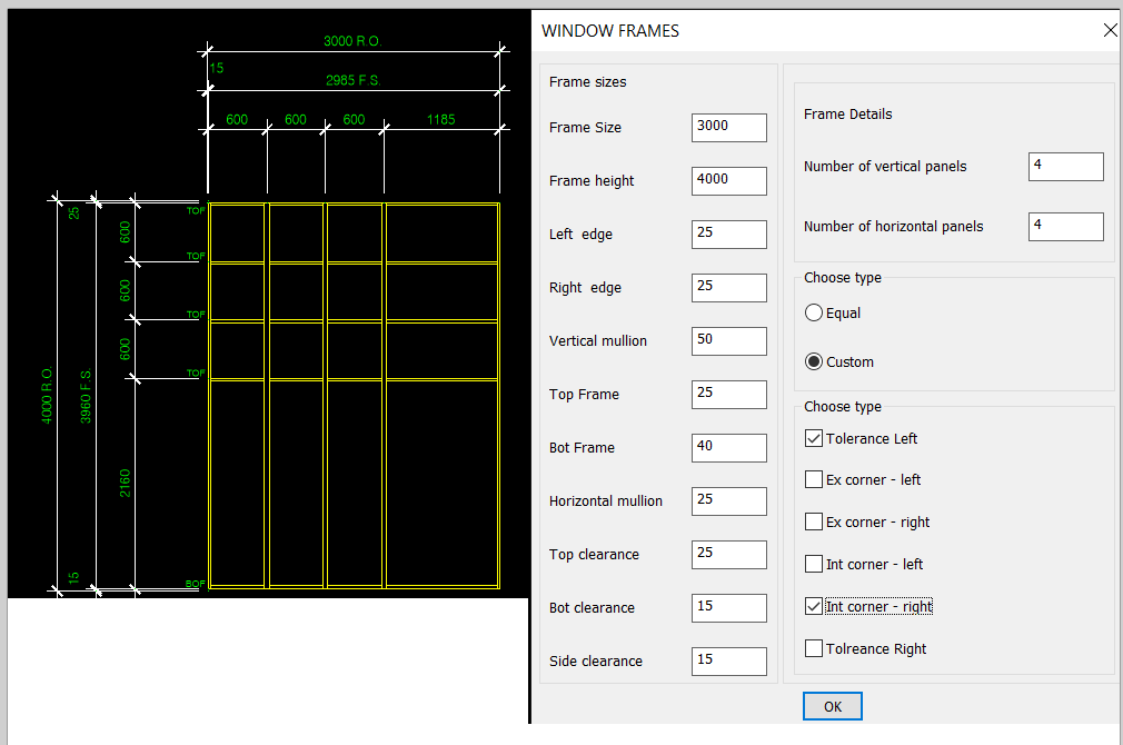

BIGAL
Have a look at some of the others out there like Bricscad, Intellicad and Drafsight they all support lisp and are cheaper than LT.
I am sure others here can provide some gif's or mp4 to illustrate common daily tasks automated. Please let use know what industry your in.
This takes about 10 seconds really how fast you do the values, most are pre set.
1 dim takes about 4 seconds to do, let alone draw the frame to size.
