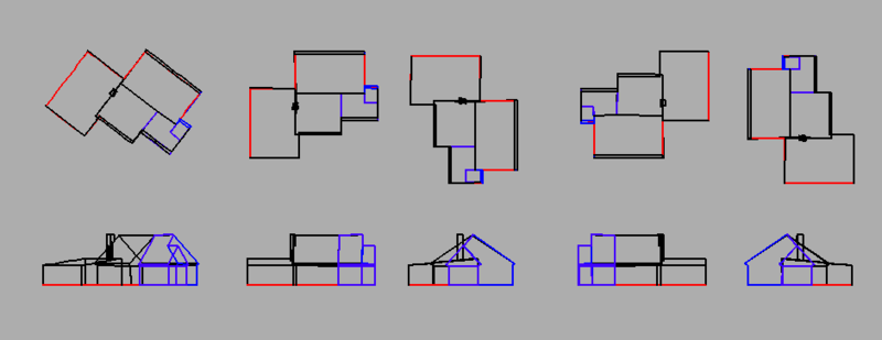

B.N. Posted May 30, 2021 Share Posted May 30, 2021 Hello, I've been asked to make facade views from a survey in 3D. I have the house in 3d lines and i would like to extract the front-, left-, right- & back view of the facade. i used to do this by redrawing in an other file, but there has to be an easy way to "extract" that view. 1245337672_3dhouse.dxf Quote Link to comment Share on other sites More sharing options...

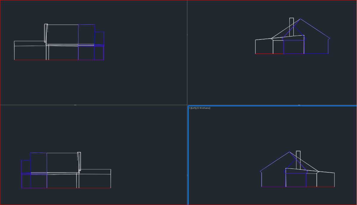

Dadgad Posted May 30, 2021 Share Posted May 30, 2021 If you look in TOP view you will notice there are some issues. I ROTATED your linework in TOP view using the commandline Reference option, to square it up to the UCS. Then I used the VPORTS command to create 4 equal viewports. I went into each of them and set a different orthogonal view. It ain't perfect, but it might get you started pretty well. Probably a good idea to first address what I take to be some problems, which jump right out at you in TOP view. I hope that helps. Quote Link to comment Share on other sites More sharing options...
B.N. Posted May 30, 2021 Author Share Posted May 30, 2021 1 hour ago, Dadgad said: If you look in TOP view you will notice there are some issues. I ROTATED your linework in TOP view using the commandline Reference option, to square it up to the UCS. Then I used the VPORTS command to create 4 equal viewports. I went into each of them and set a different orthogonal view. It ain't perfect, but it might get you started pretty well. Probably a good idea to first address what I take to be some problems, which jump right out at you in TOP view. I hope that helps. The issues you refer to, might be because it's an old building, not straight at all. Your solution with the viewports has come to mind, but i don't know how to align the viewports as straight as you did. Can you give me some guidance there? thanksjss Quote Link to comment Share on other sites More sharing options...
eldon Posted May 30, 2021 Share Posted May 30, 2021 I, however, usually rotate the plan to give one face that is orthogonal. Copy it three times, rotating it by 90 degrees each time. Then rotate3d to give elevations in each direction. I do this because I prefer to work in plan view, and each elevation does not need to see the detail from the other faces. When you rotate by reference, choose the base point at one end of a line, specify R for reference, specify the reference angle by choosing the first point again, then choose the other end of you line as the second point, then if you activate Ortho, when you have to choose the new angle, you can see the proper angle and merely click to choose that angle. 2 Quote Link to comment Share on other sites More sharing options...

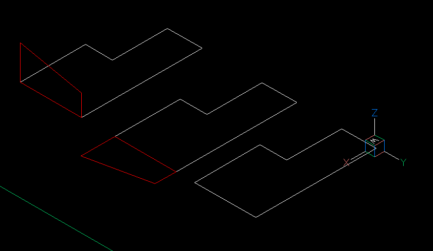

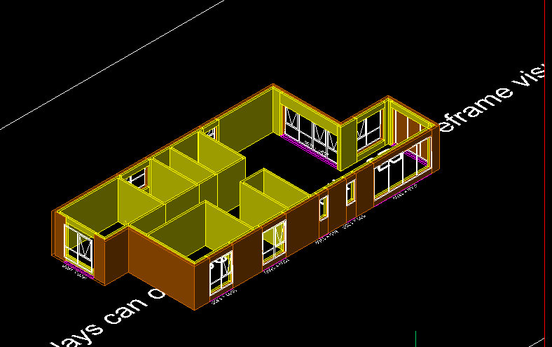

BIGAL Posted May 30, 2021 Share Posted May 30, 2021 (edited) Ok some more big hints, thickness for walls, pface for roofs, same for gable wall ends. Think more 2 1/2D. This was done in a cheap house package, its like 30 years old, if interested PM me. Yes does the elevations as previously suggested in a layout, look at Vpoint. -vpoint 1,1,1 (if (= look "R")(command-s "-vpoint" "1,0,0")) (if (= look "L")(command-s "-vpoint" "-1,0,0")) (if (= look "F")(command-s "-vpoint" "0,-1,0")) (if (= look "B")(command-s "-vpoint" "0,1,0")) (if (= look "P")(command-s "-vpoint" "0,0,1")) There is a good lisp for roofs, "2droof-final-new.lsp" search here. Had a look at dwg and pretty sure this could help CA5SLWAL.LSP:;;; erases a wall line and replaces with a 3dface with different slopes ; program starts here (setq tp1 (entsel "\nSelect wall near left end : ")) (setq wa_ht1 (getint "\nEnter 1st wall ht ")) (setq wa_ht2 (getint "\nEnter 2nd wall ht ")) rest of code copyright Edited May 30, 2021 by BIGAL 1 Quote Link to comment Share on other sites More sharing options...
BIGAL Posted May 30, 2021 Share Posted May 30, 2021 (edited) A simple way to make facades, note if want as solid ie a wall so hide works then make a pline and add a pface or 3dface then rotate3D vey simple. Can do windows and doors as line work just use the trick of they are 1mm off the wall so recognised in a 3d view and when hide is used. Edited May 30, 2021 by BIGAL Quote Link to comment Share on other sites More sharing options...
