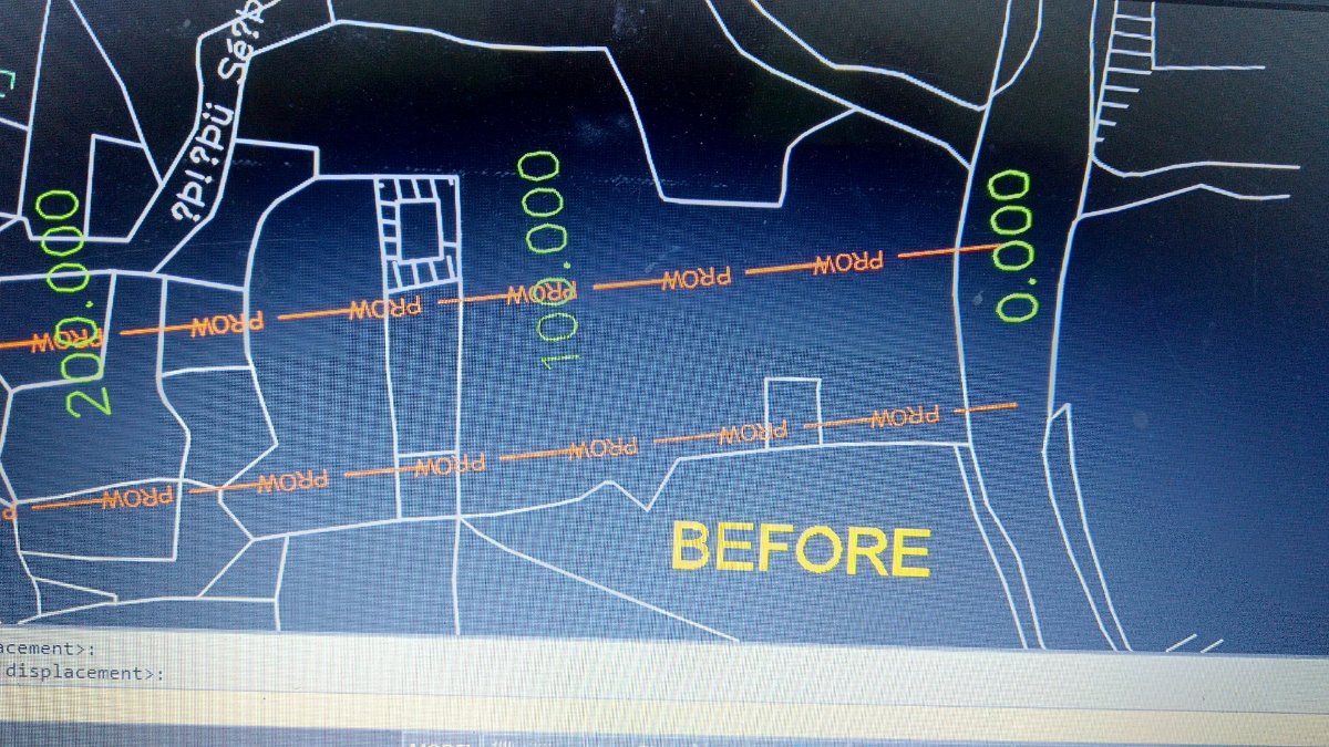

Ish Posted July 17, 2021 Share Posted July 17, 2021 Dear team, I need a lisp program or tips tricks to draw a close polyline within PRoW for land acquisition plan and area for Road project. I want all at one click command. Currently I am using boundary command but is one by one clicking. Hatch for reference, need a close polyline. See attached image And cad file. LAP-CLOSE PL.dwg Quote Link to comment Share on other sites More sharing options...

Ish Posted July 18, 2021 Author Share Posted July 18, 2021 9 hours ago, confutatis said: It doesn't seem to me that the bpoly command wastes that much time.... Sir, Project length 80km Too much land acquisition required. I just upload small part of project. Quote Link to comment Share on other sites More sharing options...
Ish Posted July 18, 2021 Author Share Posted July 18, 2021 3 hours ago, BIGAL said: A starting point (defun c:hatchang ( / ang pt) (setq ang 0.0) (while (setq pt (getpoint "\nPick point Enter to exit")) (command "-hatch" "P" "ansi31" 1 ang pt "") (setq ang (+ ang 30)) ) (princ) ) @BIGAL hatch is not required, sir Hatching is Just for reference. I need only a close polyline (like by boundary command) Too much land acquisition required. I just upload small part of project. Thanks Quote Link to comment Share on other sites More sharing options...

Ish Posted July 19, 2021 Author Share Posted July 19, 2021 Any trick or shortcut at least done 80% Remaining 20 I will do by boundary command. Quote Link to comment Share on other sites More sharing options...
