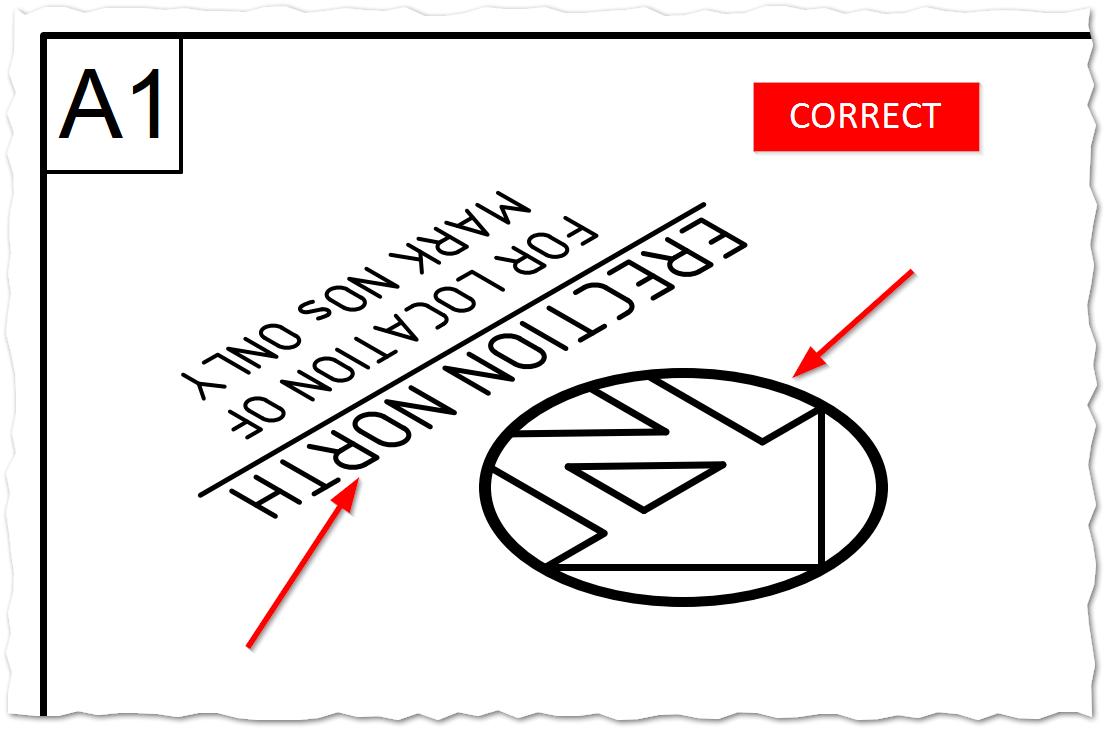

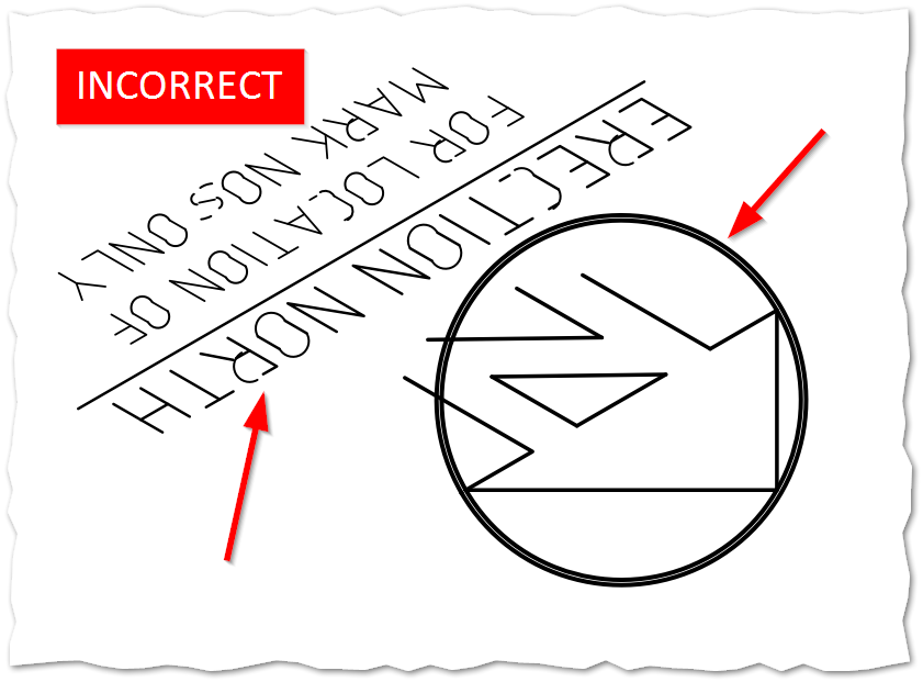

Hi,
Please see images below.
I have found that ACAD 2017 will plot PDFs (using 'DWG to PDF.pc3') but will not represent isometric circles & isometric text correctly.
Same block and same font shown in both images.
- The correct picture was plotted using 'DWG to PDF.pc3' on ACAD2015, Windows 8 64 bit.
- The incorrect picture was plotted using 'DWG to PDF.pc3' in ACAD2017, Windows 10 64 bit.
Is it possible to fix this?
Thanks for any help

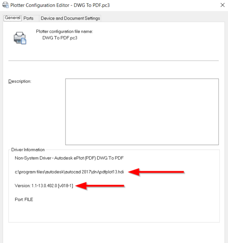

@ammobake I've tried pointing ACAD to a more recent PC3 (from TrueView 2021) - still get the same results when plotting from ACAD2017.  I think the PC3 file still points to the .HDI driver that is possibly the source of the issue.
@SLW210 I've tested plotting from TrueView 2021, and it plots correctly.
My understanding is that it's the .HDI that has the issue (not the PC3).  I'm not sure how to control which .HDI the .PC3 points to - seems to use whichever version that was shipped with the ACAD version (or maybe whichever version was launched most recently?).  If there is a way force my PC3 to use an alternative HDI driver, I expect that will fix the issue.

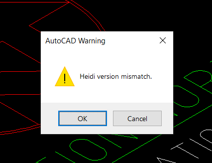

Can you replace the 2017 HDI with the newer one from DWG TrueView? Do you have all updates?
Perhaps it's time to discuss a newer AutoCAD version.
I can replace it - but then I get a Heidi error for driver mismatch... which looks like this:
There are some other support files that I can try replace and rename, but haven't got around to testing that just yet.
