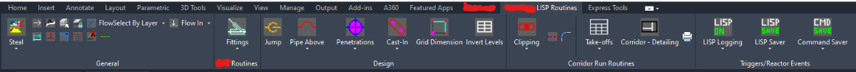

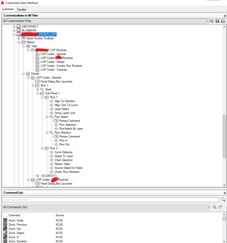

Might just have to play around with the CUI and create your own tabs and ribbons. Creating a dropdown menu is a one-time setup each time you create a new one (unless your command has different names). This is an example of mine (a few of these are Lee's routines from his website):
Can be structure through the user interface using CUI command or whatnot and make your own partial customization files.

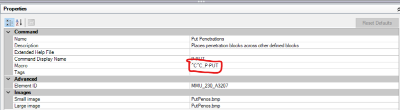

Can create a new command and name it to whatever your command name is, and then put a macro like this (using "^C^C_" followed by the syntax of the command to be invoked. In the example below, the name of the command being invoked is P-PUT, hence ^C^C_P-PUT) :

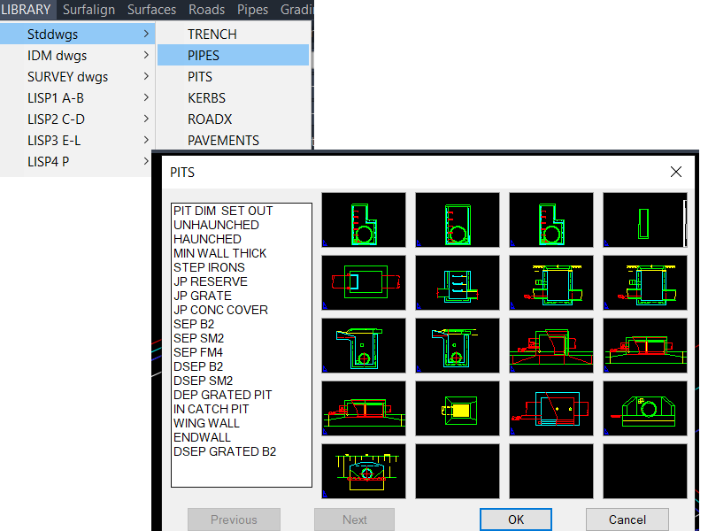

If you want a drop down menu make a custom .mnu its just a text file using Notepad, going custom is much easier than using the CUI, a POP menu can have sub menu's as well. Making a custom mnu can be edited at any time and its a simple menuload to update, we had the mnu on the server so when a user opened Autocad they always got the latest version. You can make custom tool bars as well with custom icons again using notepad. More than happy to provide examples.
The other is if you want a pop DCL select use my Multi radio buttons.lsp that was written for this type of situation.
