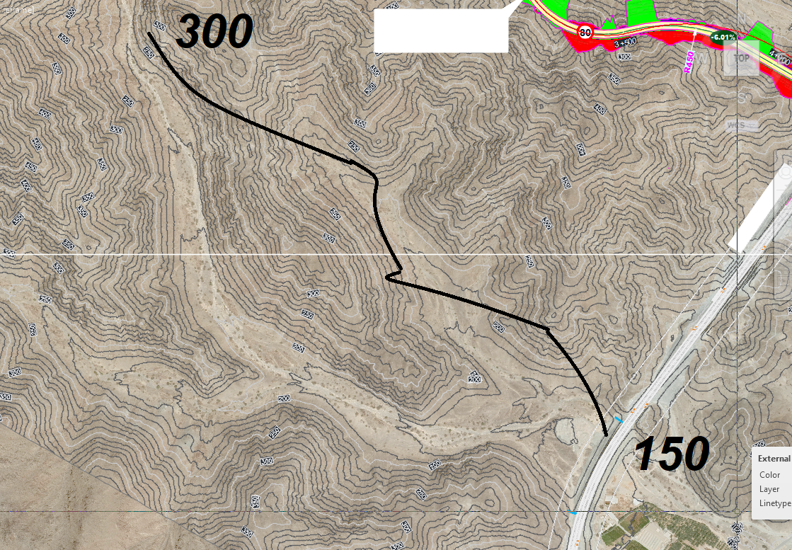

I need one help If we have terrain data any format XML POINT CLOUD  .TXT   .CSV  contour here I want design highway/road is there any software or application in civil 3d bricscad
1- If we assign grade suppose 6% to reach 150 elevation to 300 elevation with automated generate alignment profile with specific curve radius
2- Is there any option to generate automated alignment if we assign 2 point start and end in result we got alignment
3- I want to generate alignment in high elevation terrain location which software is more helpful
5- If we have ground data how can create highway

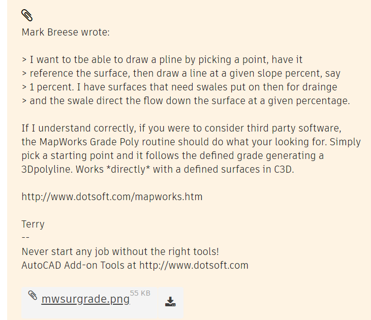

There was some software out there that looked at forward direction and match a slope. Civ3d does pick 2 points and label slope. A bit of trail and error then a final alignment.
Edited by BIGAL
Thanks @BIGAL for the mention.  A video would be pretty boring since you simply supply parameters such as grade and pick a starting point, so here is a screen capture.
This is the same add-on I recommended to the OP over in the BricsCAD forum for converting multiple polylines to alignments.
