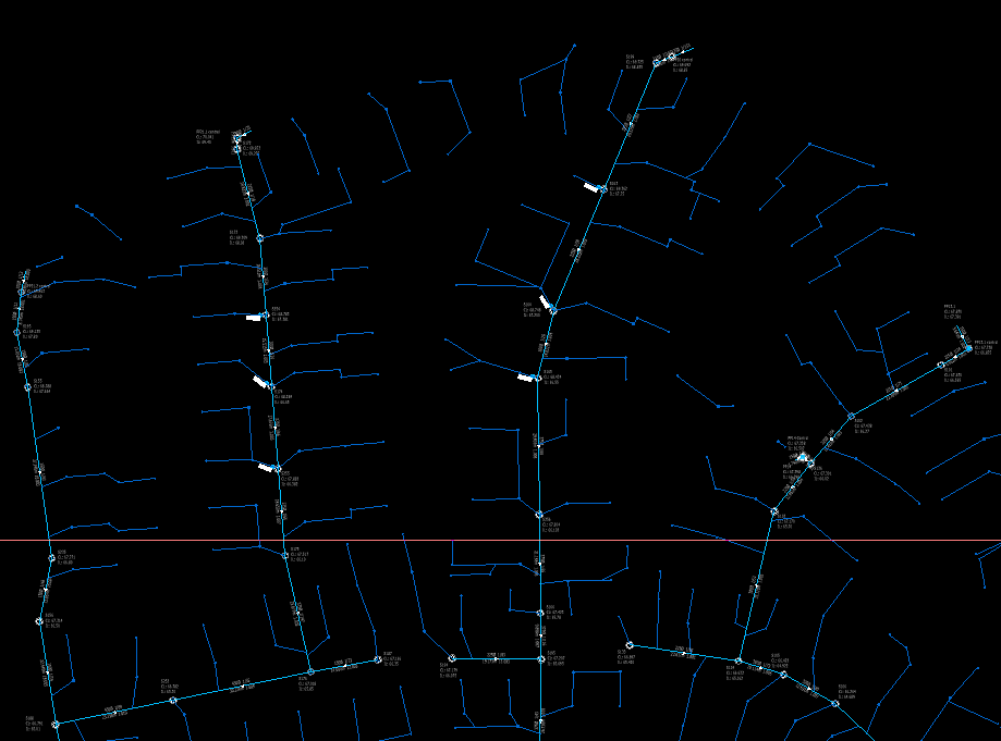

I want to show a specific length from specify point (for example: 1350 meter) on the network of main and secondary pipe lines.
Of course, I raised this problem in the map 3d forum so that maybe it can be solved by creating a topology.
But it seems that this is not possible in map 3d (network topology).
The point specified by the user can be at the beginning of one pipe(polyline) and at the end of another pipe(polyline) at the same time (green polyline and red polyline).
But surely the point selected by the user will not be somewhere else on the polyline.
I want to specify the start point ,then program to select the polylines that are in contact with it and to show a point on the main pipes and branches.
and all the main pipes' Polylines and all sub pipes' polylines no contain arc segments.
If creating a vertex on the main pipe at the intersection of the secondary pipe helps to solve the problem, I can do this.
I will be very grateful if you can guide me in solving this problem.
Please help me by Lisp if possible.

Still confused, so you want to enter 50 and get a point on your main 50 away from start point, and the same distance but along main and then ending somewhere along sub at total of 50.
Edited by BIGAL
Dear Bigal thank you for reply
You got it exactly right.
I want the desired length to be determined from the start point specified by the user in the main and secondary routes.
The red polylines are the main routes and the blue polylines are the secondary routes.
