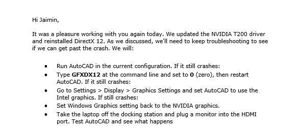

Jaimin Parmar Posted September 5, 2022 Share Posted September 5, 2022 Hello All, I am experiencing a Fatal Error Message from AutoCAD; it just crashes and closes all the files. I have tried guidelines from Autodesk Support and also have tried re-installing the software but it is still there. Appreciate your help Quote Link to comment Share on other sites More sharing options...

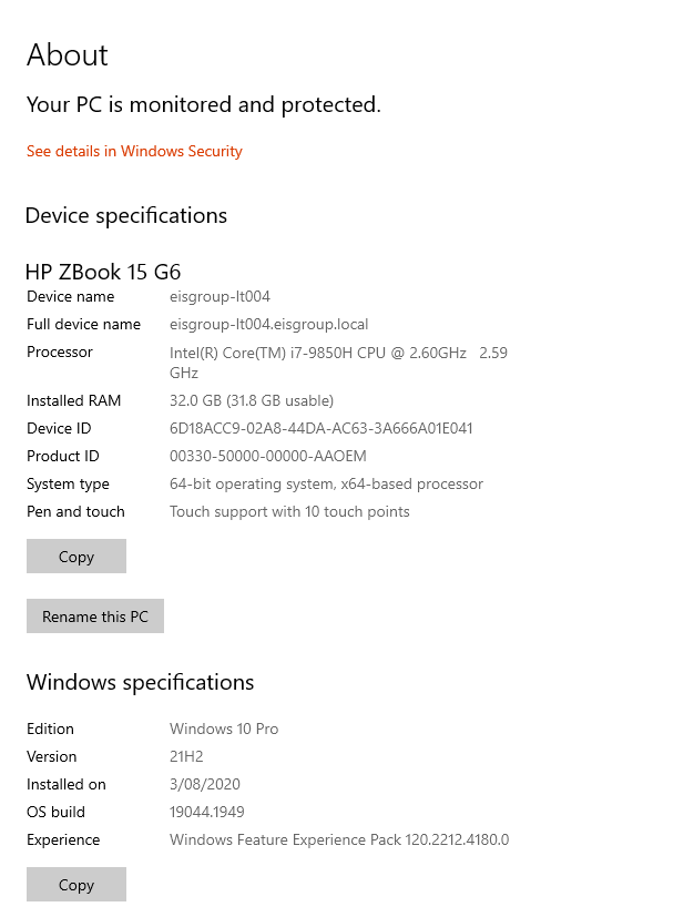

Cad64 Posted September 5, 2022 Share Posted September 5, 2022 Can you provide more information? When you say it "closes all the files", how many files do you have open when it crashes? What exactly does the error message say? Can you post a screenshot? What solutions did Autodesk Support suggest? Does you computer meet or exceed the minimum recommended system specs? Are you working in 2D or 3D? Are you on a PC or a Mac? What operating system are you running? Quote Link to comment Share on other sites More sharing options...

Jaimin Parmar Posted September 6, 2022 Author Share Posted September 6, 2022 1) Around 8-10 files minimum 2) I will try to capture it next time when it crashes it 3) Attached 4) Attached 5) 2d drafting of electrical drawings 6)Attached 7)Attached Quote Link to comment Share on other sites More sharing options...
Jaimin Parmar Posted September 6, 2022 Author Share Posted September 6, 2022 @BIGAL PC Specifications is very strong but it is still crashing I am avoiding going the route of re-installation of the whole windows Quote Link to comment Share on other sites More sharing options...
ReMark Posted September 6, 2022 Share Posted September 6, 2022 (edited) There is no need to reinstall Windows if the only application that is malfunctioning is AutoCAD. It appears, from what you have posted above, to be a problem related to your graphics card. Can you elaborate further? Edited September 6, 2022 by ReMark 1 Quote Link to comment Share on other sites More sharing options...
BIGAL Posted September 7, 2022 Share Posted September 7, 2022 (edited) Maybe check this also How to enable or disable hardware acceleration in AutoCAD | AutoCAD | Autodesk Knowledge Network Edited September 7, 2022 by BIGAL 1 Quote Link to comment Share on other sites More sharing options...
Jaimin Parmar Posted September 8, 2022 Author Share Posted September 8, 2022 (edited) Hi Guys, I have re-installed the AutoCAD and seems like it is not crashing for 2 days. I will update you if a crash happens again. Appreciate your reply guys Edited September 8, 2022 by Jaimin Parmar Quote Link to comment Share on other sites More sharing options...
