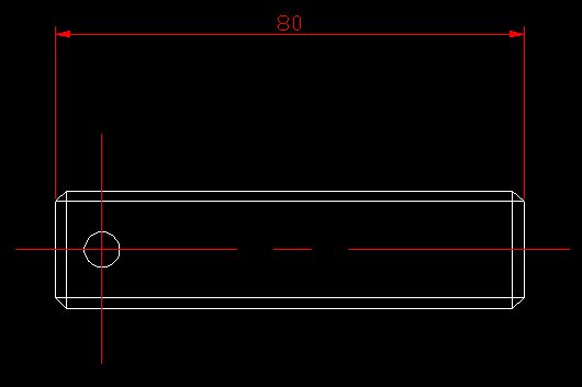

Drawing too long by 40mm
matt4
I need the overall dimensions to be 40mm not 80mm!
Is there a way to chop this down or something? Without having to draw the whole thing again? :(
Thanks,

is it just the length? Do you need ti keep the current width?

ReMark
You could use the STRETCH command to shrink the total length. The command is bi-directional.

ReMark
Faster than a speeding snail.
Matt: Be careful with the STRETCH command. It requires a crossing window be used.

Strix
did you draw it or is it in a drawing you've been given?
if it's in a drawing you've been given, check it isn't a block before you make a start on it :thumbsup:
Left click on it, and if the whole thing goes dotted, it's a block and won't stretch, but there are ways to deal with that if necessary

matt4
Hi,
I think its a scale issue. I have drawn another component and the dimensions should be 45.5mm but are 91mm. So it's doubling up.
The component needs to be twice full size. Whats going wrong? The dimensions need to be correct.

dbroada
are you relying on the dimension to tell you the length or have you tried the DIST command too? If you have just drawn it 80mm long that is what it must be. If that then displays 160 when you dimension it you have a problem with your dimension style.

skipsophrenic
what u got u're units set up to?

matt4
Hi,
The dist command shows this -
Component 1 should be 40mm
Command: dist
Specify first point: Specify second point:
Distance = 80.0024, Angle in XY Plane = 0, Angle from XY Plane = 0
Delta X = 80.0000, Delta Y = 0.6250, Delta Z = 0.0000
and for component 2
Should be 45.5mm
Command: dist
Distance = 91.3189, Angle in XY Plane = 355, Angle from XY Plane = 0
Delta X = 91.0000, Delta Y = -7.6250, Delta Z = 0.0000
What units do you mean?
Thanks :)
Share this post
Link to post
Strix
why does the y have a value if you're only taking a distance for a horizontal component?
is that intentional?
is the UCS skewed?

dbroada
how did you draw it? If I draw a component that is meant to be 40mm long that is what I get.

skipsophrenic
Thanks :)
Type in units and what does the dialogue box come up with?
This is what I've got mine set to
Share this post
Link to post
Dipali
select the whole thing & scale it down by .5 (scale factor)

matt4
The UCS is probably screwed. I don't exactly remember how to edit the UCS.
I drew it using relative coordinates. However the first component wasn't drawn using that method.
Units dialog is below:
If I scale it down to .5 is it still scaled to A4?
