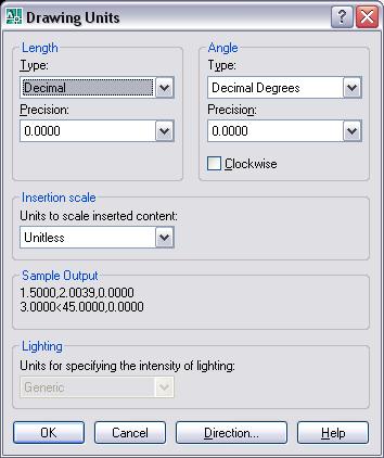

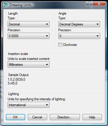

skipsophrenic Posted February 20, 2009 Posted February 20, 2009 Matt, Try a qick redraw of one line with units set to unitless, What happens? Quote
dbroada Posted February 20, 2009 Posted February 20, 2009 I drew it using relative coordinates. However the first component wasn't drawn using that method.Can you explain a bit more clearly how the parts were drawn. I don't understand how you got a part to be too big "using relative coordinates". If I scale it down to .5 is it still scaled to A4? Here might be the problem. The paper size is irrelevant when talking about size. Quote

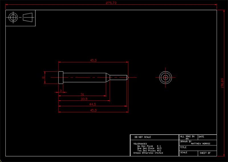

matt4 Posted February 20, 2009 Author Posted February 20, 2009 Matt, Try a qick redraw of one line with units set to unitless, What happens? Same thing Can you explain a bit more clearly how the parts were drawn. I don't understand how you got a part to be too big "using relative coordinates". Here might be the problem. The paper size is irrelevant when talking about size. I used relative coordinates for the component and the whole template was set to a scale of 0.707 for A4 size. I need to have a A4 template as my tutor said. I'm pretty confused on how much more clearly you want me to explain because thats all I used. Just relative coordinates. Thanks for your help Quote

matt4 Posted February 20, 2009 Author Posted February 20, 2009 Model Space Sure... drawing is attached. Please note if you fix the problem on the drawing I can't use it. As its cheating. I am only allowed to ask for help on this assignment not have another person do it for me. Thanks MM_3.dwg Quote

paulmcz Posted February 21, 2009 Posted February 21, 2009 There is no problem to fix in the drawing. I drew 45.5 units long line in your drawing, then I measured it and it was really 45.5 units. If you wanted to draw the part 45.5 units long, how did you manage to make it 91 units long? Quote

dbroada Posted February 21, 2009 Posted February 21, 2009 like strix I can't see your drawing here but I'm still confused about your sizing. When I asked how you drew the thing I was expecting something like. LINE 100,100 @40 COPY @10 Which will give two 40mm long lines, 10mm apart. Without that sort of information I can't guess why it is too big. Anyway, you're in good hands here so I'll drift away. I hope you get it sorted soon. Quote
paulmcz Posted February 21, 2009 Posted February 21, 2009 like strix I can't see your drawing here Can you see it now? Quote
dbroada Posted February 21, 2009 Posted February 21, 2009 just being a little economical with the truth - I can see the drawing but I don't have a means of opening it. However you have confirmed that we don't know what the actual problem is. Your line came out the correct size so where do we go from here? Quote
paulmcz Posted February 21, 2009 Posted February 21, 2009 Without knowing what steps Matt took to draw what he did we can't get anywhere. It would also be good if we know how it should look like (including the title block, scale, etc) when it is all finished. Quote

Strix Posted February 22, 2009 Posted February 22, 2009 okay, okay - we're all being unhelpful - sorry! Matt - press F2 and copy and paste us your command line history (you might have to redraw the thing again to be able to do that after you've closed AutoCAD) - that's what the guys are asking for (and don't worry if you've not been doing the @40 thing either - there's other ways of doing that too, and we can probably talk you through all of those too so you have a MUCH better understanding of this software than your tutor clearly has ) Quote
