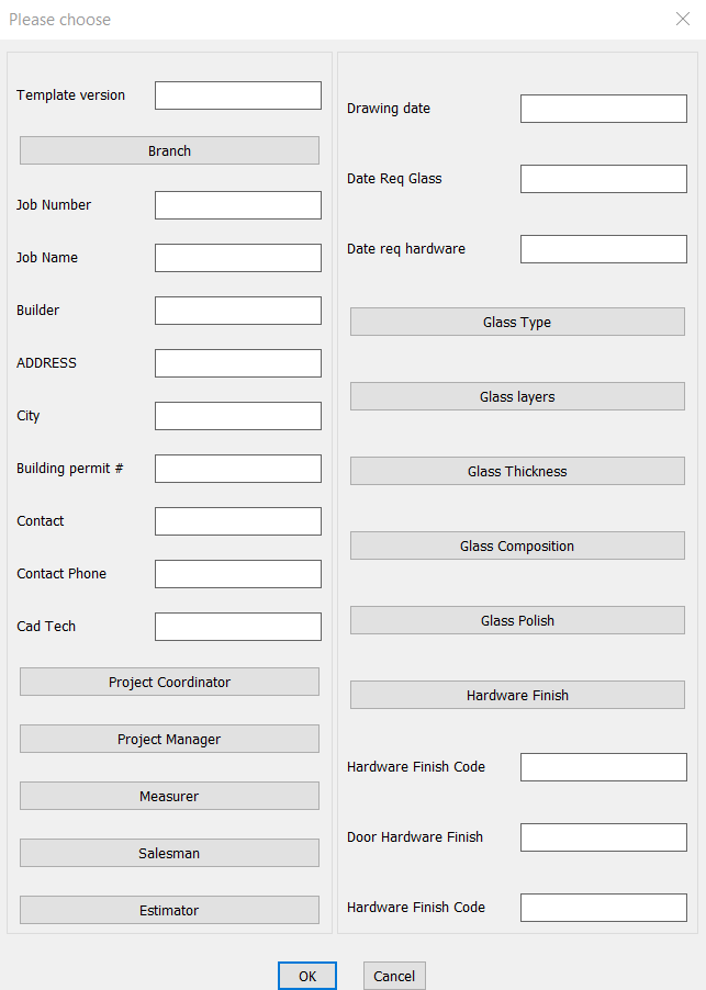

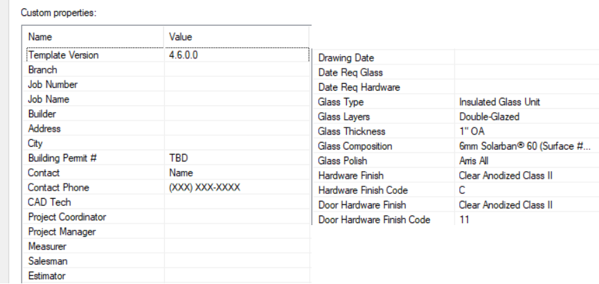

Kyler Posted December 19, 2022 Author Share Posted December 19, 2022 Thank you for the response, sorry for late reply. Work got too busy and I had no time to devote to this. I will look in to creating a DCL and see if I can figure it out. We use dwg props for a number of items, as in my attached image. These would all be filled manually on a per job basis with the exception of "Template version" which is for reference only. Also to be included and filled automatically by the lisp routine would be "Branch address, Branch post code, Branch phone, Branch fax" as selected by radio button. I will play around with the example program you provided and see what I can do when I have some free time. Thanks, Quote Link to comment Share on other sites More sharing options...

BIGAL Posted December 22, 2022 Share Posted December 22, 2022 This is all your values displayed on a screen for input, the next step is to just do the add to Custom properties fairly straight forward. A better way to go though is to change some of the input to a "Button" so when you press a child dcl will pop up and it has default values to choose from. Here is code for the simple version. ; https://www.cadtutor.net/forum/topic/76318-update-field-with-conditional-statement-referencing-dwgprops/#comment-606324 ; Getvals multi allows multiple line inputs ; By Alan H Feb 2019 info@alanh.com.au ; ; code examples ; the input box size can be bigger just change the two values tetsed with 145 145 and worked ok. (defun AH:getvalsm2col (heading dcllst1 dcllst2 / x y num fo fname keynum key_lst v_lst) (setq x 0) (setq y 0) (setq fo (open (setq fname "D:\\acadtemp\\get2col.dcl") "w")) (write-line "ddgetvalAH2col : dialog {" fo) (write-line (strcat " label =" (chr 34) heading (chr 34) " ;") fo) (write-line " : row {" fo) (write-line " : boxed_column {" fo) (write-line " width = 35;" fo) (repeat (/ (- (length dcllst1) 1) 4) (write-line "spacer_1 ;" fo) (write-line ": edit_box {" fo) (setq keynum (strcat "key" (rtos (setq y (+ Y 1)) 2 0))) (write-line (strcat " key = " (chr 34) keynum (chr 34) ";") fo) (write-line (strcat " label = " (chr 34) (nth (+ x 1) dcllst1) (chr 34) ";") fo) (write-line (strcat " edit_width = " (rtos (nth (+ x 2) dcllst1) 2 0) ";") fo) (write-line (strcat " edit_limit = " (rtos (nth (+ x 3) dcllst1) 2 0) ";") fo) (write-line " is_enabled = true ;" fo) (write-line " allow_accept=true ;" fo) (write-line " }" fo) (setq x (+ x 4)) ) (write-line " }" fo) (setq x 0) (write-line " : boxed_column {" fo) (write-line " width =45;" fo) (repeat (/ (- (length dcllst2) 1) 4) (write-line "spacer_1 ;" fo) (write-line ": edit_box {" fo) (setq keynum (strcat "key" (rtos (setq y (+ Y 1)) 2 0))) (write-line (strcat " key = " (chr 34) keynum (chr 34) ";") fo) (write-line (strcat " label = " (chr 34) (nth (+ x 1) dcllst2) (chr 34) ";") fo) (write-line (strcat " edit_width = " (rtos (nth (+ x 2) dcllst2) 2 0) ";") fo) (write-line (strcat " edit_limit = " (rtos (nth (+ x 3) dcllst2) 2 0) ";") fo) (write-line " is_enabled = true ;" fo) (write-line " allow_accept=true ;" fo) (write-line " }" fo) (setq x (+ x 4)) ) (write-line " }" fo) (write-line " }" fo) (write-line "spacer_1 ;" fo) (write-line "ok_cancel;}" fo) (close fo) (setq dcl_id (load_dialog fname)) (if (not (new_dialog "ddgetvalAH2col" dcl_id)) (exit) ) (setq x 0) (setq y 0) (setq v_lst '()) (repeat (/ (- (length dcllst1) 1) 4) (setq keynum (strcat "key" (rtos (setq y (+ Y 1)) 2 0))) (setq key_lst (cons keynum key_lst)) (set_tile keynum (nth (setq x (+ x 4)) dcllst1)) ) (setq x 0) (repeat (/ (- (length dcllst2) 1) 4) (setq keynum (strcat "key" (rtos (setq y (+ Y 1)) 2 0))) (setq key_lst (cons keynum key_lst)) (set_tile keynum (nth (setq x (+ x 4)) dcllst2)) ) (mode_tile "key1" 2) (action_tile "accept" "(mapcar '(lambda (x) (setq v_lst (cons (get_tile x) v_lst))) key_lst)(done_dialog)") (action_tile "cancel" "(done_dialog)") (start_dialog) (unload_dialog dcl_id) ; (vl-file-delete fname) (princ v_lst) ) (setq lst1 (list "Enter values " "Template version" 20 19 "4.1.2.3" "Branch" 20 19 "1" "Job Number" 20 19 "123456" "Job Name" 20 19 "ABCDEFGH" "Builder" 20 19 "BoB" "ADDRESS" 20 19 "x Street" "City" 20 19 "Melbourne" "Building permit #" 20 19 "####" "Contact" 20 19 "Who" "Contact Phone" 20 19 "xxxx xxx xxx" "Cad Tech" 20 19 "me" "Project Coordinator" 20 19 "Big Boss" "Project Manager" 20 19 "BIG BIG Boss" "Measurer" 20 19 "Got Tape" "Salesman" 20 19 "Sales 1" "Estimator" 20 19 "Estimator 1" )) (setq lst2 (list "Enter values " "Drawing date" 20 19 "Today" "Date Req Glass" 20 19 "Tomorrow" "Date req hardware" 20 19 "Day after" "Glass Type" 20 19 "Smoky" "Glass layers" 20 19 "Doubel Glazed" "Glass Thickness" 20 19 "1 inch OA" "Glass Composition" 20 19 "6mm Solarban" "Glass Polish" 20 19 "Arris All" "Hardware Finish" 20 19 "Clear Anodized Class II" "Hardware Finish Code" 20 19 "C" "Door Hardware Finish" 20 19 "Clear Anoized Class II" "Hardware Finish Code" 20 19 "Clear Anoized Class 11" )) (setq ans (AH:getvalsm2col "Please choose" lst1 lst2)) If you want to go down this path let me know, need to know all the child answers eg Glass thickness 1" 2" 3" Glass Finish Smoky Black Clear Blasted Re office once you select that child info the values will be updated in the parent dcl. Quote Link to comment Share on other sites More sharing options...
Kyler Posted January 11, 2023 Author Share Posted January 11, 2023 This is fantastic, thank you! I wasn't expecting anyone to put together this extensive of a prototype for me. The button for Branch selection is awesome! I think buttons for the other options would be a bit overkill though. For glass types and hardware finishes there are far too many options, combinations, paint colours, etc. for it to be feasible to list them all out, and we can usually copy/paste that info from the estimate sheet so text boxes would still work best. Oh also question, Is it possible for text boxes to be autofilled with default values, or is that beyond the capabilities of dcl? Could it maybe autofill from the existing customprops so if the command is run a second time, it will display the currently entered values? Quote Link to comment Share on other sites More sharing options...
BIGAL Posted January 12, 2023 Share Posted January 12, 2023 The 2 column getvals dcl has default values as part of the input. The code I posted above does that just try it when you look at lst1 and lst2, the last value is the defualt value. "Template version" 20 19 "4.1.2.3" "Template version" is the description, the 20 19 is the edit box size , the "4.1.2.3" is default setting. Quote Link to comment Share on other sites More sharing options...
