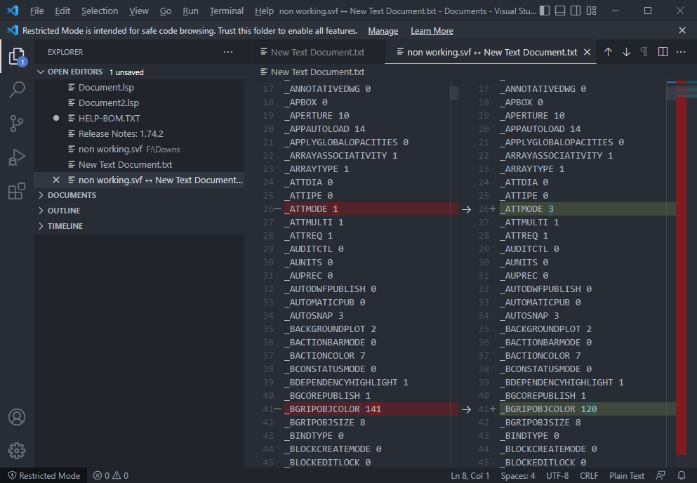

3dwannab Posted December 13, 2022 Share Posted December 13, 2022 (edited) When I have a solid hatch that has transparency and plotting DWG to PDF. The transparent hatch doesn't print. All other hatch types work. Using latest patched 2023 ACAD. See attached the printed pdf, drawing and where I've checked the transparency in the plot dialog. DWG to PDF.pc3 and AutoCAD PDF (High Quality Print).pc3 are both the same. See the error in the publish report where it says: WARNING: Failed to rasterize image for plot. That warning disappears as soon as I change the solid hatch to another type or set the transparency to 0. Look like I'm going to have to have a dense hatch to make it look like a solid hatch. (Not ideal) Transparent Hatch Test.dwg Problem Print.pdf Edited December 13, 2022 by 3dwannab Quote Link to comment Share on other sites More sharing options...

BIGAL Posted December 17, 2022 Share Posted December 17, 2022 If you use Notepad++ it has a compare 2 files function, so do logfileon then setvar ? * etc and dump all variables, Logfileoff. Run again with a pc that works. Can not help much more than that. I can not read Your Zip it says 6.6mb but nothing there ?? Quote Link to comment Share on other sites More sharing options...

3dwannab Posted December 19, 2022 Author Share Posted December 19, 2022 (edited) Strange how you can't see anything when you try download it. Anyway, I've set up two profiles. A default one and the one that I have I have set up to my liking. If I simply switch from the one I use to the default one and then back to the one I've set up the plots work. There's something happening in the meantime. It's not file size as the example I have posted on the first post contains 6 entities. Here's the working .svf file exported (With these variables I can Plot transparency fine). I'll post the non working one once this raises it's ugly head again. working.svf Edited December 19, 2022 by 3dwannab Quote Link to comment Share on other sites More sharing options...
3dwannab Posted December 19, 2022 Author Share Posted December 19, 2022 It's started doing it again so here's the non-working svf file. I've went through the differences and couldn't get it to work. Below is all the variables that are different to the working.svf file above. _ANNOALLVISIBLE _AUPREC _CANNOSCALE _CETRANSPARENCY _CLAYER _CLAYOUT _CTAB _CVPORT _EDGEMODE _GRIDDISPLAY _LASTPOINT _LIMMAX _NAVVCUBEDISPLAY _OSMODE _PLINETYPE _SNAPISOPAIR _TEXTSIZE _TEXTSTYLE _TILEMODE _UNITMODE non working.svf Quote Link to comment Share on other sites More sharing options...
mhupp Posted December 21, 2022 Share Posted December 21, 2022 (edited) https://code.visualstudio.com/ Has a compare mode -Edit also my money is on _CETRANSPARENCY Edited December 21, 2022 by mhupp Quote Link to comment Share on other sites More sharing options...

3dwannab Posted January 10, 2023 Author Share Posted January 10, 2023 Problem is back. The issue isn't what I've said in the post about toggling the plot in background to off. It's down to a corrupt profile. If I reset my profile then it works but it raises its head again after a while. I've never had to issue a bug report before @SLW210 I've tried https://www.autodesk.com/support/contact-support but there are no links to reporting a bug. Quote Link to comment Share on other sites More sharing options...
