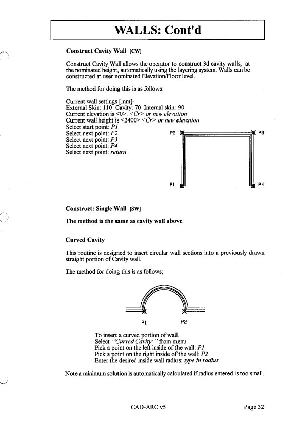

Why not just a help button somewhere this is page 1 of 28 pages a WORD Doc.
Typical page of Cadarc manual. Again 85 pages. Shows how to use it not just load it.
