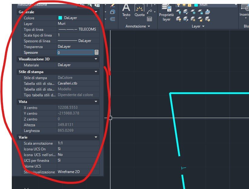

How should I proceed to have more hatches? Where do I load them from? Thank you
I didn't understand how to enlarge the letter, do I need to change the properties? Where is it? Thank you
What we showed you above changes the size of the letters in the line description,
example the lines part ( '-----' ) with a smaller letter will appear longer ( '------------ E ------------ E ----')
change it to a larger letter and the lines will appear to be shorter         ( '----- E ----- E ----').
If you are happy with the proportions lines to text then alter 'Scala tipo di linea' in the properties above
To change the size of the label, change the S (scale) parameter for the text in the linetype file. You will have to reload the linetype in your drawing before you see the change.
It's complicated, but this is from a very early version of the software, and they can't change it.
A,40,-4,["E",STANDARD,S=2.5,R=0.0,X=-1.8,Y=-2.0],-4 so change the 2.5 or as I suggested make a copy with a new name, if you make it big you may need to change say the -4 this is gap distance. For more E's change the 40, make it less, or less make it bigger, we work in metric.
