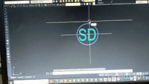

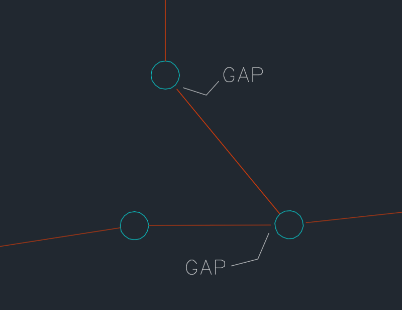

I want to use this lisp to make break inside the circles, but when using the abbs command, there are gaps, and this is because of the rotation. I want to modify the ABBS command so that it has a rotation role, because the blocks have circles.
GAP IN ABBS AUTOBREAK 1.9.dwg
If you saved DWG prior any intervention with blocks as circles and lines going start/end to center of circles, it would be very easy to modify such lines with (polar) function to make lines shorter by radius of circles from both ends and with the same angle lines were before...
Here you are :

Another way if the block is always a circle why not just add a wipeout to the block. Then every time is automatic gap, in BEDIT can save as new name if required, so can have circle or circle with gap you make a polygon say 20 sides then use that to make wipeout. Use draworder also to bring circle to top.
Edited by BIGAL
14 hours ago, BIGAL said:
Another way if the block is always a circle why not just add a wipeout to the block. Then every time is automatic gap, in BEDIT can save as new name if required, so can have circle or circel with gap you make a polygon say 20 sides then use that to make wipeout. Use draworder also to bring circle to top.
That with WIPEOUT may and may not be useful... You pollute DWG with additional entities and it just can't be precise like with my posted code...
Edited by devitg
my fault
I prefer to hide as a gap then the lines are not broken but rather if another step is carried out you still get the true length and the end point co-ordinates. If its a pline ?
Hi Bigal  . as I can see there is a anonymous block , I try to wblock and it only do a new *Ux block , neither I can editblock from the original dwg as Land
Is there any way to do  reverse from anonymous to noanonymous block

  (initget 1 "Yes No")
  (setq ch (getkword "\nDo you want to trim lines after their extensions without gaps [Yes / No] : "))
  (initget 6)
  (setq r (cond ( (getdist "\nPick or specify radius of circles making blocks <0.75> it is needed for lines distances fuzz value : ") ) ( 0.75 ) ))
  (setq fuzz (* r (/ 4.0 3.0)))
  (prompt "\nSelect lines and blocks to extend lines to blocks centers on unlocked Layer(s)...")
  (if (setq ss (ssget "_:L" (list (cons 0 "LINE,INSERT"))))
      (setq ti (car (_vl-times)))
      (sssetfirst nil ss)
      (setq si (ssget "_I" (list (cons 0 "INSERT"))))
      (sssetfirst nil ss)
      (setq sl (ssget "_I" (list (cons 0 "LINE"))))
      (sssetfirst)
      (repeat (setq i (sslength si))
        (setq pl (cons (cdr (assoc 10 (entget (ssname si (setq i (1- i)))))) pl))
      (repeat (setq i (sslength sl))
        (setq speplst (cons (list (cdr (assoc 10 (setq ex (entget (setq en (ssname sl (setq i (1- i)))))))) (cdr (assoc 11 ex))) speplst))
        (setq speneplst (cons (list (caar speplst) en (cadar speplst)) speneplst))
      (setq spepall (apply (function append) speplst))
      (foreach p pl
        (setq spepall (vl-sort spepall (function (lambda ( a b ) (< (distance a p) (distance b p))))))
        (setq pts (vl-remove-if-not (function (lambda ( pp ) (< (distance pp p) fuzz))) spepall))
        (foreach spenep speneplst
          (if (vl-some (function (lambda ( x ) (equal x (car spenep) 1e-6))) pts)
            (entupd (cdr (assoc -1 (entmod (subst (cons 10 p) (assoc 10 (setq ex (entget (cadr spenep)))) ex)))))
          (if (vl-some (function (lambda ( x ) (equal x (caddr spenep) 1e-6))) pts)
            (entupd (cdr (assoc -1 (entmod (subst (cons 11 p) (assoc 11 (setq ex (entget (cadr spenep)))) ex)))))
      (if (= ch "Yes")
          (setq ex (entget en))
          (setq ex (subst (cons 10 (polar (cdr (assoc 10 ex)) (angle (cdr (assoc 10 ex)) (cdr (assoc 11 ex))) r)) (assoc 10 ex) ex))
          (setq ex (subst (cons 11 (polar (cdr (assoc 11 ex)) (angle (cdr (assoc 11 ex)) (cdr (assoc 10 ex))) r)) (assoc 11 ex) ex))
          (entupd (cdr (assoc -1 (entmod ex))))
      (prompt "\nElapsed time : ") (prompt (ftoa (- (car (_vl-times)) ti))) (prompt " milliseconds...")
      (prompt "\nFor UNDO - type \"UNDO\" - \"Back\" option...")
  (*error* nil)
  (initget 6)
      (sssetfirst nil ss)
      (sssetfirst nil ss)
      (sssetfirst)
      (foreach p pl
      (if (= ch "Yes")
  (*error* nil)

Hi Sir @marko_ribar @BIGAL @Tharwat can you please help me to figure out why the Auto Block Break by Sir Lee Mac does not cause the line/plane to break into some blocks? And how can I fix this bug? Thank you. I attached the video and the working drawing for your reference. Thank you
0-02-06-bc1ff0a687c67f7b21b51d1560caa8162ed25219f7c49b1bb6d8216692c2bf4c_90171aa9cca832e3 (1).gif
FOR ABBS.dwg
