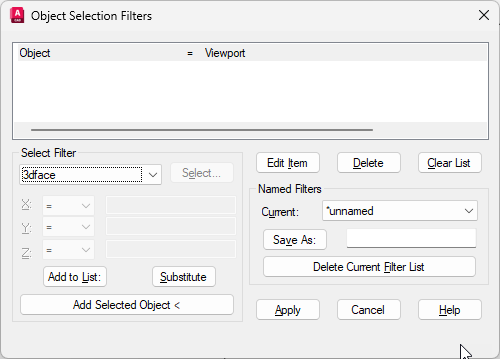

1.is any body know how to turn Display objects in Viewport yes or no in all layouts in one single command or through lisp,

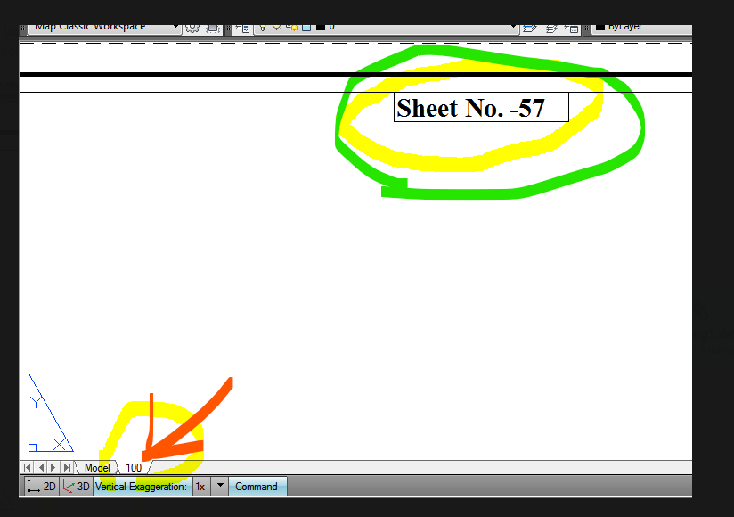

2.after hiding the viewports change the sheet no with reference to layout no dwg and screen shot attached

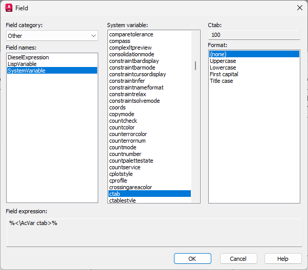

Use a field for your text to match the layout name:
And use the filter command to get all your viewports to turn them on or off in the properties palette.
Or use this code:

For the CTAB, use a Find and Replace and just add the String for CTAB field. (%<\AcVar ctab \f "%tc1">%)
code provided in this link was working on only 1 layout tab and alos please explain find and replace CTAB
I just clicked on the text field then pasted into text what SLW210 posted and the layout name appeared. Copied to another layout to check it was morning.

Again just went to your dwg clicked on the tab 100 then dbl clicked text and pasted (%<\AcVar ctab \f "%tc1">%) do this to your template dwg then its set up forever.
Edited by BIGAL
Sorry to say sir but I am unable to understand can you explain it where and which auto cad command I use because field command not editable I can't change it,
Copy this to clipboard (%<\AcVar ctab \f "%tc1">%)
Open your dwg
Go to layout
Double click text at top
Do CTRL+V the text should change to the name of the layout
Save the drawing as a Template drawing a DWT and use it as your master dwg for your projects.

no actually i want to change sheet not at top middle of the layout sheet
Not sure what you're asking for. The code was based on your sample drawing.
check in bottom actual layout sheet no is 100 but in top it's different that top mentioned sheet no i want to change in one go. in short green text replaced by red text
Edited by pmadhwal7
My code does that? Did you try it?
