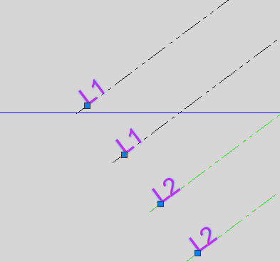

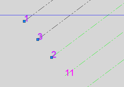

i need some help to adjust the current lsp
wiebe
@wiebe  as you set all numbers insertion points  [ 1 to 11]   at the  line ,
I did the same to the L1 L2 and so on.
As to get  the L1 et all by ssget "F" dxf  10 and dxf 11 from each line , if not there will be a hard way to do such ssget to get the LN.
Or show me how do you put such LN  at  each line.
Seem to be they where put at a equal distance from the each line dxf 10  .
It looks like a 2 step process label the lines by layer, they may be mixed up in drawn order L1, L4, L2, L3.
Then get the lengths etc has been done many times, there is a post at moment floating around that does what you want the missing step which if I get time will be to put a linetype in the table, will find.
The other gotcha for this is if a line is drawn opposite way the label may be upside down and on right side not left side.
For me I would use a ssget "F" option selecting over all the lines near left side so label always go that side.
Answer Devitg questions why I have a hunt.

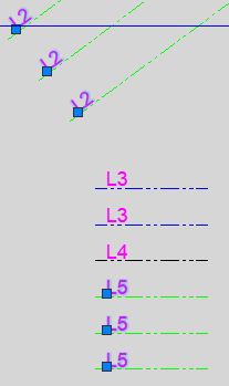

@BIGAL
I found the this F ssget do not select the text
(foreach ent ent@lay-lst
       (setq ent-10 (cdr (assoc 10 (entget ent))))
        (setq ent-11 (cdr (assoc 11 (entget ent))))
     (setq LN   (ssname ( ssget "F" (list ent-11 ent-10) '( ( 0 . "text")))0))
     (setq ln$ (cdr (assoc 1 (entget ln))))
     (setq ln$-list ( cons ln$ ln$-list))
Given ENT@lay-list hold all lines at the same layer but with differents LX
Because the fence do not get any text
1 minute ago, BIGAL said:
Devitg understand but thought it would be better to label lines as part of the program.
@BIGAL That is what the OP lisp do at the before LISP
       (setq ent (nth 0 lst))
      (foreach ent lst
        (setq lenlst (cons (vla-get-length (vlax-ename->vla-object (cadr ent))) lenlst))
        (entmake (list (cons 0 "TEXT")
				(cons 10 (car ent))
			     (cons 40 250)
                       (cons 1 (itoa c))
        (setq c (1- c))
But it name each line from 1 to 11 , that is why I ask to OP to show how it named each line with Lx and Ly

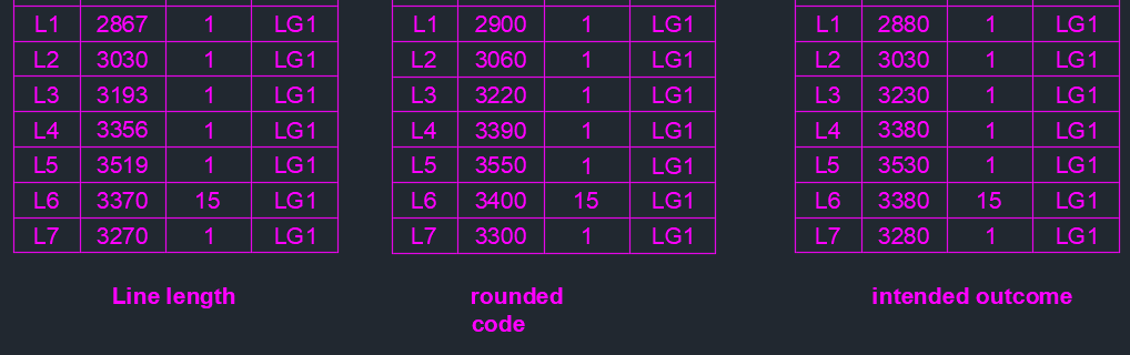

Thanks for your cooperation (Tsuky/BIGAL)😃💪
1 more little question.
how can I have the length sizes rounded to 30 or 80 in the table
example:
line length 1850 becomes 1880
L1 4202 --> 4230
L2 4202 --> 4230
L3 1952 --> 1980
L4 1952 --> 1980
L5 1952 --> 1980
Quote
example:
L1 4202 --> 4230
L2 4202 --> 4230
L3 1952 --> 1980
L4 1952 --> 1980
L5 1952 --> 1980
Perhaps!
Add this function at my lisp
(defun round_number (xr n / )
	(* (fix (atof (rtos (* xr n) 2 0))) (/ 1.0 n))
And change the line
      el (list (vla-get-length obj) (vla-get-layer obj))
To this
      el (list (round_number (+ (vla-get-length obj) 30) 0.1) (vla-get-layer obj))

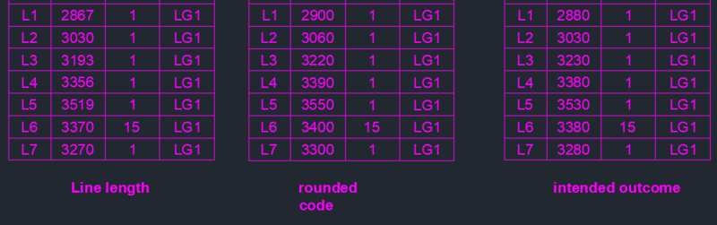

Tsuky,
code does not give the desired result:
line length 2867 -
rounded code 2900 -
wish outcome 2880
line length 3193 -
rounded code 3220 -
wish outcome 3230
etc.
The rounding will need a less than 30 for the last 2 digits then do similar for less than 100 need to think about it in a cond.
1224 divide 100 = 12.24 - fix = .24 less than 0.30 so it is changed to (0.30 + fix ) * 100 = 1230
Edited by BIGAL
Sorry, but your term:
Quote
Misled me, this term would have been more accurate:
Quote
how can i have the length sizes in the range at 30 or 80 in the table.
BIGAL is right in his reasoning.😉
Here is the corresponding code (to be checked anyway; tested summarily)
(defun range_number (x / )
  (cond
    ((and
      (<= (- x (* 100 (fix (* 0.01 (fix x))))) 30)
      (not (> (- x (* 100 (fix (* 0.01 (fix x))))) 80))
      (+ (* 100 (fix (* 0.01 (fix x)))) 30)
    (T
      (if (< (+ (* 100 (fix (* 0.01 (fix x)))) 80) x)
        (+ (* 100 (fix (* 0.01 (fix x)))) 130)
