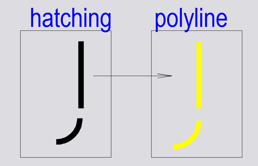

Convert Hatching to Polyline

; Extract hatch outlines from straight feature or elbow feature
; used in structural member systems, trays, piping, ducts, etc.,
; then estimate their width, and add up the lengths.

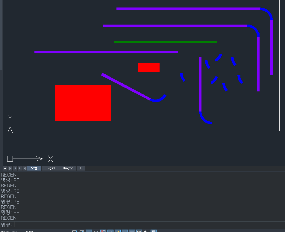

Because drawing the center line requires more time, I first calculated the length as an outline.
This routine guesses the width of the selected solid hatchs,
calculates the length by subtracting the width twice from the length of the OUTLINE and then dividing by 2. this is the centerline length. normally (normal means Unless there is a tee with more than 3 exits or a cross with 4 exits.)
This is a mathematical problem rather than a programming(coding) problem. So you too can participate.
Since the problem is how to derive the general formula for the center line using only the OUTLINE coordinate list (X Y X Y X Y X Y...)
Edited by exceed

The image shows what I need, the hatches are converted into polylines, but unfortunately your
program creates only the outlines of the hatches for me.
"Select Hatches :
Select objects: Opposite corner: found: 32
Select objects:
Error: error Automation. Ambiguous conclusion"
Hatching - pline.dwg
Edited by Nikon
13 minutes ago, Nikon said:
exceed, thank you for your participation
"Select Hatches :
Select objects:
The sample drawing also works well in my situation (zwcad).
zwcad has fewer functions than autocad, so there are usually no problems running it on autocad.
This difference usually occurs in lines that start with (vl-cmdf~ or (command~~
You can try running overkill or pedit in autocad and change the (vl-cmdf or (command~~ order accordingly.
This is a version that requires manual overkill and pedit.
The center line is also drawn with this. but 2lines

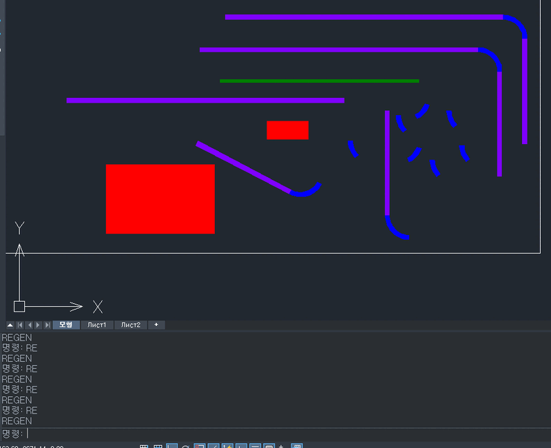

This difference usually occurs in lines that start with (command~~
Вы можете попробовать запустить overkill или pedit в autocad и соответствующим образом изменить порядок (command~~).
I'm sorry, but it doesn't work ...
On some straight sections, the middle line appears in the form of a line ...
Please help me adapt it to AutoCAD.
Edited by Nikon
exceed, You've done a great job. Your work is very valuable...
Lisp is loading successfully, but
Command: ; error: invalid argument type: VLA-OBJECT nil
Edited by Nikon
I think you are confusing potential helpers by using the term hatch. I think you mean an outline that appears to be of a previous polyline with width and you would desire to have it as the single polyline with width.
Are you wanting to change a closed polyline to a single polyline with width?
You need to find the center between and add the width to the polyline.
This LISP I have not tested, but seems closer to what you might need, at least for a start.
Centerline to a Closed Polyline LISP Question - Autodesk Community - AutoCAD
SLW210, no it is not necessary.
HCEN Lisp converts hatches into polylines of the same width and length in the zwcad program.
This is what I need, but unfortunately my AutoCAD 2015 rus does not work,
and I do not know what needs to be fixed to work...
Edited by Nikon

20 hours ago, Nikon said:
I need to replace the hatching with a polyline with the same width and length.
Creating borders for hatching is not a problem...
Now I am asking for help to adapt HCEN lisp for AutoCAD...
This routine has been tested on AutoCAD 2023.

Edited by exceed
add 2 user input option
@exceed, thank. You have helped me a lot!
Now polylines are created on top of the hatches.
Now the work will go faster ...
Good luck to you!
Edited by Nikon
Exceed's is working here, doesn't delete the hatches.
I use this to remove all hatches in a drawing.

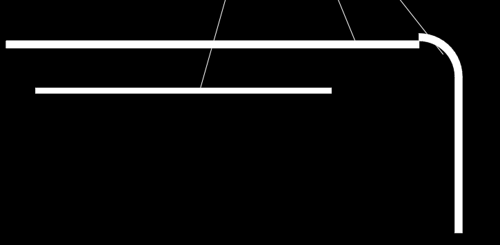

Steven P I get the arc offset.
(defun c:DeHatch (/)
    (if (setq h (ssget "_X" '((0 . "HATCH"))))
        (repeat (setq a (sslength h)) (entdel (ssname h (setq a (1- a)))))
Thanks, I'll have a look and see what I did wrong - looks like it is offsetting outwards and not inwards - and the line going down too, the same thing (they are still joined 'after')
