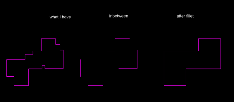

Hello everyone,
I'm dealing with polylines with a lot of unnecessary steps, and normally i need to delete manually these edges.
The goal is to have a lisp code that delete these edges, if the step value is 1.5mm.
I tried PLDiet lisp code but the resulting pline cannot have diagonal lines, only horizontal or vertical.
How can I proceed to solve this issue? Is already any code available for that?
Thanks in advance for your tips! :)
(PS: see attached file with an example).

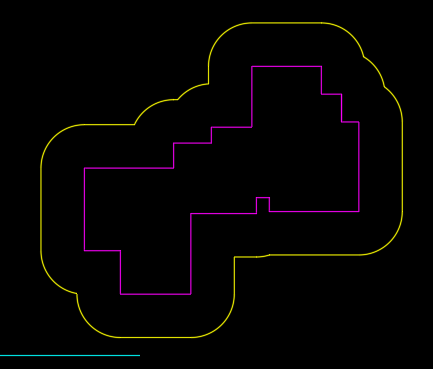

Here's an approach that might have some potential although there are a few coding challenges.
Using offset, create an offset shape 1.5 mm outside the original shape.
Delete all the fillets and replace them with chamfers. Note that if a fillet arc is not between a vertical and horizontal line then both the arc and the line "inside" should be deleted.
Chamfer the resulting lines.
Now construct an offset curve of 1.5 inside this shape.
Replace the arcs with fillets and you have the desired end product!

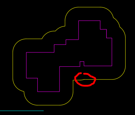

The most challenging coding part of this approach is determining which line segments should be deleted after the initial offset shape (i.e., the inside lines).
That is a hard shape to change, explode, fillet and erase comes to mind as 1st answer.
Ok 2nd answer select pline segments in sequence, no arcs, then make a new pline from new line segments.
So try this. Just pick segments press enter to stop picking it will close automatically. You must pick in order.

if it is sharp, that part can be omitted.
-> sharp means If there is a line segment that protrudes to the outermost edge with a value smaller than the entered value of 1.5
This is because the two neighboring points of this sharp point are
located in a direction where the area is smaller than the original outline.
In that case, the original point should be included in the comparison to find the one with the largest area among the 3 cases.
If the original wins, this case is difficult,
picked line segment is not modified, but both neighboring points need to be modified.
It is difficult to solve this problem by simply running a forward loop.
Even after modifying the neighboring points on both sides, need to check whether the rules are correct
retrieve the coordinate list again, and the node numbers may also be messed up.
Of course, this may be difficult only for me.
Because there are many smart people.
so I created a routine to create a new line above it. not modifying original line.
It would be better to check manually.
Edited by exceed
  • Like 2
  • 2 weeks later...
Thanks a lot @exceed! Its really what I was looking for.
Sorry for late response, I was on holidays 😅
Your code works for most of the cases I have. Only one issue that i found out.
If the first point of the output has different x and y coordinates comparing to the last one, the last segment that joins both points will have diagonal orientation.
There is a way to make sure that all segments in the end are either horizontal or vertical? Usually i have almost an hundred of lines to change.
Thanks in advance :)
(See .dwg bellow with examples of shapes that have one diagonal segment after running de code)
example.dwg
@exceed
