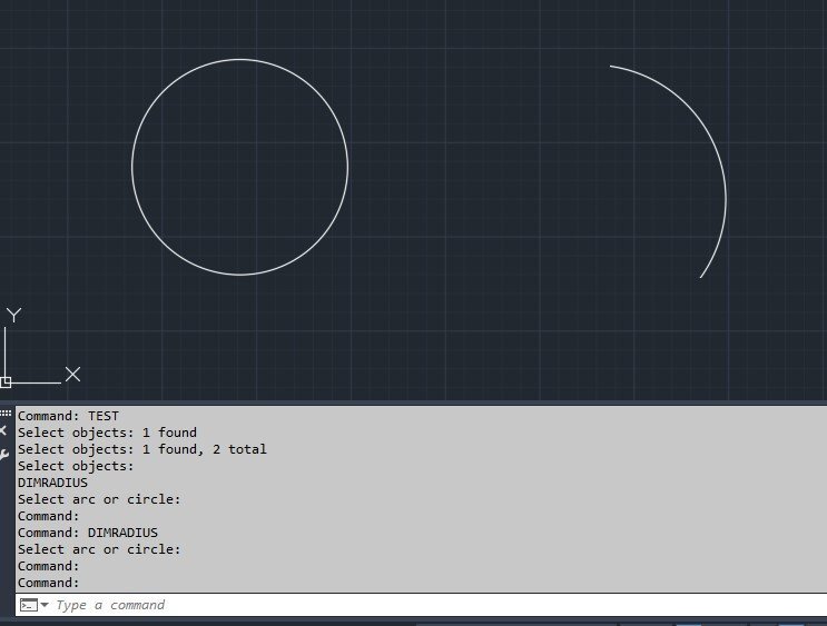

Nikon Posted November 19, 2023 Share Posted November 19, 2023 Circles and arcs exist. Select all and get the radius of all in one time... The result is as in the picture posted 11. Quote Link to comment Share on other sites More sharing options...

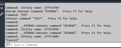

m.alshboul Posted November 19, 2023 Author Share Posted November 19, 2023 not work Quote Link to comment Share on other sites More sharing options...

m.alshboul Posted November 19, 2023 Author Share Posted November 19, 2023 I have AutoCAD 2024, i don't know what I will do Quote Link to comment Share on other sites More sharing options...
Nikon Posted November 19, 2023 Share Posted November 19, 2023 (edited) In AutoCAD, create a radius. At the command prompt, type r (Radius) See in the command line how the Radius command is displayed, copy and paste into lisp instead of "_.DIMRAD" (perhaps "DIMRADIUS") (defun c:test ( / i s e ) (if (setq s (ssget '((0 . "CIRCLE,ARC")))) (repeat (setq i (sslength s)) (setq e (ssname s (setq i (1- i)))) (vl-cmdf "DIMRADIUS" e (vlax-curve-getpointatdist e (/ (vlax-curve-getdistatparam e (vlax-curve-getendparam e)) 2.0))) ) ) (princ) ) Edited November 19, 2023 by Nikon Quote Link to comment Share on other sites More sharing options...
m.alshboul Posted November 19, 2023 Author Share Posted November 19, 2023 even this not work Quote Link to comment Share on other sites More sharing options...
Nikon Posted November 19, 2023 Share Posted November 19, 2023 have you tried with this? "_dimradius" (defun c:test ( / i s e ) (if (setq s (ssget '((0 . "CIRCLE,ARC")))) (repeat (setq i (sslength s)) (setq e (ssname s (setq i (1- i)))) (vl-cmdf "_dimradius" e (vlax-curve-getpointatdist e (/ (vlax-curve-getdistatparam e (vlax-curve-getendparam e)) 2.0))) ) ) (princ) ) Quote Link to comment Share on other sites More sharing options...
m.alshboul Posted November 19, 2023 Author Share Posted November 19, 2023 I bothered you with me, I'm really sorry but this doesn't work Quote Link to comment Share on other sites More sharing options...
Nikon Posted November 19, 2023 Share Posted November 19, 2023 I have AutoCAD 2015 at home, tomorrow at work I will try it in AutoCAD 2020... Or someone else will tell you... 1 Quote Link to comment Share on other sites More sharing options...
