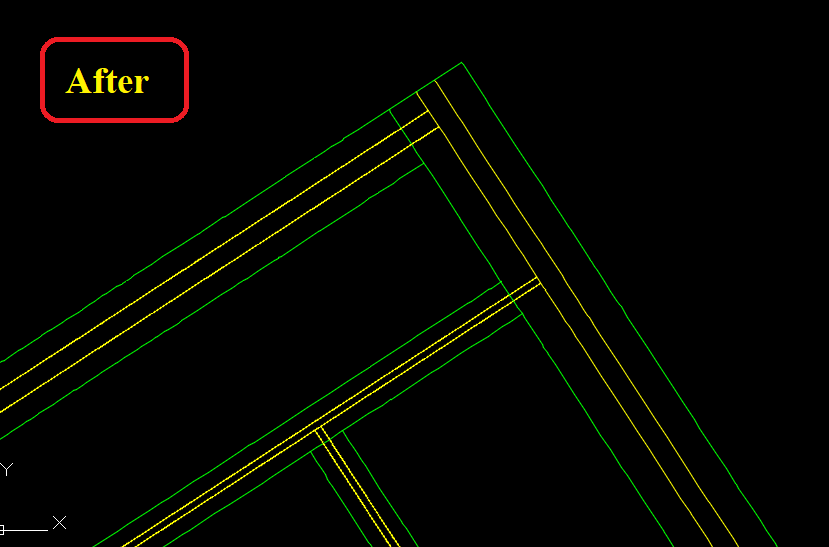

Please I Need Lisp To Extend Selected Polylines To The First Intersection Only
When I Select All Yellow Polylines, Extend Till Intersect With The 1st Yellow Polyline Then Stop
Sample.dwg
I succeeded in creating Lisp 90% Perfect  ...
Can anyone optimize it for not looping all the polylines but only polylines within 50m from the polyline start point.

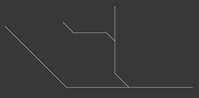

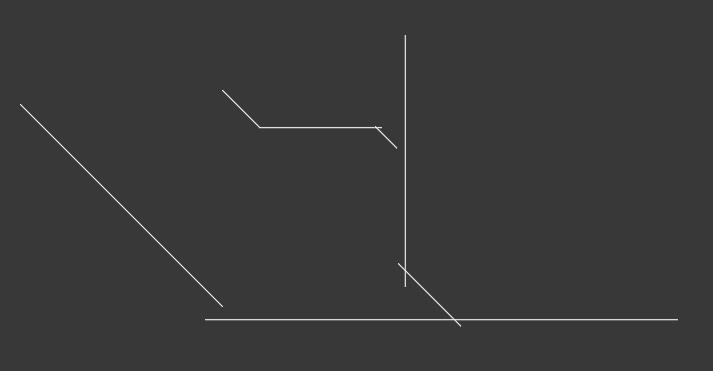

This was something that I also challenged myself to do. Though not perfect, the purpose of this program was to "neaten" Revit exported or similar pipelines so that they are all "filleted" and "trimmed" cleanly so that it works with my other commands that I've created.
I don't know how useful this will be, but if it doesn't suit your requirements, I'll give another crack at it.
You will probably just have to select the lines separately (the yellow and green lines).
Neaten.lsp
@Jonathan Handojo
I don't know how to thank 😍 you for your help, The lisp is working very fast and Perfect 💯 🌹🌹
Thanks Again ❤️
17 hours ago, Engineer_Yasser said:
@Jonathan Handojo
Thanks Again ❤️
No worries. Glad it worked.
While you're at it, try this one, to remove all those annoying vertices. It's quite satisfying to see it
RXV.lsp
  • Thanks 1
I appreciate your help .. This lisp makes the drawing much better  😍🌹
