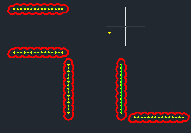

Hi all,
It's been a while since I'm asking for help, but I hope that you can once again lend your wisdom to my problem. There's probably a solution out there already, but I'm not too sure as to where to find them.
Attached in this dwg is a visual representation of what I'm trying to achieve. I don't really need the full program, but there's a specific goal I'm trying to achieve and I'm on my wits' end trying to figure this out.
Let's assume that the dwg file itself is a list, and the yellow blocks are all 3D points within that list. What I would like to find out is how to "group" this list of points into a group of points as shown by the red cloud.
Here's the criteria:
  • Any points that are alone and not within close proximity to another point will be left out.
  • Visually you will be able to distinguish the group. Each group will clearly be distinct from another in terms of distance. The "maximum" and "minimum" distance between each one is arbitrary.
Hopefully there's solutions out there already. Even a small start such as a function that can return this group of points from the full list will be more than beneficial for me and I can take care of the rest.
Thanks.

Wow, MR, works a treat! That variable gg is exactly what I needed. Thanks a lot for the help.
Maybe the reason I was struggling is because I wanted the program to be able to "detect" the distance without prompting the user. But I suppose that might be slightly out of reach.
Anyway, thanks again for this Marko.

My application isn't about using cables filling into a conduit but using quick channels to support pex piping. As you can probably tell from the name of the block, I'm using quick clips to support the pex itself, but the clips themselves will also need to be supported to the soffit. Since they're exposed, the client wants them looking neat and pleasing to the eye. As such, their solution was to use the quick channels. So, I need to find out how many cuts are required.
Though, that must have been a lot of effort that you have put into your code. Well done.

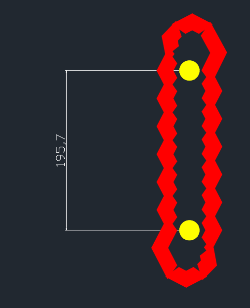

I used a KD-Tree, it suffers from the same issue in that you have to enter a magic number
and if the number is big enough to fit the issue above, the corners fail. I asked my daughter to write a machine leaning
algorithm lol.
Now that you mention it, it's similar to that of the K Mean Clustering. Yea, my logic won't really need to go that far, but what Marko coded up will work just fine for me right now.

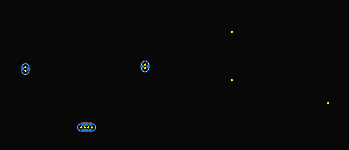

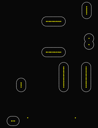

Yeah, you're not wrong, I need the single ones left out.
Easy enough and this version creates individual regions :)

8 hours ago, Danielm103 said:
Re foo: what about this one... edit, still ronjonp idea is brilliant
Just up the size of the radius .. here's 150.
does 150 break the corners?  Edit: Just something I noticed, my routine doesn’t handle that edge case either :)
Edited by Danielm103
I would call that better grouping if one tolerance is used :)
