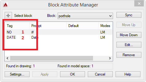

is there anyone who can help me? I need autolisp code with a function to fill in attribute values based on the block name.
For example, I have an object block with the name A and an object attribute,
when I run the autolisp command, I select the object with the name A and I click on the object attribute so that the attribute value contains the name of the object block A.
is this possible to create by autolisp? Thank you

this is almost what I need. but what I need is something like I have 1 object block with name A and 1 object attribute
and when I run the autolisp command, I select the block object with the name A and I click on the object attribute so that the attribute value contains the block name of object A.

@Kvlar
What do you get when you pick an attribute with this syntax :
(cdr (assoc 2 (entget (car (nentsel)))))
You should get TAGNAME of your attribute...

What code do I need to enter to get the TagName?

I apologize in advance, I don't understand the syntax. I'm still a beginner at this.
What I want to get after selecting the attribute is that the attribute value will contain the name of the object block that I previously selected.

"Sorry got caught up in something. select the block then select the attribute "text" you want to update."
Just select attribute ! As mentioned using nentsel this can return the tag name, then use (ssget pt) where pt is the (cadr (nentsel)) then (ssname ss 0)
(setq ent (nentsel "\nPick an attribute "))
(setq pt (cadr ent))
(setq tagname (cdr (assoc 2 (entget (car ent)))))

error: bad argument type: VLA-OBJECT <Entity name: 181bbe5aaf0>
Is there anything I did wrong?
But, thank you for helping me
