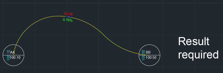

Good day, I found such a LISP (from Mr. PBEJSE), it is very useful, who can help me make some additions?
The command writes the slope and distance between two selected objects with different elevations.
These are what I want. Let each added object have its own different layer. Also slope, distance and arrow be in blocks.
Thanks for help.

Good day Mr pBe, yes I added the sample dwg file here.
Whatever you think about Block is possible. Let slope, distance and arrow all be compact.
Also It makes the process like a straight line in curves. How to find a solution for this?

I think these might be handy
Poly2Chords will take a polyline and straighten curved segments into straight lines / chords

Mr. Steven P,
Thanks for interesting, unfortunately this LISP for different situation. I have added a dwg file please see attached HotOffThePress _ rev2.dwg
HotOffTheGrill _ rev2.dwg

15 minutes ago, macros55 said:
@macros55 so the lisp shall select whatever is between the 2 points or insert.  And neither you need to make such curve .  just in case there is nothing between the select point or insert , make a straight line .
 If direction is straight I agree with you but direction is not always straight, sometimes curve, spline or pllne
@macros55, at your first dwg there was not a straight line.
This? With only your exemple... for start!

Mr Tsuky, Thank you very much for your interest, could you please make some arrangements?
