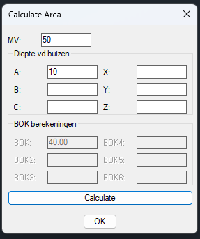

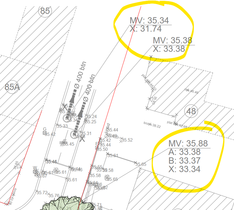

I want to change the values of a dynamic block within a lisp. This lisp contains a calculation. I used .dcl for this.
My dynamic block has 7 attributes: maaiveld, HOOGTE1, HOOGTE2, HOOGTE3, HOOGTE4, HOOGTE5 and HOOGTE6.
My lisp code has 7 values: m, a, b, c, x, y and z
The order of these outputs are important. a, b, and c are sewer pipes that arrive in the cewer, and x, y, and z are pipes that depart from the sewer pit. So if there are only 2 pipes, we only have to use a and x.
This makes it difficult. I can't just set HOOGTE1 to a, HOOGTE2 to b, HOOGTE3 to c, etc. If I do it this way, it will leave a gap in my leader.
I hope this is even possible. I provided some screenshots of my calculator and of the leader, and the problem of the gap. Maybe I just need to create a more complex dynamic block, so that I can just connect the hoogte1,2,3,... to a,b,c,... I really don't know.

The code needs work to be visually better, but I want it to work before I do that.

I'am a intern civil designer so I'am using Civil 3D but our surveyors still use Autocad. I was tasked with recreating a leader that is used to display sewer measurements. They normally use there calculator to get the measurements but there where some mistakes in the past.
Lee Mac is also the reason that I started to look into Lisp coding. But I'am still new at this. I find it hard to understand every line of my own code but I'am figuring things out on my own pace.
My end goal is to put all the outcomes into my dynamic leader. The problem iam having is the order of the 6 possible outcomes. a,b,c and x,y,z. Not all sewer pits are the same. sometimes u have 2 incoming pipes and 1 outgoing so that means the leader only needs A B and X.
but sometimes there is only 1 outgoing pipe so the leader only contains X.
If I only have X as outcome It would need to go to the top of the leader in the attribute 'HOOGTE1'
if I have A B and X in my calculation:
  • A goes to the top of the leader  =  'HOOGTE1'
  • B goes to under A  =  'HOOGTE2'
  • X goes to the bottom  =  'HOOGTE3'
So sometimes X is on top but I'ts also possible that X is on the bottom in 'HOOGTE6' and I dont know if I can create this.
I hope I made some kind of sense. But I think u know my problem.
